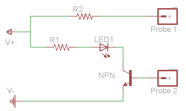

  10. SnipeHunter
    I believe only one person did it, or had a system setup to do it, before it got outlawed but yeah using it to accelerate faster was the idea. This was 20+ years ago.
    As for speed traps, I've built a few...it's really not that hard.
    1. The Sun can be really freakin bright which can cause problems and washout your signal if you dont account for it.
    2. People's INABILITY to drive in a straight line and/or through a "narrow" (3-4 ft across) gap a few feet from shore is....?impressive? ​
    Otherwise it works pretty darn well.
    Something like this:
    The two probes (Probe 1 and Probe 2) can be pretty much anything that conducts well, i'd stick with brass/bronze/copper soldered to the wire. One of the probes goes in the water channel the other is set the the height that you want the circuit to activate when water reaches.
    The rest of the parts could all easily be found at Radio Shack if that was still a thing or you have someplace like that. (Micro Center or a local Mom&Pop type spot)
    For the NPN transistor, pretty much any old NPN transistor will work, if you're just lighting up an LED you dont need much current even.
    I use these: https://www.mouser.com/ProductDetail/863-MMBT3904LT1G
    But this would work fine and easier to connect: https://www.mouser.com/ProductDetail/onsemi-Fairchild/BC33725BU?qs=LU5rZWrBGo0gUheVwmNJVQ==
    The resistor (R1) and LED (LED1) can be a million different combinations, it's no different than hooking up an LED anywhere else. The resistor limits the current so you don't burn up the LED or Transistor; for a 5v supply voltage and run of the mill LED I'd grab for a resistor in the 470Ω to 1kΩ range, the exact value isn't too critical. You're just using the NPN Transistor as a switch to turn on the LED and letting the water in the ship flick the switch for you. Put the LED somewhere you can see it and Bob's your uncle.
    diceman42 and JustinScott like this.

    Good stuff here! What would you change, if I wanted the pump motor to be automatic?
    diceman42 likes this.
  12. SnipeHunter
    Doh, I wasn't paying attention last night when I drew that up, here is the right circuit.
    I also added another resistor (R2) to this one, it isn't required, but it helps protect the transistor if the two probes touch or are conducting through something other than water. (value isn't super critical, something around 1k Ω should be fine)

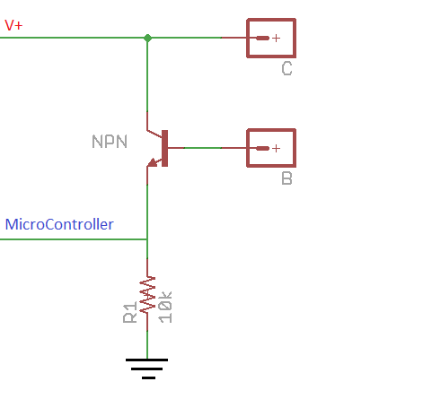

    If you wanted to control a pump with this there are a few ways to go about that and it can depend on the pump motor you want to control, here are a couple that I've used.
    1. Brushed Motor - Replace the NPN with an some sort of FET (like a MOSFET or IGBT) that can handle high power loads, may need to use the NPN to trigger the FET. The Motor would go in parallel with the Resistor/LED or between the V+ and FET (Assuming an N-Channel FET which are better suited for this than P-Channel FETs) if using the NPN to trigger it) Unless there is a specific reason why you need to use a FET I personally don't think its worth the hassle.
    2. Brushed Motor - Replace (or run in parallel) R1&LED with a Relay (Mechanical, sure you could use a solid state but you dont really get much for the money and at the power loads typical of pumps mechanical just does better). Tons of different relays to choose from. My personal favorite is the American Zettler AZ2100-1A-5DE, it works on a 5V control signal, can handle up to 40Amps, and is Epoxy Sealed from the factory so water doesn't get inside and corrode the working bits. they have a long history of use in the hobby and perform great. They come in other control voltages as well if needed.
    3. Brushless OR Brushed Motor - A bit more involved. Brushless motors need a fancier control scheme than Brushed motors so they are a little harder to use, but this can really work for either. Pull out a microcontroller, modify the above circuit just a tad to feed a micro-controller:
    Then use the micro-controller to generate a control signal for the brushless pump esc. (This is what my auto-pump boards do, they allow for manual control for both OFF and ON as well as a setting to allow the watersensor/microcontroller to control the pump(AUTO), your radio needs a 3 position switch or some fancy mixing but gives the best of both automatic and manual control.) The control signal could go to a brushed ESC or relay type board for a brushed pump or integrate the relay on with the microcontroller for a brushed pump. Lots of ways to skin the cat. ​
    Probably a few other ways, like using a 555-timer to create a control signal for an ESC or whatever else you can think of but I've done it using all three of these methods. Generally speaking I don't think the first one is worthwhile, maybe if you were super constrained on space or something but it just seems like extra hassle when a sealed relay is so easy, cheaper, and IMO more reliable.
