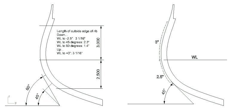

    How about "The penetrable area shall be 3" above the waterline to 2.5" below the waterline (or 45 degree turn of the hull), measured along the outside contour of the rib." Some of us need a little margin to sheet, covering a 6" hole with a 6" piece of balsa just isn't going to happen for me.
    On the left In the picture below you can see how a center rib of the USS Constitution would fall under the various proposals. On the right side is a graphic to depict my suggestion.

  5. mike5334
    Much easier to see a visual of it. Nicely done.
    While I worded it poorly (and didn't mention space to glue to), my intent was basically 'a window no taller than a 6" piece would fit (centered on the waterline), minus an eighth or quarter inch top and bottom to glue the balsa to'. My concern is that with 3" above and 2.5" below, and the curvature, that leaves precious little solid area to glue the balsa to.
