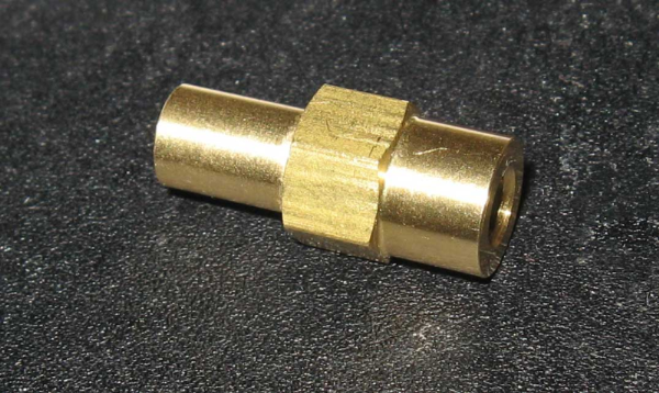

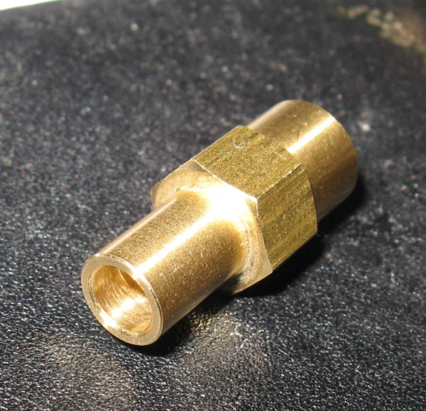

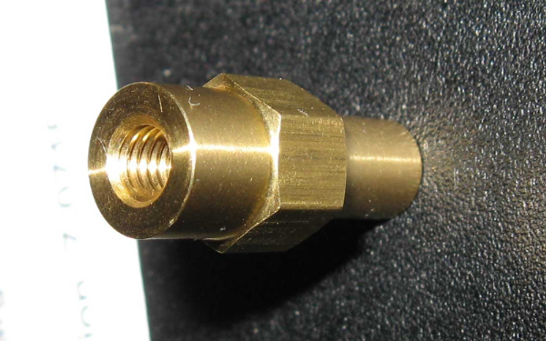

    I am still trying to figure out what to do with these, as I have about 100 of them...
    They have a 10-32 thread at one end and the other end is a crimp connection for what appears to be 8 gauge... I am considering putting these into a hull as electrical tie in points for bussing... or maybe using them on cables...
    Not sure what else, but I figured I'd see if anyone else had any ideas...
    Are you sure that those are for crimping? They look like brass... Then again, you have them in front of you, and I don't :)
  3. Bob
    Leaving exsposed wiring (copper or brass or anything else) in your ship is an invite for a short, lots of melted wires and the end of your battling day. Cover your wiring with heat shrink. Never used crimp on connections as they corrode and don't work after a year or two.
  4. GregMcFadden
    Yep. they are for crimping... although they would solder just fine. I just am not sure what to use them for... (if nothing, off to the scrapper they go)
    I've seen the corrosion issues, and shorting is more of an issue with not having internal metal tied down... unless you are in salt water. But the real question... what could these be used for?
  5. SnipeHunter
    Pass through on a watertight box?
    I don't think water getting into the wiring is a problem for those of us battling in freshwater :) I mean, really, with a ship under 5 feet of water, I daresay that there is no ship in the hobby that has watertight wiring.
  7. rarena
    Bottom of gun interupters??? 10/32nd could be air in, other side to fit in cap.

    I'm thinking about using them as deck tiedowns or epoxying them into hulls as a built in tieoff point, or something like that...
    Still considering..

    If you are using brass/copper accumulators, they would be great for the hose fittings. 10-32 is the thread used for clippard minimatics isn't it?
  12. GregMcFadden
    actually, yes it is. it would be a small accumulator though... unless I am missing something
  13. DarrenScott
    I meant that you could solder them into the end of your acummulator/expansion tank, and have a good looking, strong fitting instead of just tapping a hole in the thin metal. (I'm assuming the hole goes right thru). You may even be able to flare them a bit before you fit the tank end, for greater strength.
  14. GregMcFadden
    ahh, yes that would be a good use...

    I was also thinking - drill a hole in your accumulator tanks, insert and solder. If you just need a small local volume tank, see if the appropriate sized K&S brass tubing will fit over it and solder.
    A fitrting for interrupter guns, as mentioned, might also be a very good use, depending on the OD of the smooth-bore part. Or the breech for a single-shot torp gun, if it happens to be 1/4"

    Yes, fitting for copper expansion tanks! I have been making similar for years. the Hex part gives you a good solder connection to the copper walls. I have been turning down brass rod to get a shoulder for the same reason and tapping with 10-32 tap to fit most of clippard fittings.

    the od of the narrow section is 0.270...

    Sounds like an easy single shot torp breech, then (add a sleeve/barrel, a magnet to the outside to hold the round, call it done). Or, going the other way, a single-shot BB-canon breech. Or part of the interrupter for an interrupter breech cannon. Or the end fitting for an accumulator. Literally tons of uses.
