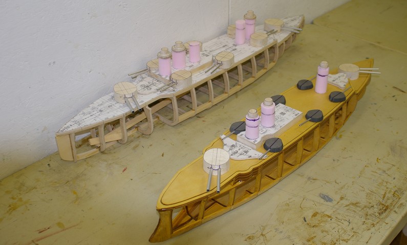

    I have started making superstructure templates for the French pre-dreads.
    It looks like some of the stuff is the same for the Dantons, and the Liberte class.
    And I am guessing that these parts might also work on some of the other Frenchies as well.
    I will post some photos later this week.

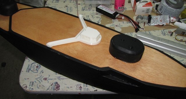

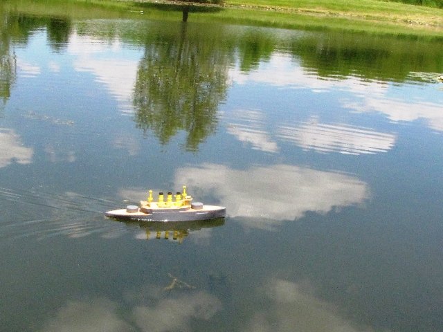

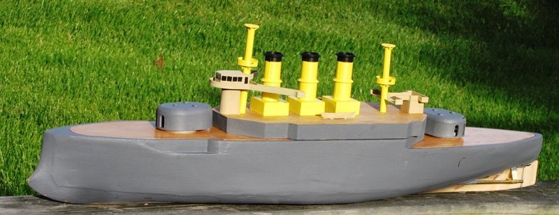

    The Potemkin is sheeted and it will see sea trials this weekend. It might even battle!
    I'm very pleased with how the deckhouse turned out, although I'm going to have to reprint it since it lifted a little.

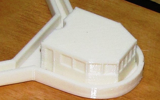

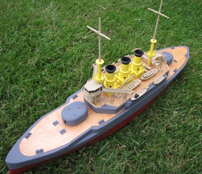

    I made more progress on the cosmetic stuff. Turrets are way oversized and will have to be redone. I redid the observation deck with a thinner 0.05" thick splinter shield and it looks much better. The smoke stacks are 4 pieces, the bottom cylinder, top cylinder, and two hoods. I printed the cylinders as a single wall spiral vase, so they were very quick to print. A BB will blow through them, so I'll reprint them when I have the time.
    It did get on the water today. I lost a prop shaft early in the testing, so I was unable to play with it much.

    One trick for splinter shields is to make them like 1/4" thick at the base, then thinning to whatever you like at the top edge, it gives the illusion of scale thickness from 5-10 feet away.

    I went slightly mad with the printer last week and added plenty of pretty bits to be shot away. My favorite is the steam launch.
    As promised, here's the files for those that would like to print their own parts.
    Details on the different parts can be found here.
