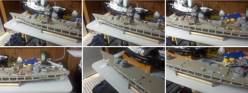

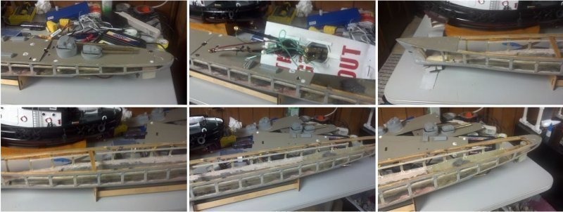

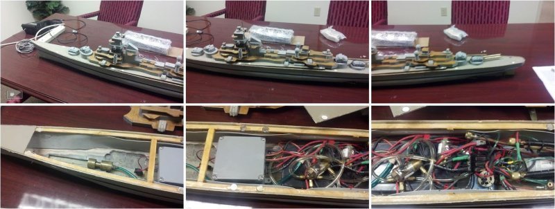

    Here is what we have to start with on this build
    Number one requirement is reliability, and judging from these pics we have a little work to do. The original list still applies in this case if we want a good outing for this ship.
    Boat came with an SLA, he has his own batteries (has been sailing ships for years) so we are good with power. Staying with brushed motors and 550's, so no new tech (future upgrade possibly). Will keep the shaft and prop combo (another area for future upgrade- could go with a bigger prop). Same with the rudder (better shape/placement).
    Going to remove the majority of the water channeling, not needed in a cruiser other than a few key areas. If you are fighting this cruiser in a regular fast gun battle, you should not be taking a ton of damage (unless you lose power). Batteries will be placed in the hull with Velcro - simple and effective.
    Looks like we need a hold down for the bottle as well. Will do a bracket to elevate the bottle (to help prevent freezing) and use Velcro straps.
    One area that is throwing me off is the barbets, they look over sized in relation to the turrets. Or it could be the turrets are undersized.
    I like to use a WTC for my electronics, suggestions on a box for this ship? I was thinking a pelican box (I think a 1010).

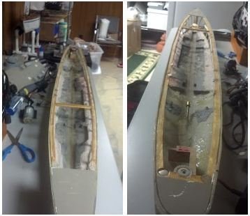

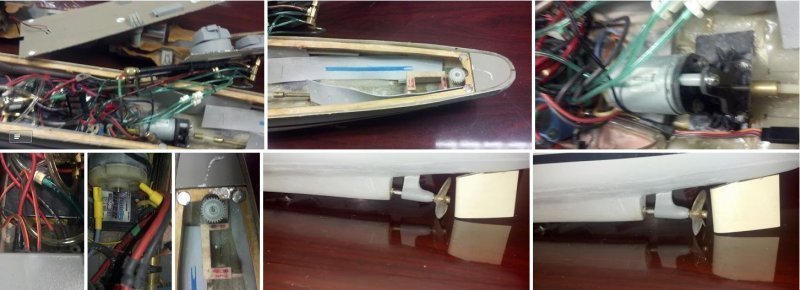

  9. Lou
    Stripped:
  10. Tugboat
    Wow, that's a long-lookoing driveshaft. Might be the camera angle.

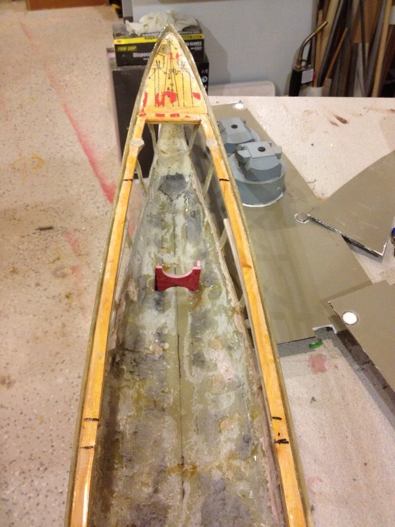

  14. Lou
    Support rails added to the bottle holder, this view is from the bow looking aft. All sub deck has been removed. The stringer is balsa that was never epoxied, that will have to wait for another refit.
    Time to make the aft deck step, this helps in stopping water from passing the pump and rushing to the aft part of the ship. This "Knuckle" causes the water to pool near the pump.

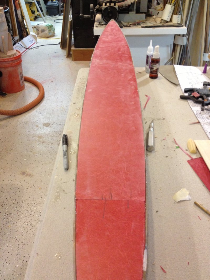

  17. Lou
    Dry fit of the deck
    Cutting out the rails
    One section in (stern)
    All sections in, epoxy and filler used to fill the gap.
    Internal bow blast shield in place.

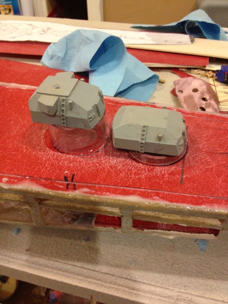

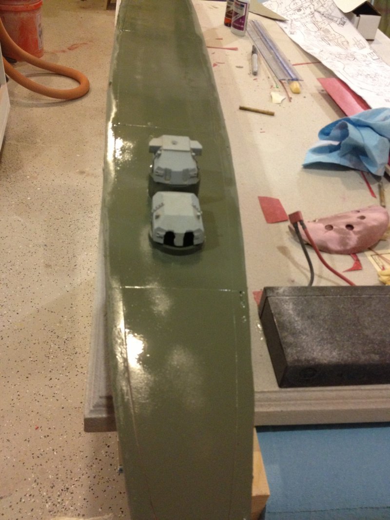

    Cut the barbets and installed them to the deck. Will dremel out the inside and reinforce with epoxy and fiberglass cloth. The material is Lexan, should hold up just fine to BB hits.
    Deck sanded and a primer coat freshly sprayed to see the defects.

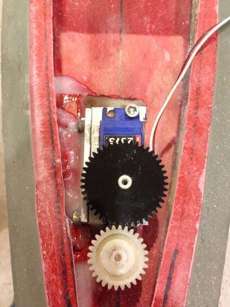

    Rudder post re-installed, new servo holder made with aluminum angle and the gears mesh perfectly.
