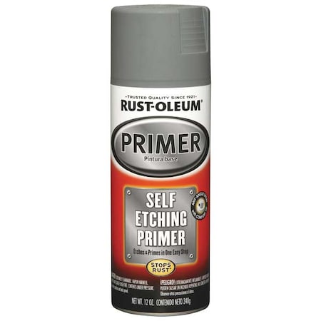

    Stuck this scale feature back on. Lets see how many battles till it gets blown off.
    Also started painting the SS and deck then I realized I didn't sand the deck first. Latex paint does not stick to this red FG sheet without first sanding it, so off comes the paint.

  14. Lou
    yep, sanding is a must with the FG sheets. I find this primer to help with adhesion
