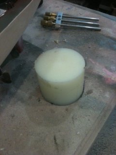

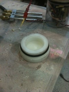

    Built the new endcap for the water tight cylinder (WTC). Start with a 3 inch block of plastic.
    Cut the length on the bandsaw. Then turn it on the lathe to get it to fit inside the lexan tube. Had to grind a tool blank to get the profile shape of the gasket, have to take a lot of measurements to get it right or the gasket will not seat. Removed some of the interior so that I could save room.

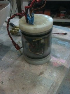

    This is the completed WTC. 4 firing boards and a big relay for the pump, powering the receiver with a Castle BEC. My issue is that the diameter is 3 inches, just too big for the way this boat was designed. But, this is my backup as I try to make a new 2 inch WTC. I would like to use the relay David R found (and thanks David on the instructions), the firing boards from Johnny, and my new receiver.

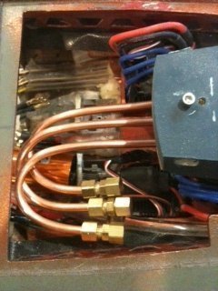

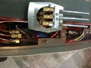

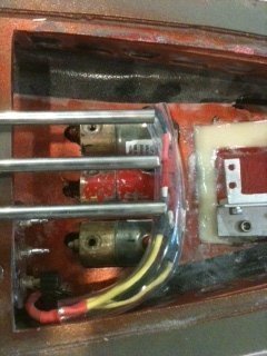

    Wiring is done for the solenoids and test switches, you can just see the switches underneath the rightmost barrel. All the wiring is in a tube to keep it clean looking.

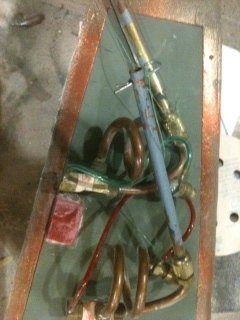

    Magazines are done, just need to brace them and adjust the angle so the feed is good. Still need to add tubing. Hardest part was getting the uptube and interrupters to fit with the correct angle.
    The benefit of the clamshell deck, I only need to remove one side to access the magazines or test switches, and as the guns are part of the boat and not deck, my range will stay dialed in. Magnets hold down the deck.

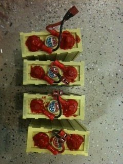

    Not a lot of time to work on the boat last night, but I did get the batteries wired.

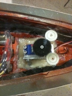

    Used 1/8th angle for the servo mount, very solid and no movement possible. Mount is epoxied into place.

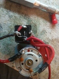

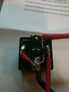

    I believe I wired the relay correctly, but wanted to post a pic and get confirmation before I hook up the pump.
    Top wire is the positive, jumper connected to the negative, and the diode is attached. The red wire on the right side going down is for the board.
  17. djranier
    Nope I just looked over what I typed, and the diode needs to go across the windings, not the switch, sorry about that. Move the diode from 87 to 85, with the band facing the board. Should be 85. You can move the other end from 30 to 86, but since they are shorted together, it does not matter either way.
  18. Lou
    Thanks Dave! I moved the diode and just left the one end as-is.
    Underneath the red wires you can just make out the pump holder, this slides over a pole and is help in place by a set screw. The relay is sitting on an extension of this hold down, makes it easy to take the whole unit out for maintenance.
