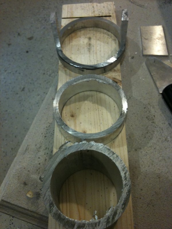

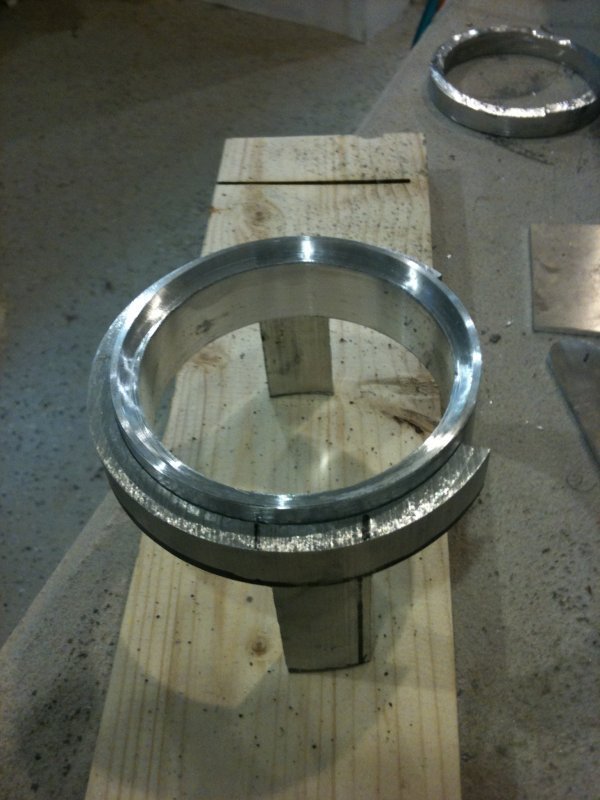

    Started the cuts to the pipes, the idea is the large pipe will be a "sleeve" that stays with the deck, and the rotate assembly slides into it and is held in place with a couple of screws. Servo, magazine, and gun will all be inside the turret, so it should make it easier to trouble shoot at lake side.
    The largest pipe is the sleeve, in this shot you can see the excess has been cut away to form the legs, a bar will go across them and create the bottom of the support for the turret (sleeve is upside down in this photo). Still have to make a cut to the ring to remove the tight fit and allow the unit to slide in without a ton of force. The walls of the pipe are 1/4 inch, so they are very robust! The cuts were made using a band saw with metal blade (wish I had a metal bandsaw, but a good one is out of my price range). Each pipe was cut out at a specific length, so when assembled they are the correct height.
    Next step is to put the second pipe on the lathe and create the chase for the ball bearings. Then you have to flip that piece over and create another chase for the retention pieces so that if the hull flips, all the ball bearings don't fall out.

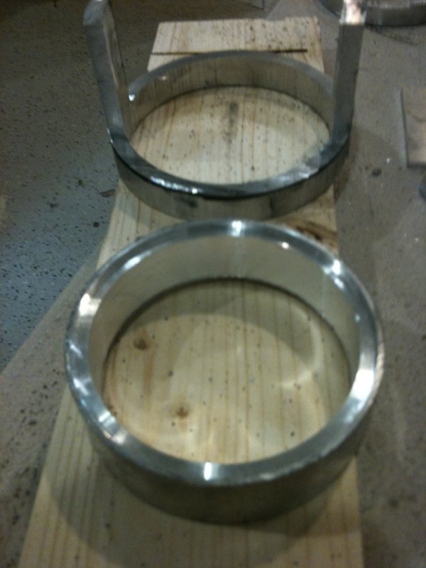

  6. Lou
    Here's the latest update, the chase has been made for the bearings to ride in. The sidewall of the turret will form the other side of the chase. The wall should be thick enough to prevent damage from a BB hit.

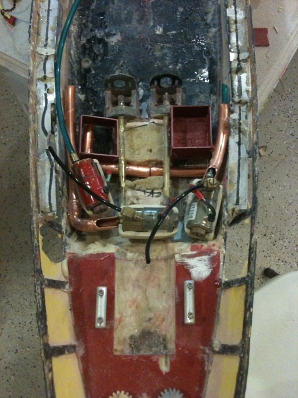

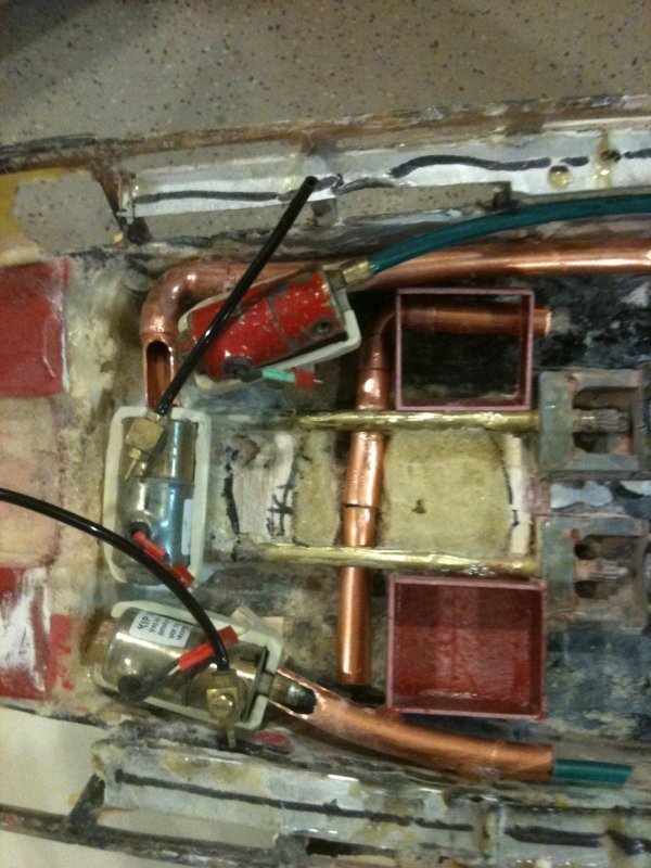

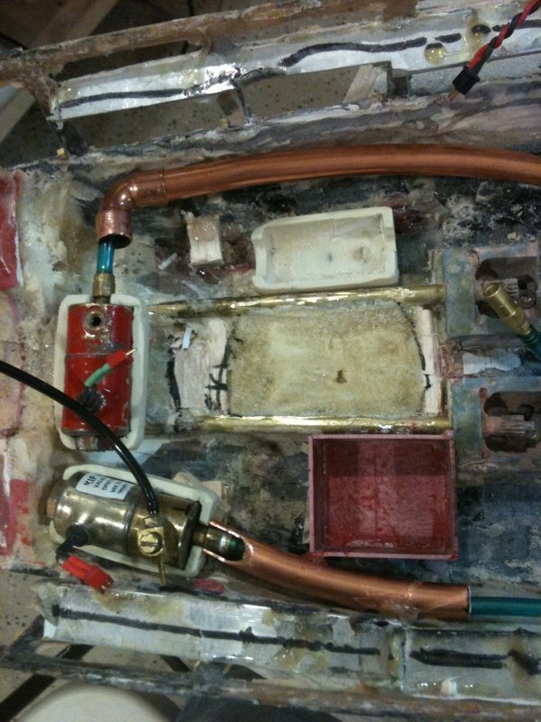

    Did some more work last night on the stern area, realized that my setup was not going to work for the hose routing and where the speed control boxes need to be placed.
    So I had to cut new pipe (3/8 inch copper) and try a few new areas to mount the solenoids. The box on the left is just a left over that is being used for placement testing.
    Decided to run the electrical wire for the ESC's under the prop shafts, had to really press on the pipe to get it to fit. Have decided now to cut the bottom of the boat and install from that side. I will also have a T fitting so the motor wires can go between the mounts. This will all be accessible with a cover plate.

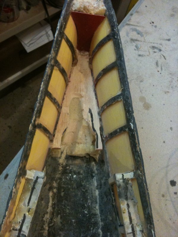

    Looking at the bow area the balsa blocks and foam have to go so that a new bottle holder and water channeling can be placed in there.

    Outer turret sleeve added to the holder (this will be under the deck). The holder has had the ring cut, this allows the sleeve to slide in and still support the assembly.
