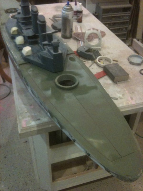

    Filled the edges and primed the deck. Still more work to do.

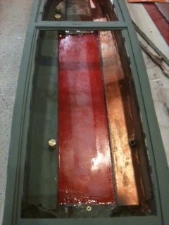

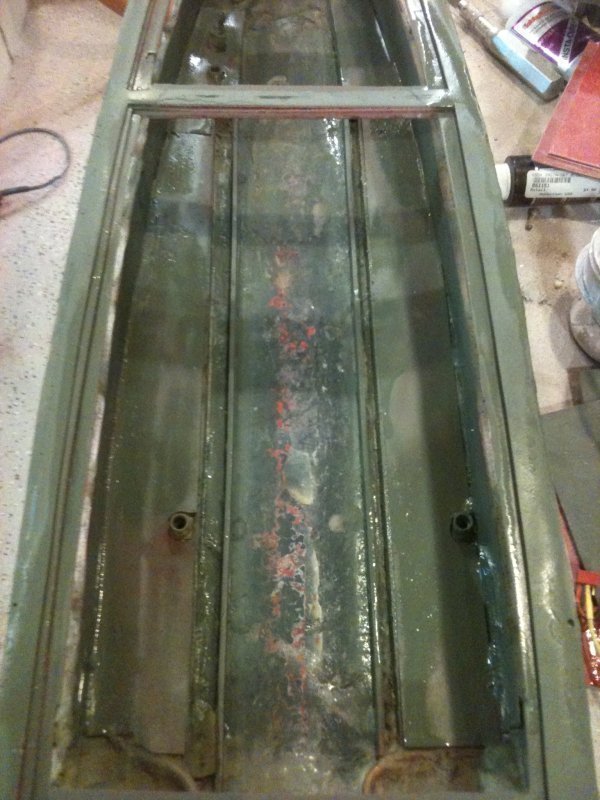

  5. Lou

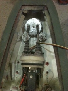

    Finished the middle water channeling, lines are buried for the gas and side walls are now on the boat. Used west system epoxy and micro balloons to fill in the gaps between the side walls and around the gas ports. The two small channels are for main wiring and servo wires, these will get their own covers to match the completed channeling. The green paint is self-etching primer, this is great on fiberglass and aluminum. Still have to make small access ports so I can get to the bulkheads, but that might come after the brew. Now it's time to work on the wiring and getting the rotates setup in the bow.
  6. Lou
    Working on the new rudder setup, lets try a smaller picture and see if that uploads a little better.

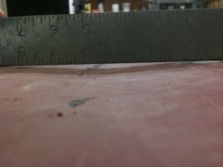

    Any idea how to correct, should I even bother (looks like 1/4 inch)
  8. Lou
    That is the bottom of the hull, appears to be "hogging". I can either cut it out and install a flat sheet of fiberglass (lot of labor), or is there a way to pull it down?
  9. SnipeHunter
    Bondo and sand it flat?
  10. Lou
    The issue is inside the boat you have a crown, so the water is not going to the middle of the water channeling.
    More work but I could cut out the middle and graft a new piece underneath, but this is more work and possible more weight.
    If I took screws and went through the middle, I can get the hull back into shape. But how do I keep it there, I cannot run formers across the channel (would impede water flow).
    If its a non issue, then I wont worry about it.
  11. rarena
    leave it. I have some of that in all the hulls I have.
    Unless it bothers you, it is overkill afterall!

  14. Lou
    Well, I cut out the bottom and used 1/8th fiberglass sheet.attached it to the hull with West System adhesive.
    Glued and in place. Once this dried I flipped the hull, sanded and used west system again this time with filler (balloons) to ease the sanding process.
  15. Lou
    From Mike:
    By the way, I like the rudder install. It looks compact.
    Thanks Mike, not enought time to get the tube to work correctly, so I am going with the waterproof servo and standard set of gears this year.

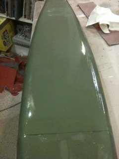

  16. Lou
    Bottom is sanded and primed, took some time but the results are worth it. Only 30 days to finish this boat...
