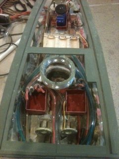

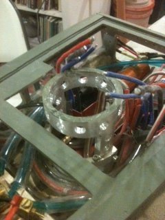

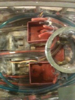

    One of the copper tubes was bent and there was no easy access to to repair, so this was a chance to use flexible tubes. Not fun doing this type of rework so close to the battle, but necessary. Had to cut the bottom (the grey area) so that I could get to all the copper tubes.
    Tubes installed
    Wires are installed so that the walls don't deform when adding the foam.
    Stern gun holder, holes are to lighten weight. The assembly connects to the hull with two screws, so the entire assembly can lift out.
    Glued the rail that will hold the blast sheild fabric (tent material).

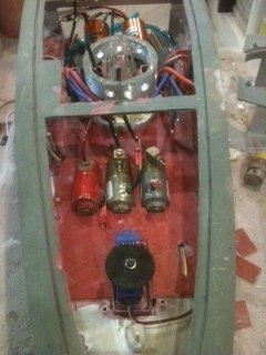

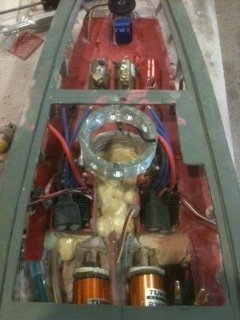

    Finished the new stern layout, wire are run as well as gun tubes. Still have to mount the test switches and get everything wired together. The foam under the guns will be trimmed once the guns get in place and I have an idea on how much clearance is needed.

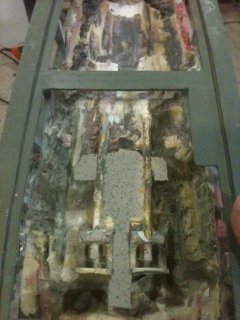

    I love that foam. I did my bow, using the poured foam for the first time, and love it. Just pour, cut, sand, epoxy, sand, thin fiberglass mat, epoxy... smooooth...
    I will do the same in the stern as you did but will epoxy it each night until its done.
    Lou it looks like we will both be running down to the wire here!
  17. Lou
    I am using the smooth on product, a 10 times expanding foam. Then I take a bandfile and quickly shave off the height, place a straight edge from side to side to make sure it is level. Then use 1/32 inch fiberglass sheets from McMaster to get a smooth finish on the top, attaching it with west system mixed with adhesive promotor (sp?). By changing from copper tubes I was able to save a pound, which is not much but important for me in finding the center of the ship. With everything in place I was a little stern heavy and didn't want to move the batteries forward to counter balance.
