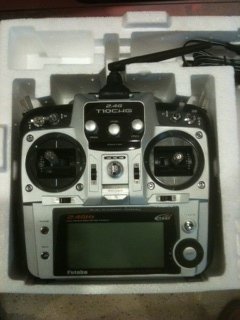

    New radio, a futaba 10 channel. Would like to convert to push button, but probably not enough time before the battle.

    Not sure if it'll work with the newest Futaba radios, but Futaba has a large circular servo wheel that is the perfect size to click into the gimble bezel. Saves a lot of time trying to cut and shape a piece of wood to fit, and it is waerproof to boot. :)

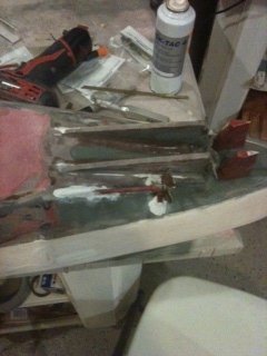

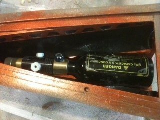

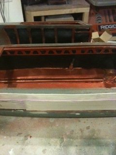

    Got the armor installed and started the sheeting process. The material is tent fabric that is hung from the suppurt using superglue in every third opening. In this photo you can see the gas caps are tapped with 10/32 fittings installed.

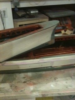

    The bow section is sanded, the pink stuff is lightweight filler.
    Esc's are wired and the pump outlet is in place. Armor is in, now just have to sheet it.

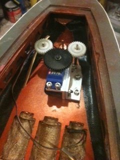

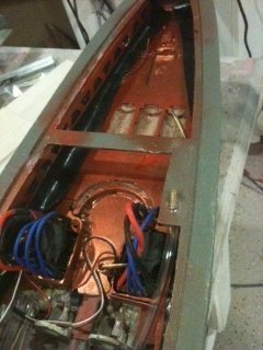

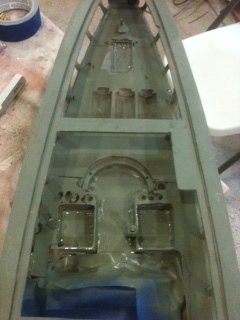

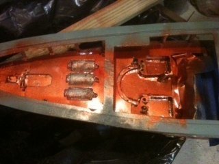

    Putting on the drag disks, the copper tubing is secured through the hull. Skegs are done.

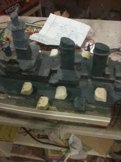

    Cast all the 5 inch turrets, still need to make the bases and attach to the deck. In this shot you can see the balsa has been applied and sanded, just need to silkspan and paint.
    Trying a rudder mount I saw on one of David R's builds, two pieces of angle make for a quick removal if necessary. What I didn't count on was a solid base (there is foam underneath the thin fiberglass plate), so I have too much flex. The plan is to remove this section and put in a plate underneath, then this angle can be secured to it.
    I am really fighting the urge to tear out the rudder posts and rebuild using a cross brace to tie the two rudder posts and the servo together for a perfect mesh.

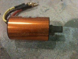

    To those that are running these motors, when I was test fitting my motor last night with the standard large BC gear (that comes with the gear box) and the meshing seemed a little "harsh". Am I using the right gear?

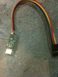

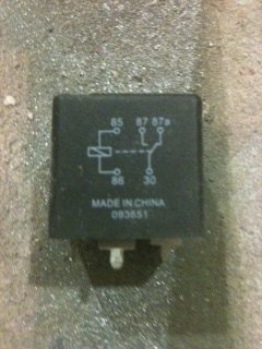

    Got this from David R, it a sealed relay for the pump. Anyone comment on how to hook this up to a pump (I am electrically challenged). I wanted to use this to keep the size of the electronic box small. I assume using a team delta board is need to trigger the relay.
    Got the new boards from Johnny (AKA Lurch) :laugh:
    These should save space in the box. Now I just need to hook them up. As this is my weakest point of the build, I am trying to get everything else done before Sunday so I can concentrate on electronics.

    I didn't have any problems with gear mesh. The 48 pitch pinions from the r/c crawler web sites mesh withthe 48 pitch spurs provided in the BC gearboxes.

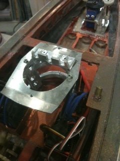

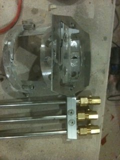

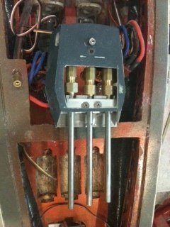

    She now has some teeth. Took a lot longer than what I originally planned, was trying for a solid platform but able to quickly disassemble the guns if needed. The final version is number 5, settled with a bracket holder that fits behind the gun clamp. Drilled and tapped to the aluminum base using flush mounting stainless steel socket screws.
    Little distortion from the camera, but the gun bracket is straight and true. Thanks to Brian for the material of choice, 1/2 X 1/4 aluminum bar stock. Tapped around the center gun, then set on its side and drilled the three holes. Will put a small piece of electrical tape around the barrels to act as a gasket and firmly hold the barrels, no slipping.
    Will rebuild the front of the turret now that the guns are mounted. The top will have a removable panel so I can tweak on the water and not have to worry about the turret. The rest of the guns are built thanks to a great build session with Mike Mangus last weekend.

    Run positive battery power to one side of the pump motor, other side of motor to 87 on the relay. 30 is the negative battery return. Add a 18 or 20 gauge wire jumper from 86 to 30, This way you will only need one battery return. You will also need to solder a 1N4001 type of diode across the relay from 87 to 30, with the band on the 87 side.
    The Team Delta firing board has power going to the positive input from the battery, closest to the edge of the board, with the negativewire attached to 85 on the relay.
    If the motor runs backwards, you will have to swap the leads on the motor itself, not the power leads going to the assembly, since the diode only works one way, same as the TD board.
    We found Dons gears were a little harsh also, I think the gear material itself is very hard. We ran his for a bit, and it was getting quieter the longer we ran them.
