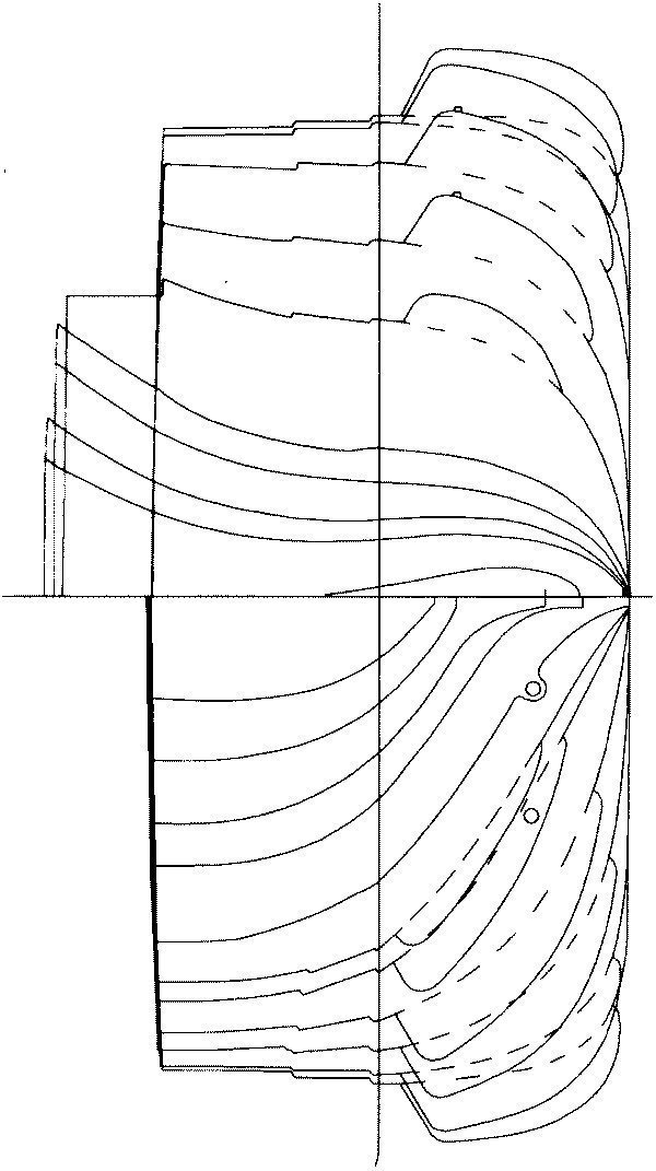

    Nagato -- John gave me Tommy's old Nagato -- I planned to make a new hull for it and use the existing superstructure. However, my set of plans was grossly inaccurate (to be fair, it was being used as an example on how to interpret hull lines and not as a plan). I looked to see if it was possible to rebuild the hull, but there is simply no way. I have ordered a new set of plans. In the meantime, it sits sad and forlorn in the garage.

    The Eagle is still in the wings. I bought some 1:144 swordfish to put on the deck. I almost started it, but the bulges will make it almost impossible to sheet.
  4. Bob Pottle
    2,001
    Are the bulges on Eagle the stepped type as on the QE Class and Renown? I'll need to figure out how to sheet bulges like that in the near future.
