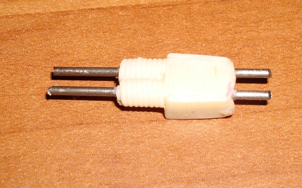

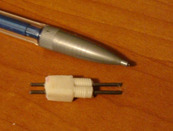

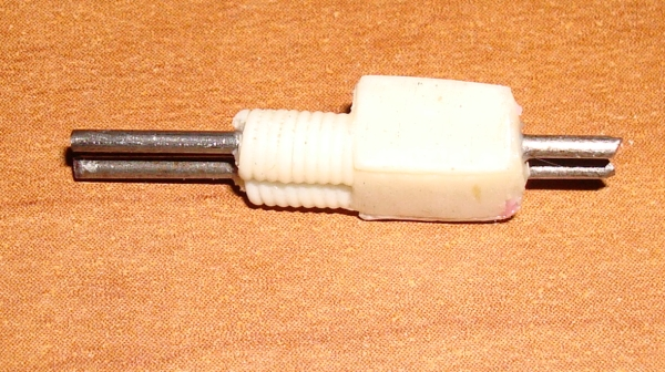

    Here's the first one, fresh from the mold. Not perfect, but I think it'll look nice for combat scale. Two of these get mounted on a common base to form the quad Bofors. One of these goes on a smaller base to from the dual Bofors. I need to make about 9 more molds so I can cast more than one at a time. (I'd be doing it now, except the cold snap we are in this week is outpacing the ability of the shop heaters to keep the shop warm)
    *For scale purposes, I took a pic with the tip of a mechanical pencil next to the guns. Not microscopic, but you get a feel for how small the part is. About half of the wire sticking out the back of the mount will be trimmed, and I have to add the flash suppressors to the barrels as well. Hope you guys like them :)
