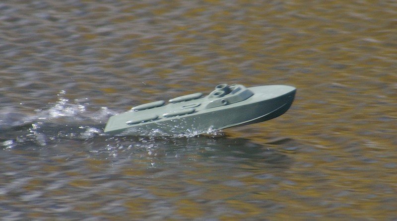

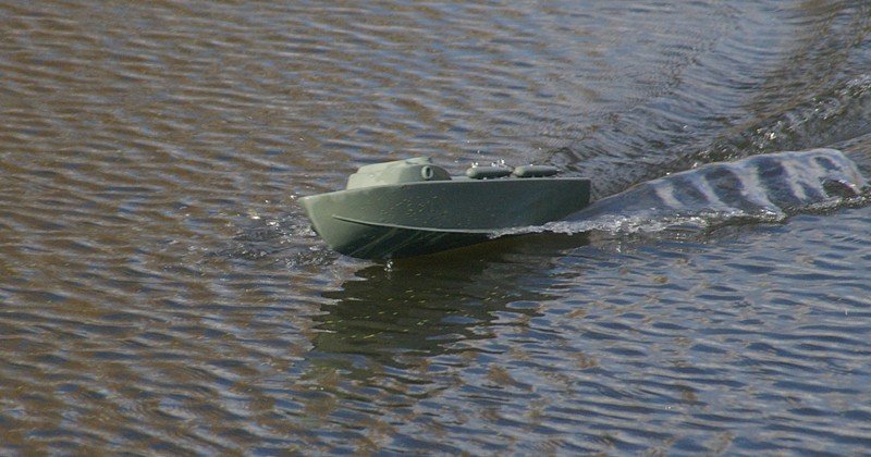

    We got together at the Versailles pond this weekend for a little battling and boat tests. I was able to get the PT 564 prototype on the water for some tests. It runs pretty good, however I'm having problems at full speed: the torque from the single prop rolls the boat over whenever it gets fully on plane. Using an X430 metal prop or a plastic 32mm racing prop, the boat runs great on 2 cells, just not quite on plane. On 3 cells it planes nicely, however if I take it above about 1/2 throttle it starts rolling over. I think my problems come from the narrow beam of the boat, which requires more speed to get on plane and has limited stability once it is on top of the water. I tried a smaller prop, both a 3/4" and 1" three blade brass prop, but while there was no torque problems there also wasn't enough thrust to get the boat on plane. I don't want to use trim tabs because I want the boat to be as stock as possible. Any one have any ideas how to solve this problem?

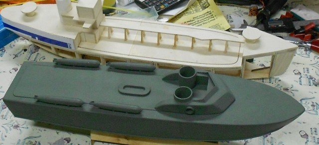

    Completed PT boat below, with the YOG 86 in the background.

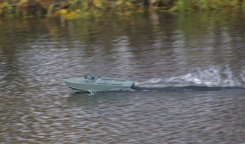

    Below is a video of the PT boat with 2 cells. It runs pretty good, fast enough to be fun and stable enough that you can put the rudder all the way over without rolling the boat.

    A couple of thoughts. Neither of which may sound very attractive.
    Go to a two-shaft arrangment, or a larger scale.
    I don't have any other ideas at this time. But I will give it more thought.
    I really think this will make the events more fun as it will allow us more
    flexability when it comes to entertaining the spectators during the down times.
    Well done.

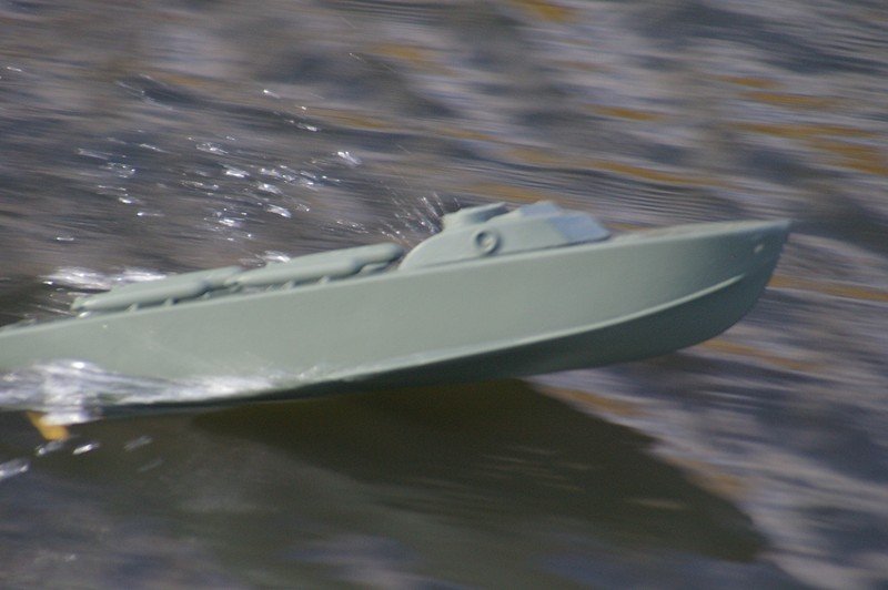

  5. rcengr
    1,279
    Thanks Mikey for posting the high res pictures. The photos are of my trials when I was testing out a single trim tab on the starboard side. I was able to tweak the tab to counteract the torque roll tendency. However, the boat didn't go any faster as a result, every time I was able to get the bow down it slowed down. So it looks like I'll stick with the 2 cell pack - it has a scale look as it moves through the water, which is better than speed any day.

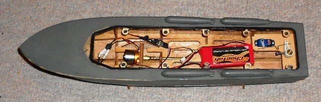

    The PT boat is 17.5" long by 4" wide. That's smaller than your LST. However, because there are very few components, it has plenty of room inside.
