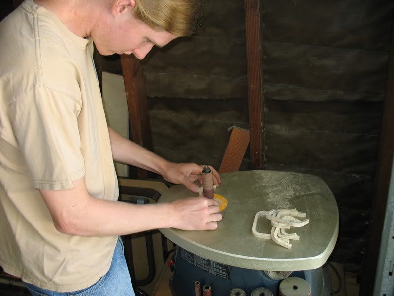

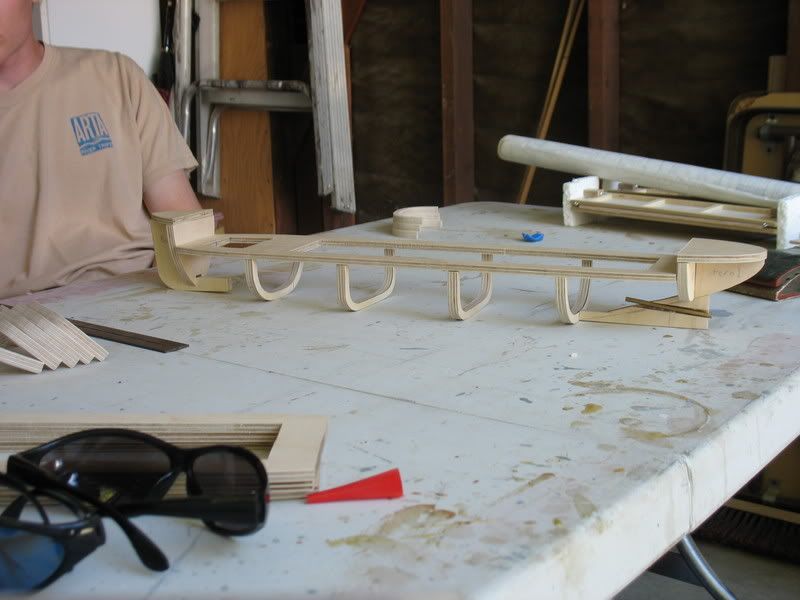

    cutting out the insides of the ribs, using a spindle sander. I first did a rough cut on the bandsaw, then sanded each rib to perfection.

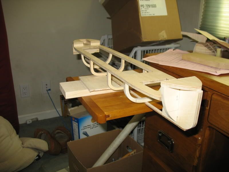

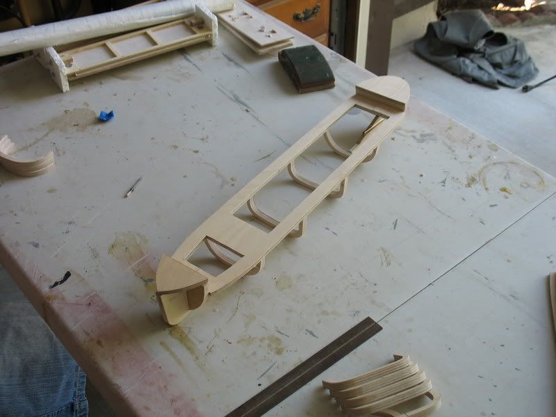

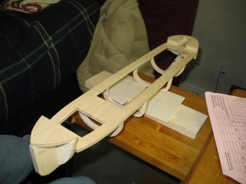

    Looks better now that it's hollow inside, right? I still have not glued the hull together yet, though I'm almost to that step.
    Another view of a test-assembly. Possibly more interesting than the transport is the wood-and-foam test target in the upper left corner, to be used for warm-ups before an event. Make sure you're putting holes where it counts, right?

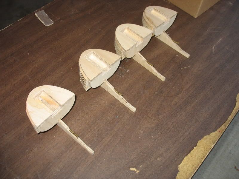

    I attached solid wood to the stern of each ship for its impenetrable area. I still needed to get the rudder controls in, so I milled a carefully-sized slot to fit in all that gear. Here's me cutting the slot for the first boat on the mill.

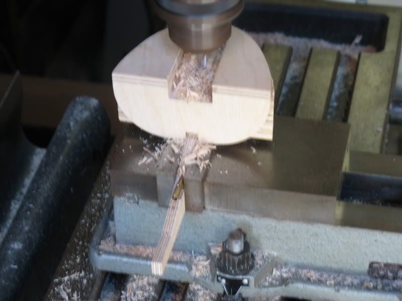

    A closeup on the milling for the 4th one. I had to carefully size the cut so as not to break out through the bottom of the boat in the back. I think I made it, but I won't know for sure until I do final shaping on the impenetrable.

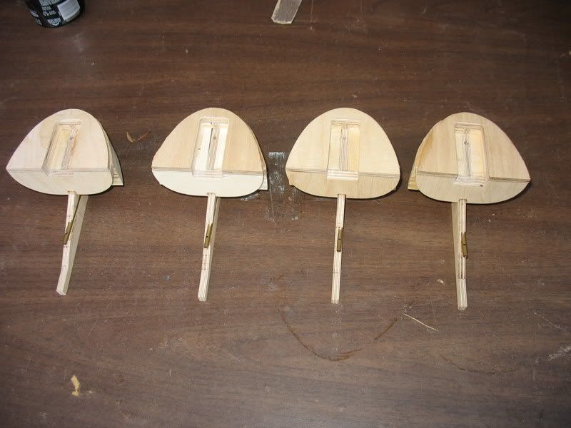

    The results! Not quite precise to a thousandth of an inch, but within 15 thousandths, which is plenty enough for my purposes.
    And one other view. Please note that I am STILL using entirely scrap wood and spare parts found lying around the shop, for a total cost of $0. Unfortunately I'll need to get electronics soon, and I don't have enough spares sitting around.

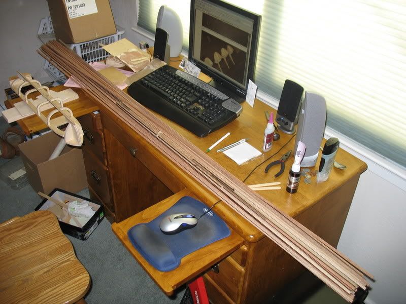

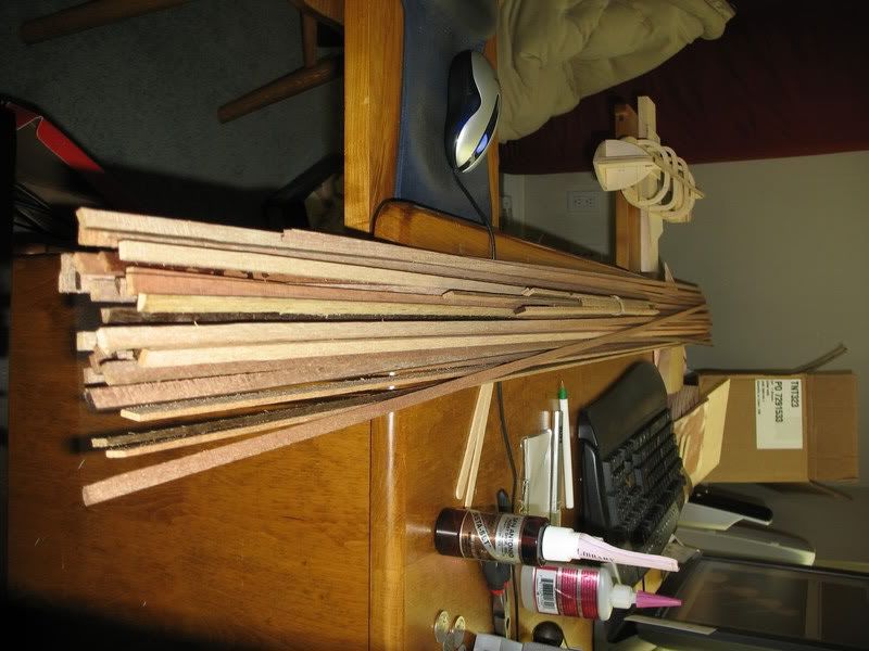

    Quick update: I spent this afternoon making planks. First I stopped by the local hobby shop, and saw that 1/4" x 1/8" x 2' wooden planks were selling for $1 apiece. I needed 120 of those planks, and I didn't want to pay $1 per plank for it. So instead, I bought a bunch of 1/4" thick mahogany floor planking from a local lumber company. $10 for 30 planks, 1/4" x 1.5" x 6'. I then took three of those planks, and cut them into 1/4" x 1/8" x 6' planks for use on the transports. Those three big planks were turned into more than enough planks for all four ships, and I will trim them down further once I start putting them on. And even better, I still have 27 more planks left over for future projects! Now that's awesome.

    Lots of wooden planks. Approximately 1/4"x1/8"x6' and a whole bunch of them. This created as much sawdust as all previous woodcutting combined.
    Just another view of the pile"O"planks.

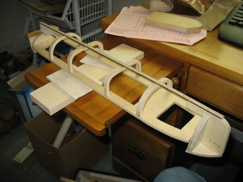

    Here's assembled hull number two, awaiting planking. That first plank along the bottom acts as the keel, but once the ship is planked it will be just another board on the bottom.
    Another view of hull number two. You can see the keel plank better in this view.
    And the underside! Before planking, I will partially saw through each of the ribs, 1/2" off center on both sides. Then I'll plank the boats, then I'll finish the cuts from the top. That makes it much easier to rip out the parts I don't want, so I can easily install quality water channeling.
