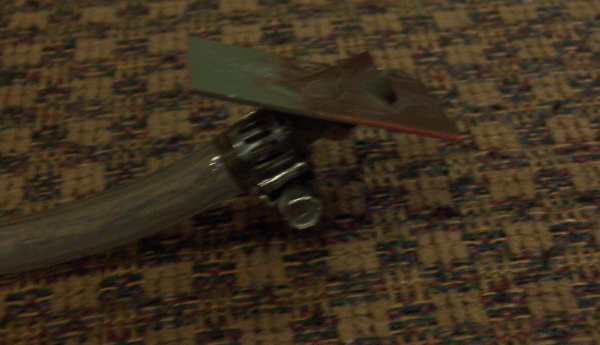

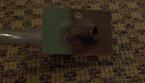

    I make the pump outlet part of the main deck and have the stream going towards the stern. This way the outlet never gets detached or drops below the deck. Just cut out a small 1 inch by 3 inch deck and drill a hole through it. Epoxy the outlet to the deck piece. Drill a hole on the outside edge and screw it to the subdeck. Now you can take off the main deck and the pump outlet will stay in place.
    Mine goes towards the stern for two reasons. 1 is I hate spraying the guys on the shoreline with an upwards mounted outlet. 2 is in case the ship loses main propulsion, my outlet will at least give me something (has happened at NATS to me). You don't really gain any speed as pointed out earlier and you are causing the ship to sink faster. But if you are mossed up wouldn't you rather have some movement? [:)]
    Be very careful in the way you attach the hose to the pump and the outlet to the deck/superstructure. Can't tell you how many times captains have sunk themselves when the outlet slipped below the deck.

  15. Lou
    Hose clamp underneath. Outlet glued to the deck piece.
    Hole in the side is where it mounts to the subdeck.
