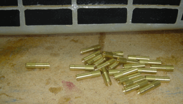

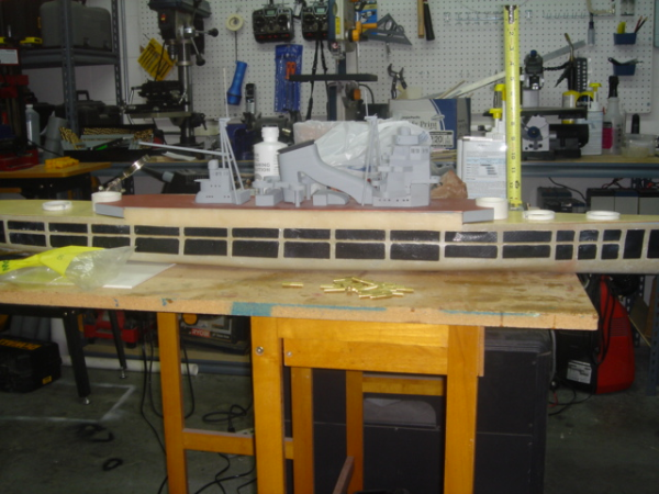

    Here are some pictures of it, Kumano in the background for scale reference.
    Not that many left really.

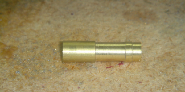

    Single close up.
