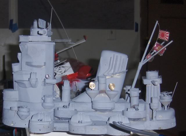

    I don't think that Nelson or Vanguard is a posible for me at this time. The Axis is what I build either Jap or Italian. The Yamato upper works came out rather nice so I will be concentrating on that baby for now (ventalators and all the small bits). I'll have Plato post some pictures of the work we have done on her,
    Carlo
  9. Powder Monkey
    Here yougo Carl
  10. Bob Pottle
    2,001
    Wow! What a great superstructure. It would save many, many hours of scratch-building.
