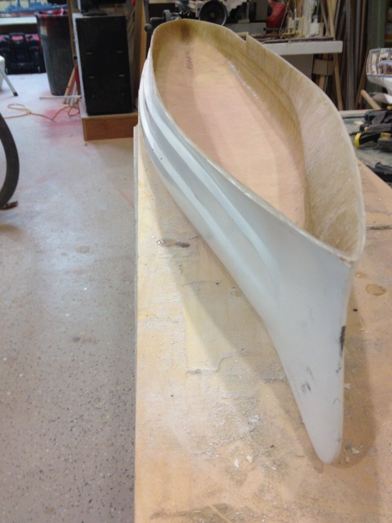

    uncut hull
  3. Lou
  4. Lou

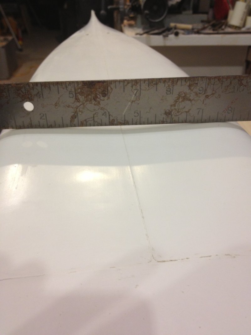

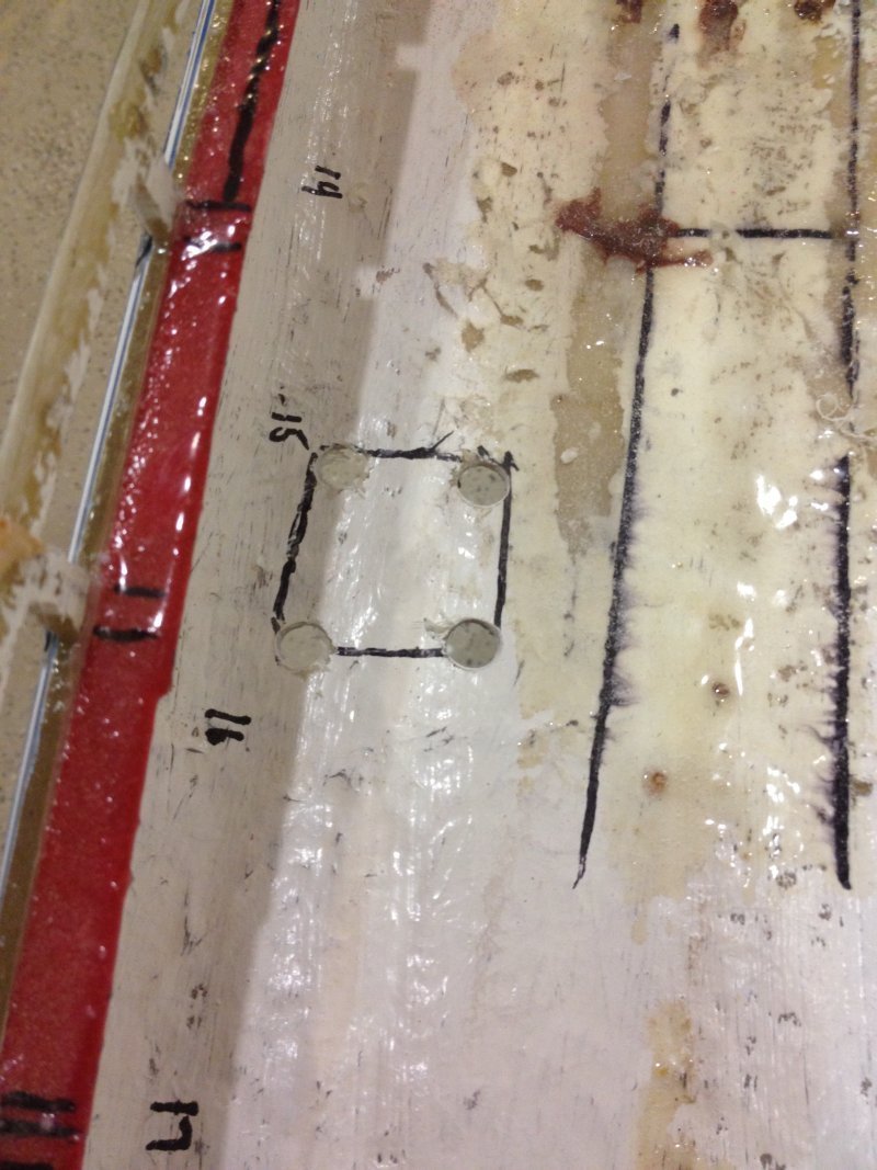

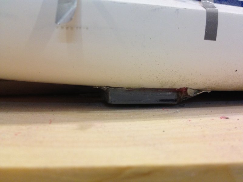

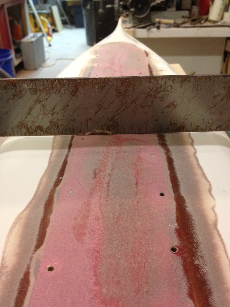

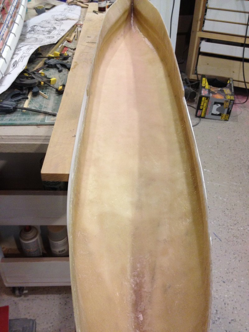

    The hull has "hogged", so the water channel has an upwards push that will not work for good water flow. Lets cut this hull up!
  5. Lou

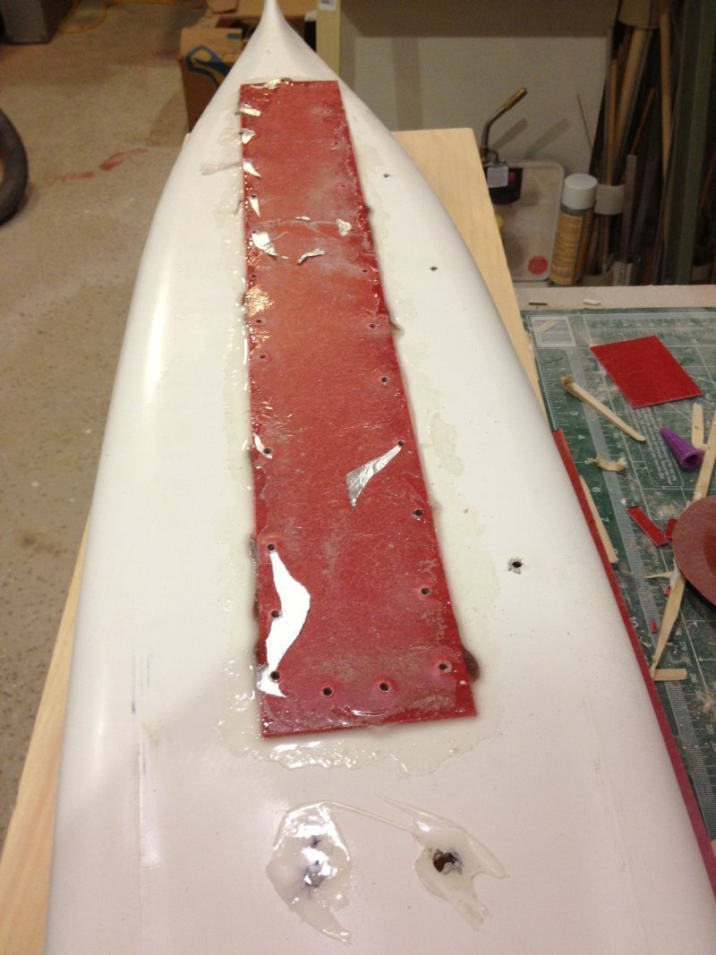

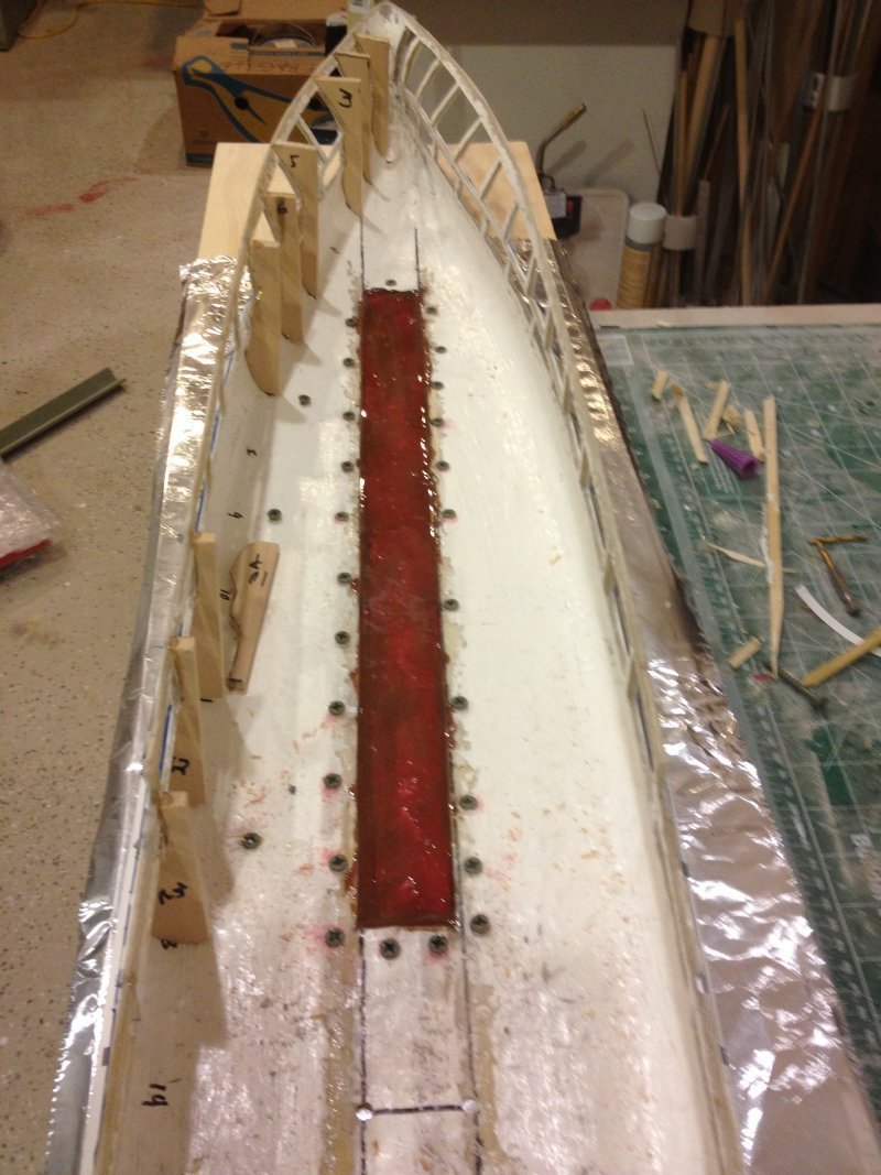

    Adding 1/16th fiberglass board to the bottom. All the holes are where I screwed the hull to the building board to make sure everything was level.
    Frankenstein stiches

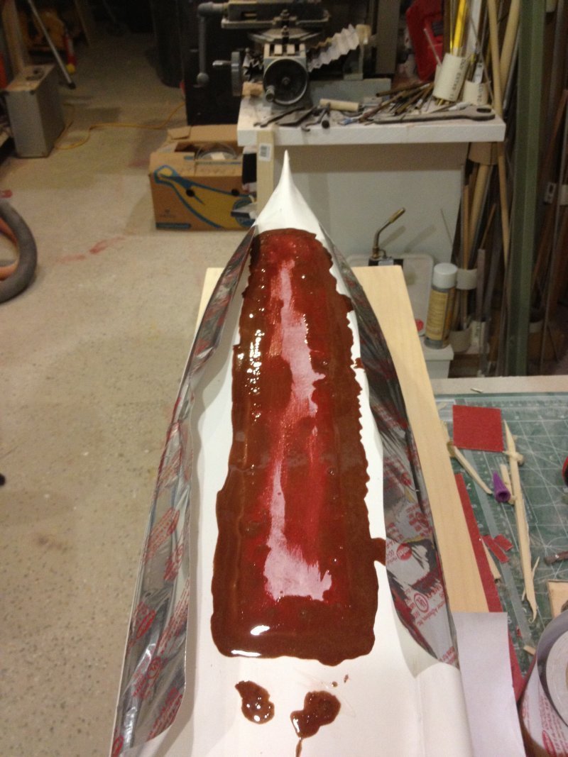

  6. Lou
    Used west system with micro balloons to fair it out. This will get sanded flush
    Much nicer! Flat is good
  7. Lou

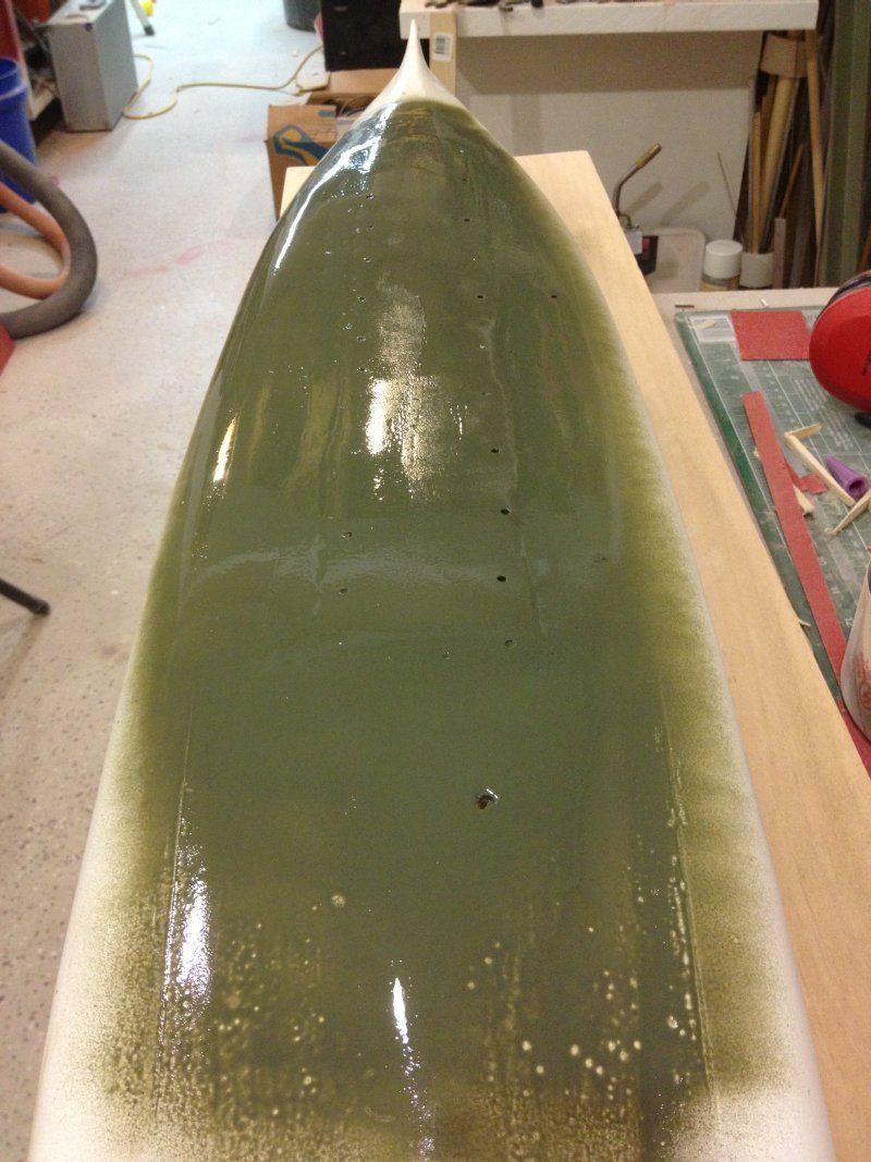

    Primer time to see the low or high spots. Time for more sanding and filling.

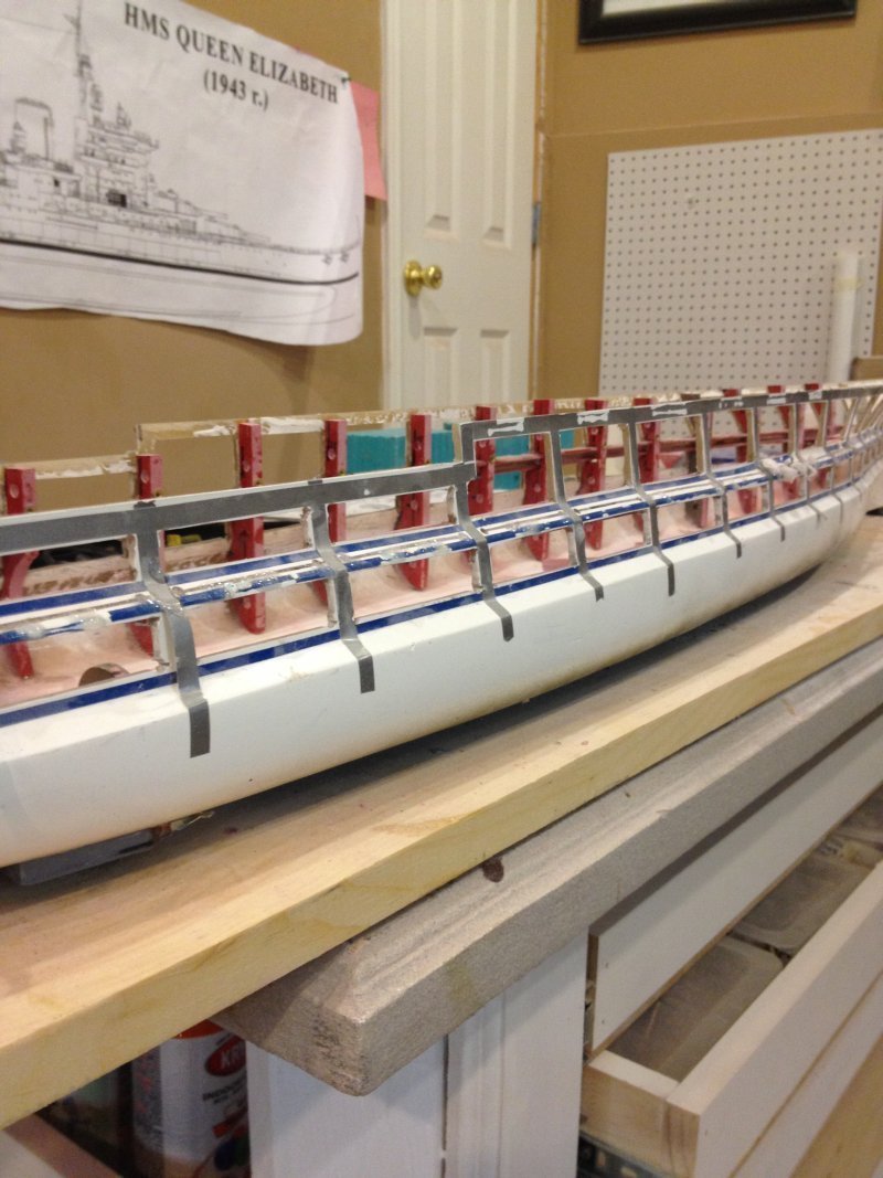

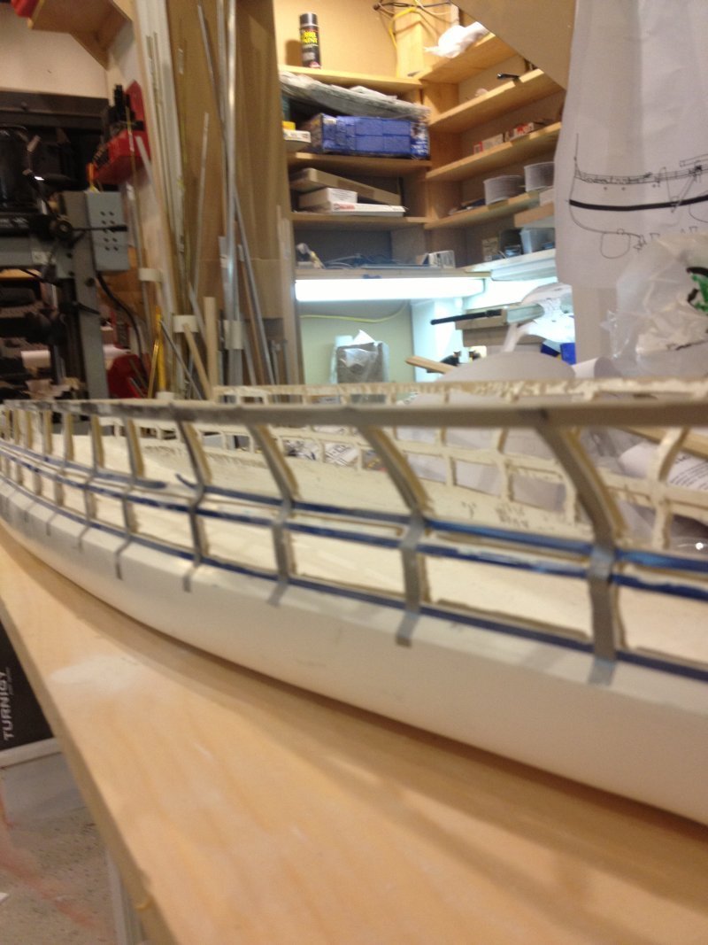

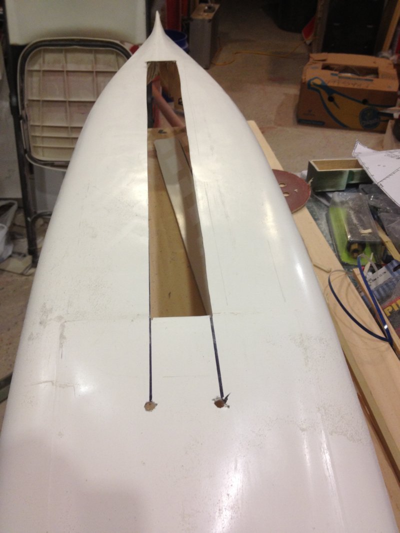

    Lets cut some windows. These are rough cuts at this point, I need to get the 1/4 inch backers in place and then sand to shape.
    Time to add the double stringers, this is to make it "ram proof". Using 1/16th sheet cut about 1/4 inch wide and lots of west system epoxy.

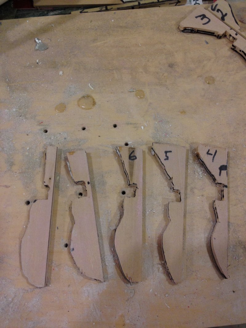

  9. Lou
    Using 1/4 wood templates before cutting the fiberglass board. Lots of work to get them to fit the hull.
    Fiberglass sheet
  10. Lou

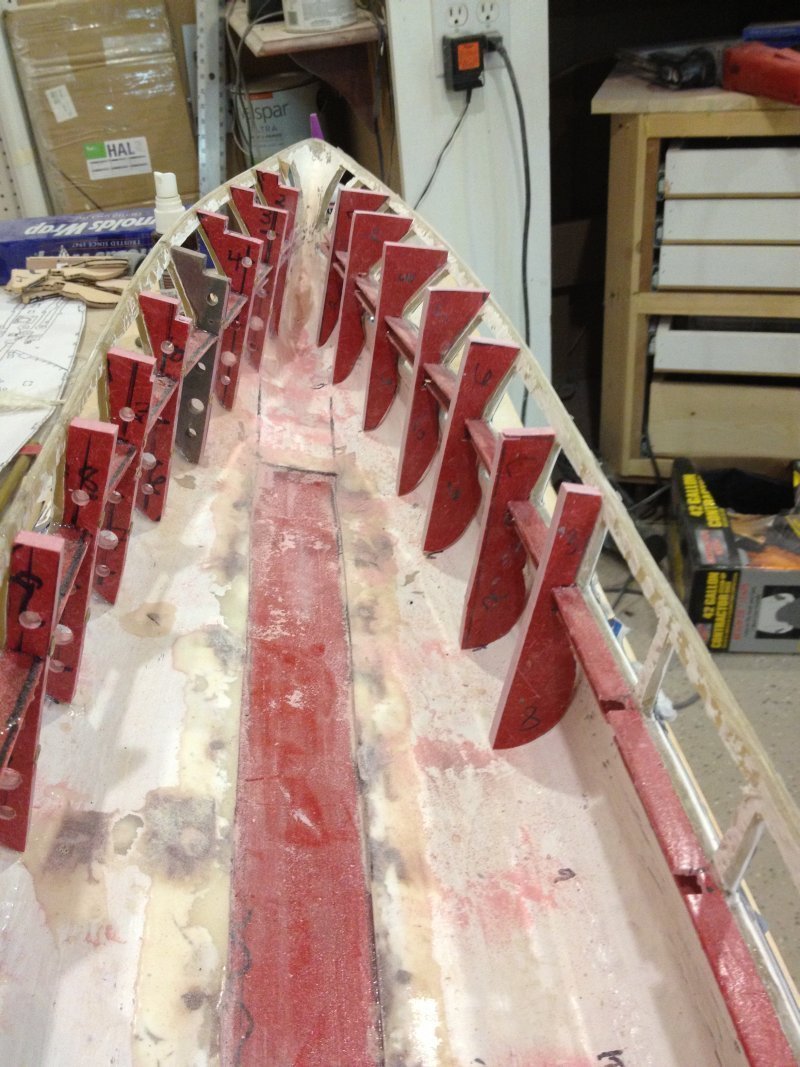

    Port side rib templates complete. Will be drilling holes into the ribs to lighten them.
  11. Lou

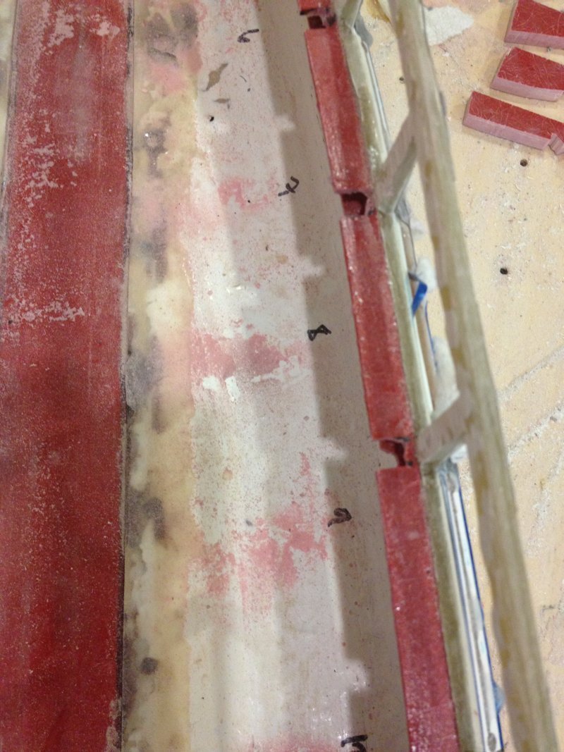

    Had to notch the stringers, this will be epoxied to the ribs.
    Ribs in and holes drilled on the Port side.
    Started the starboard side ribs, this is a shot of the test fitting.

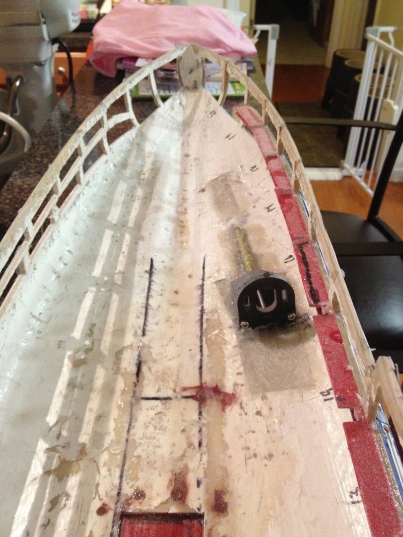

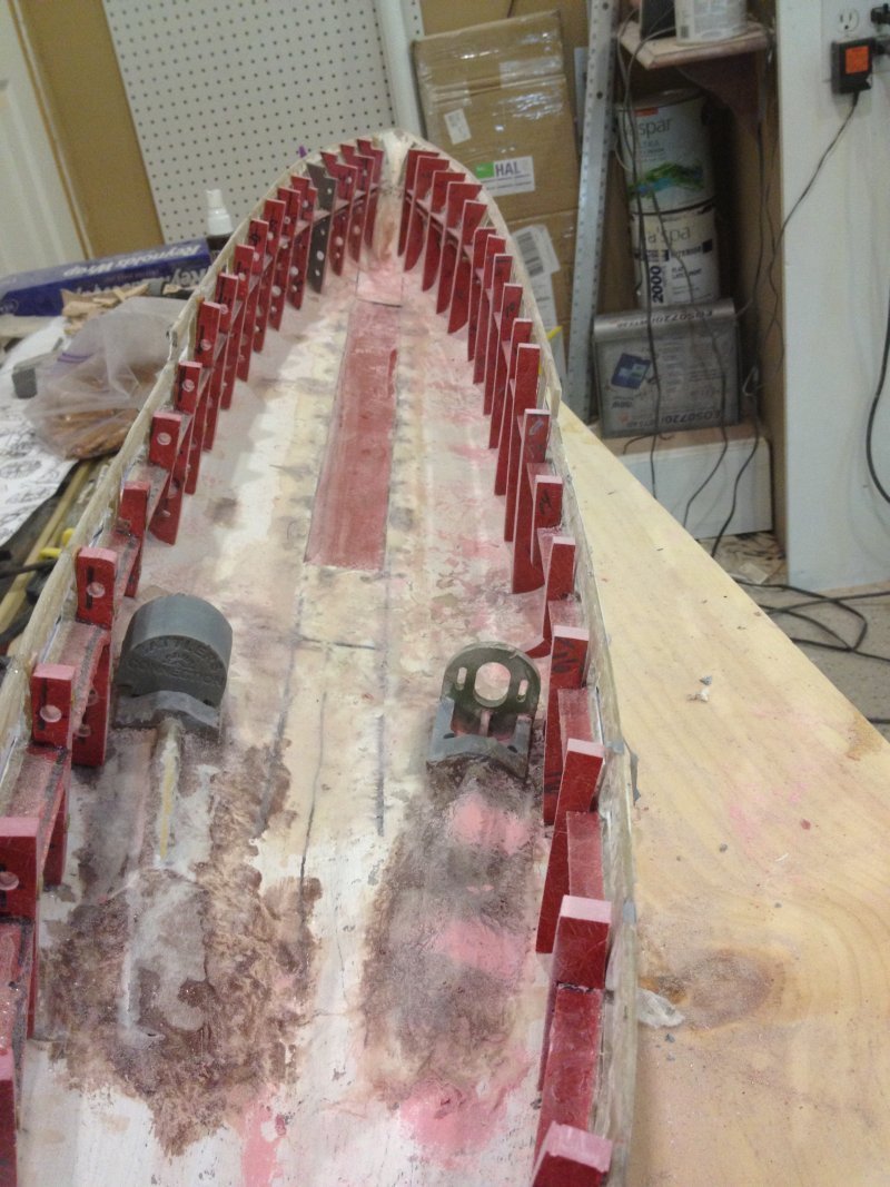

  12. Lou

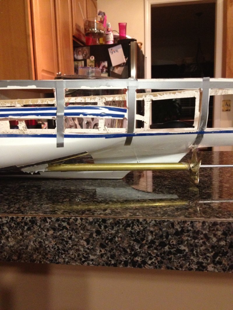

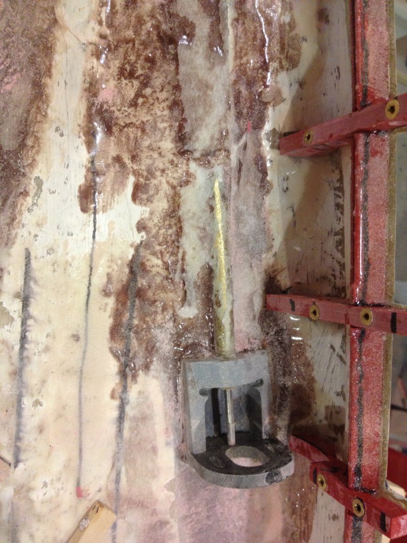

    Time to add gearboxes. I prefer to drop the boxes through the hull and then sand them flat on the bottom. This helps with keeping the shafts parallel to the keel. Start by drilling the corners.
    Have some sanding to do...
  13. Lou
    Glassed in with epoxy.
    Look at the ribs, each one is tapped for screws to hold on the lexan armor (overkill, but I like it). Have to keep them level with each other, used a witness stick to mark each one.

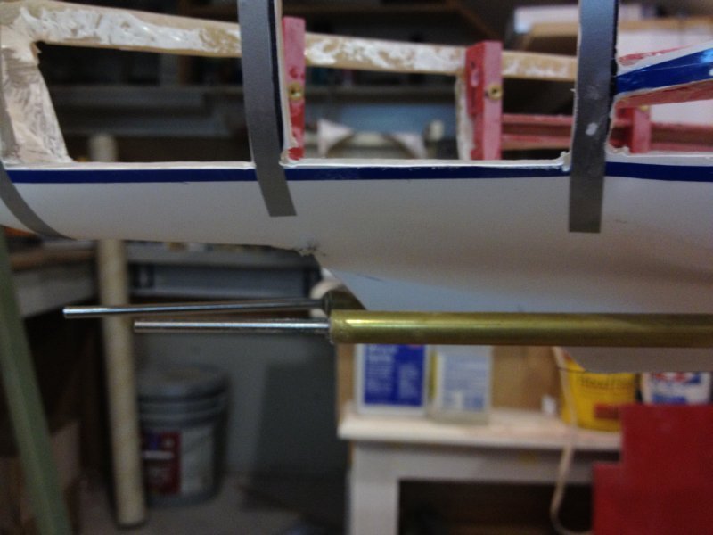

  14. Lou
    Shafts look good!
    Shafts are rough cut for length at this point.

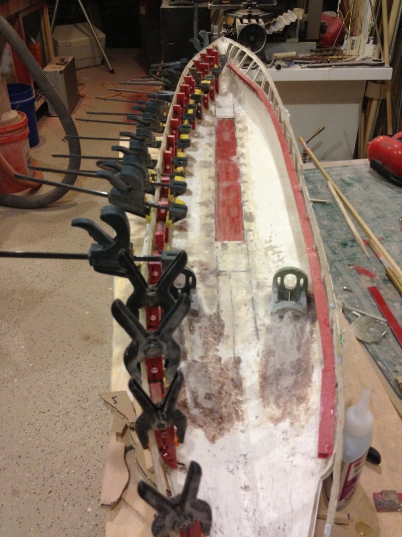

  15. Lou
    Clamps, and lots of them

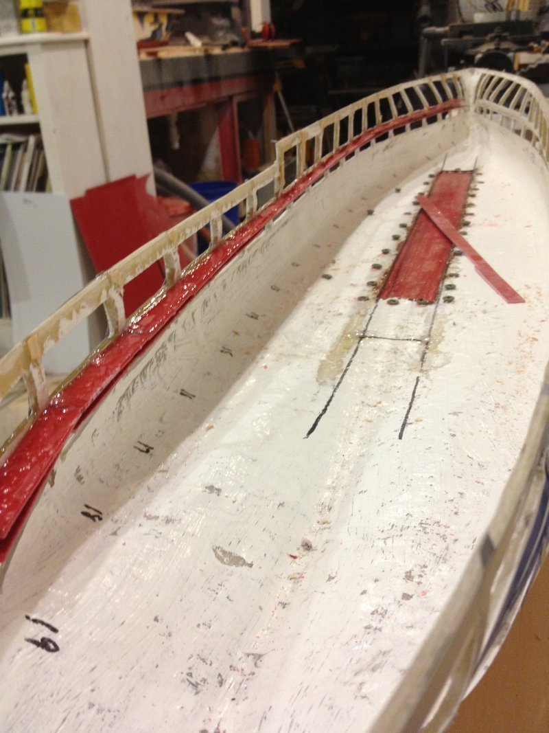

  16. Lou
    Finished the fiberglass starboard ribs, still a lot of work to be done before gluing them to the hull. As the sub-deck will be inset, I was not too worried about the height of the ribs as these will need to be cut down once I figure out how I want to attach them. Thinking that I will do the same as the wood boat builders and notch to make a strong joint.
    Next is to make the inserts for the blast shield, then mark and drill all the holes in the ribs.

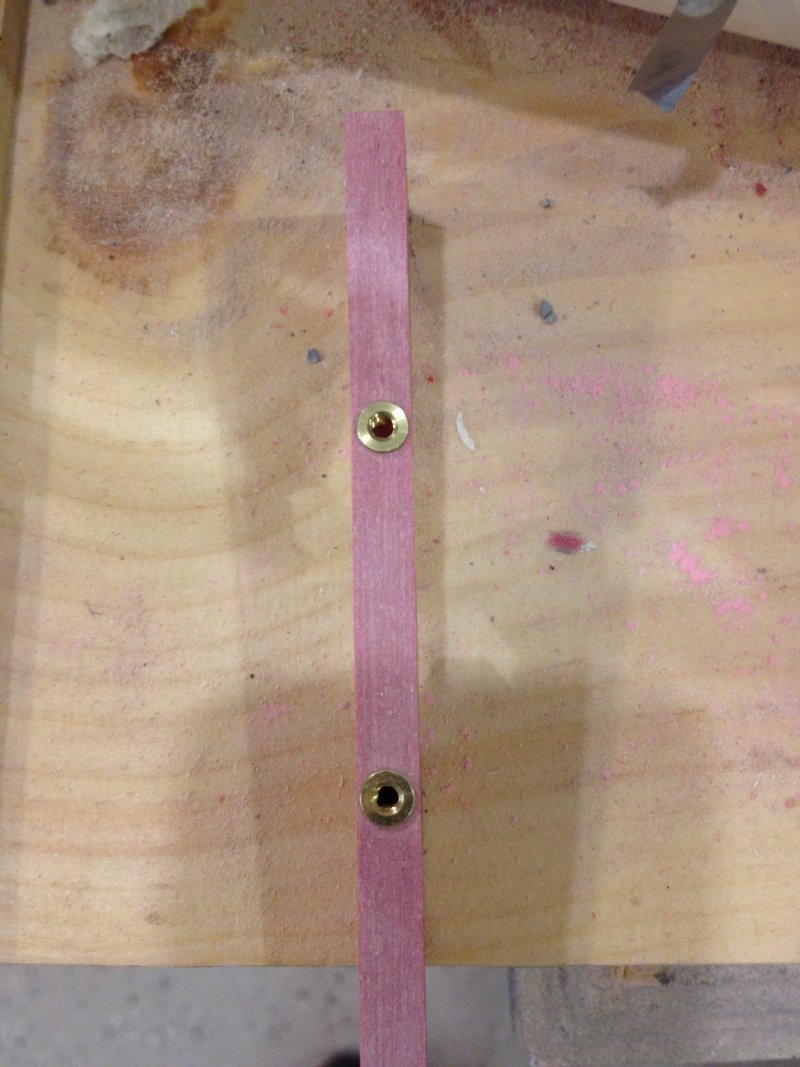

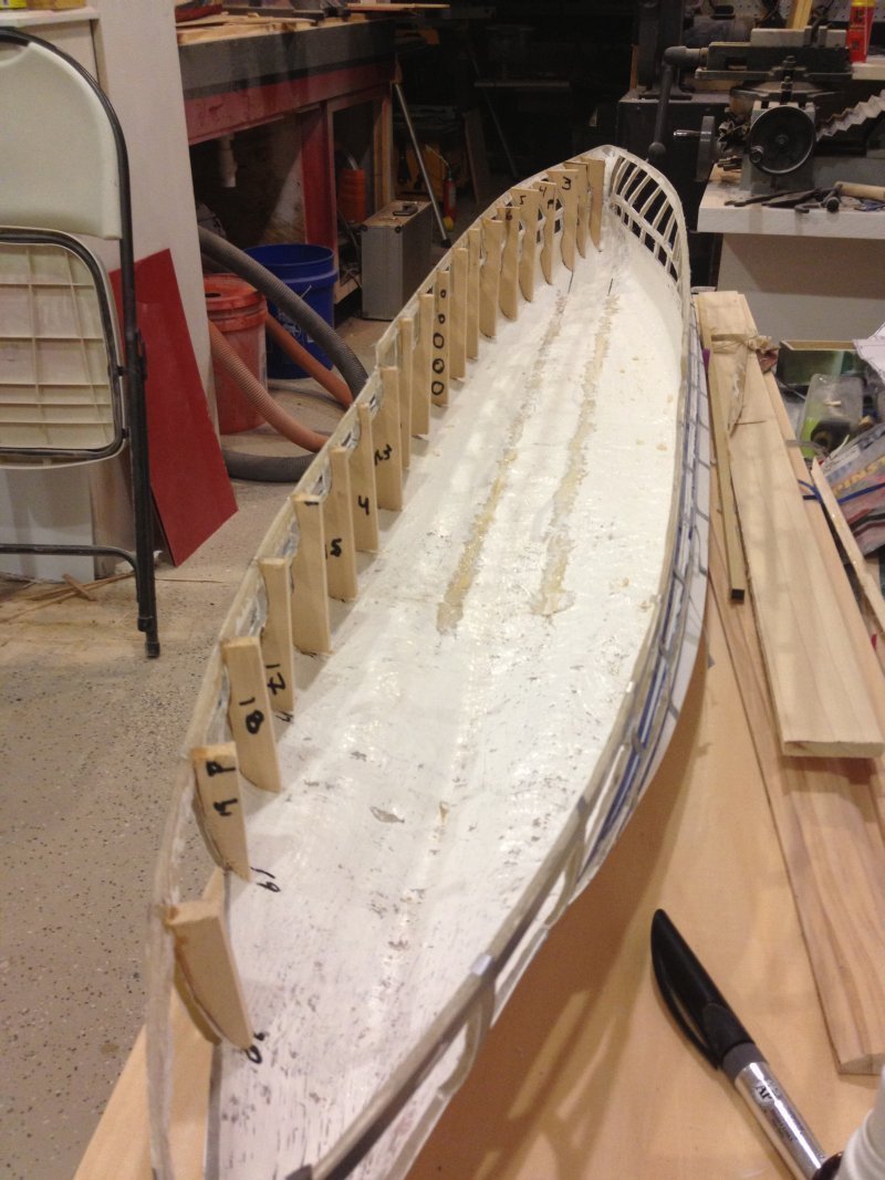

  17. Lou

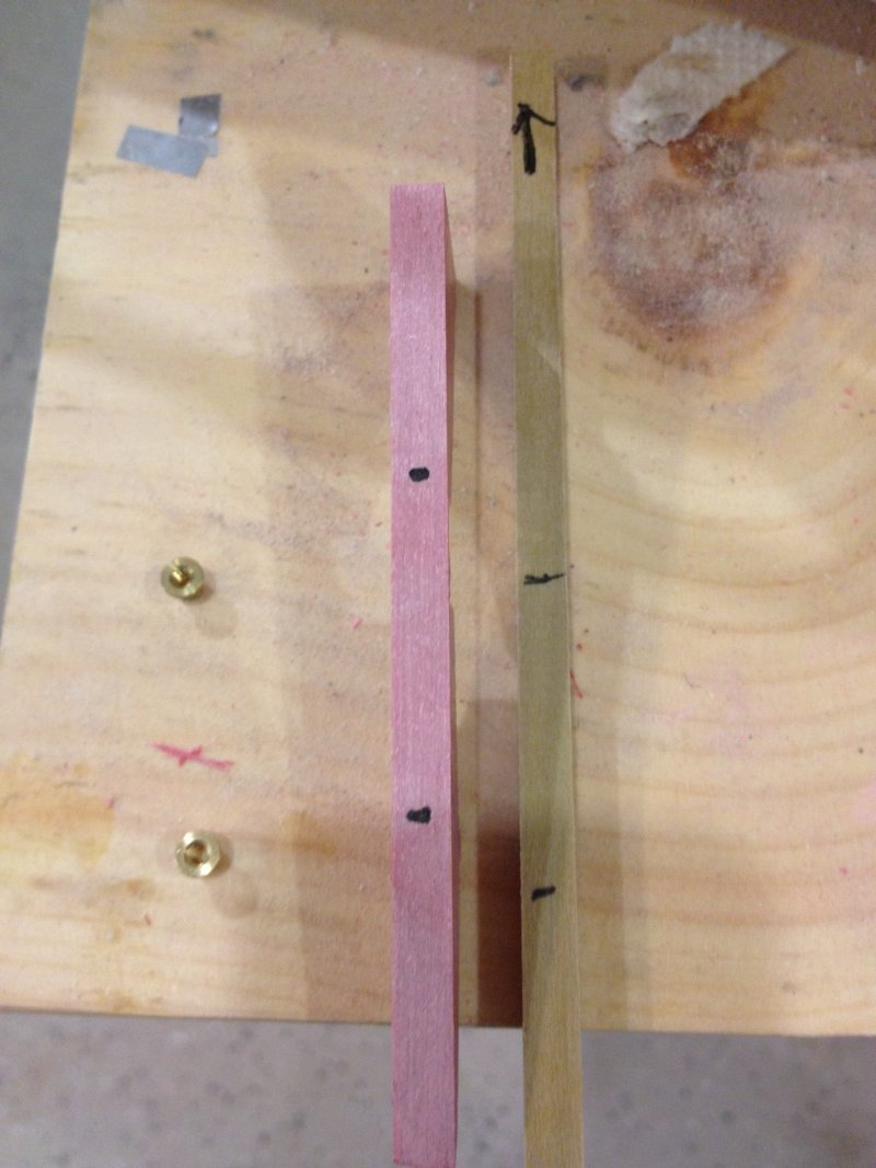

    Using a 1/4 wood stick, I mark the locations for the threaded inserts. Using at 4.40, the screws will have a washer to help increase the surface area. In the picture below from top to bottom, witness pole, rib, and the two brass inserts. At this point the rib has been marked, next is to drill a pilot hole and then follow with the correct size drill bit.
  18. Lou
    Inserts are in, looks like I was slightly off in the bottom placement. Hopefully that will not be as noticeable when everything is together. Now I just have to drill 19 more ribs...

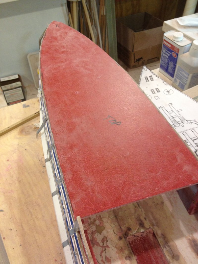

    Time to start planning the sub-deck which is composed of 1/8th fiberglass board. Sanding time...
