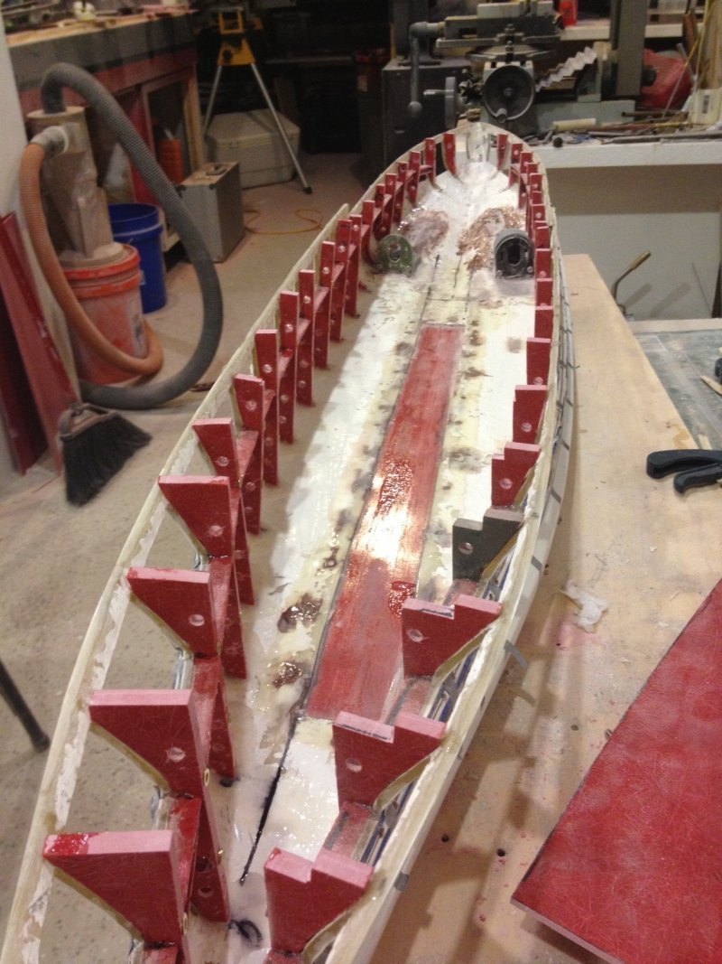

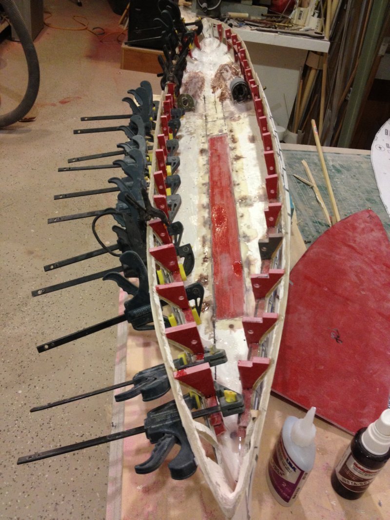

    Ribs are drilled and clamped. Not worried about the height as that will need to be cut down for the sub-deck.

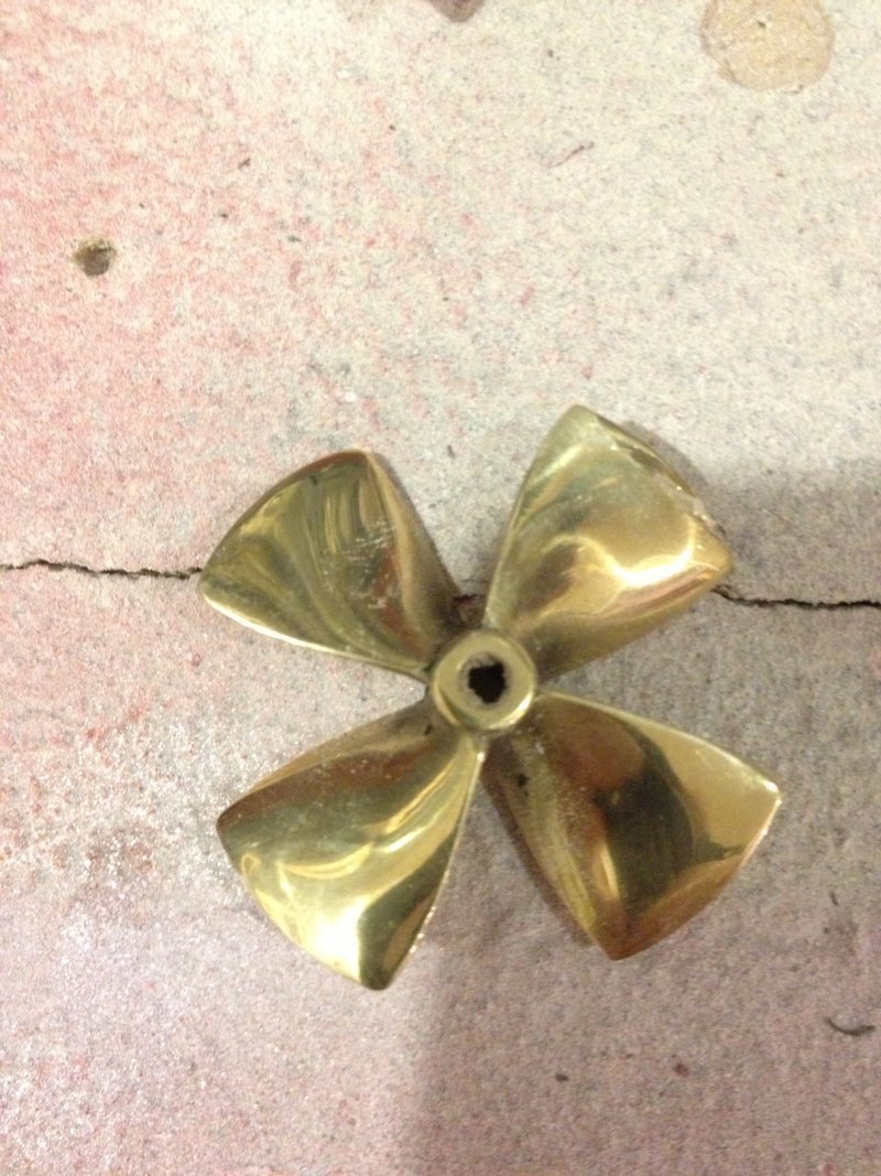

    Well, looks like I need new props. I used the same number with prop shop, can anyone help me find the correct order number?

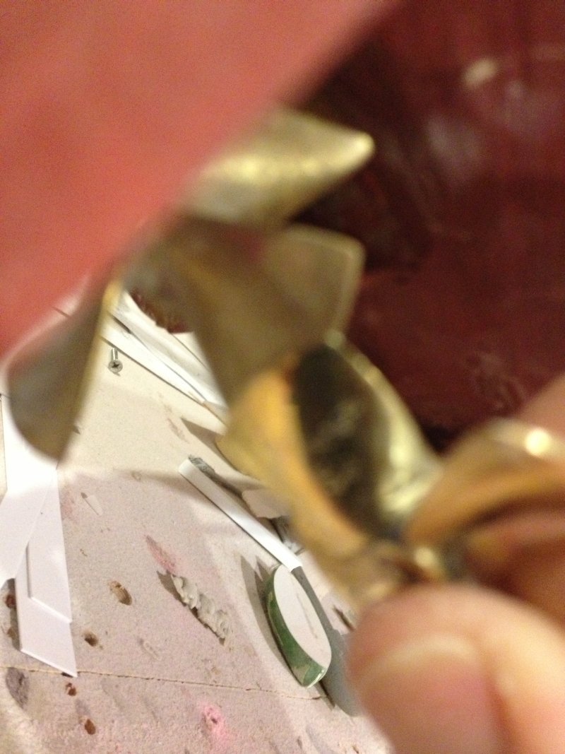

    In this shot, you can see the prop on the duke has a lot more blade area.
    Look at the curvature of the blade, it has a lot more blade area.
    This is what they sent. Could there be another type of Kort prop they got it confused with?

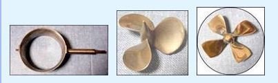

    From the Loyalhannah site for prop shops, the one on the right looks like the one I got. But I dont see that style on the prop - shop page?
    Look at the sweep and surface area of the blade and compare it to the one above

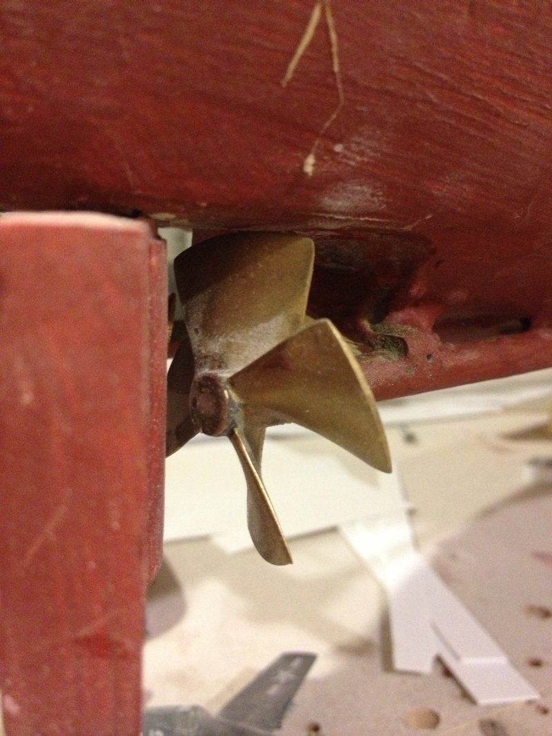

  15. Lou
    pics or it didnt happen
    What I got
    Not a hint of fire damage nor patina of smoke on it. I strongly question whether the prop in question has even been near Lou's ship.

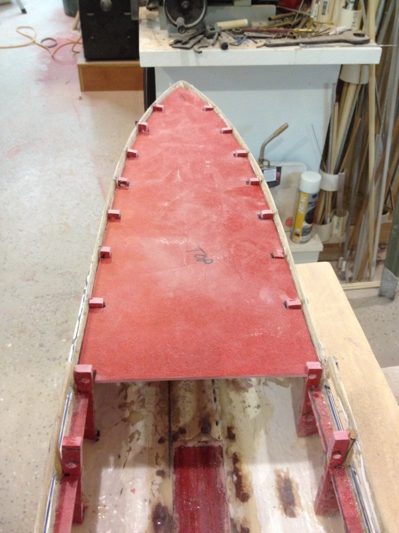

    Notching the subdeck for a strong frame, this is the aft portion of the ship.
