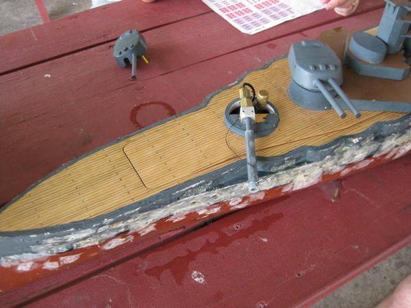

    Jeff and I cut our barrels shorter... OOPS TMI!!!!
  2. jadfer
    That boat sure does have a purty stern!!!!
  3. irnuke
    Longer barrels don't give you higher velocity... if anything, the additional drag may lose you a bit. A long barrel on a firearm works b/c the gunpowder expansion is WAY more than the barrel volume. The little shot of CO2 during our valve cycling isn't that great a volume. All our velocity comes from the momentary "check" at the o-ring causing a pressure spike.
    This is my understanding of the system. YMMV.
  4. Bob
    Shorter barrels do fire at a slower speed.
    I can't think of a bow sidemount on any of my ships that does not hang off. Yours looks normal too me, about 1". I worry more about punching holes in people with it. Happens but not that much.
    Now my stern sidemounts get cut close to the deck, maybe 1/4"- 1/2" off. They punch holes real easy.
    Flip up the turret, what's holding the barrel in under there?
  5. jadfer
    I used to have overhanging barrels on the Baden until I had my gun and barrel bent/twisted when Foster's big Italian boat was going the opposite direction and drove right into the gap between my gun and ship. The gun was pointing backwards creating a V shape against the hull. After that I cut them down... at some point.

    6/32 screw and soldered tab on the downtube
  11. Bob
    Bolt something to the red glass that the barrel goes through. This will hold the gun in place when it gets hit. When it gets hit hard the barrel will bend.

    Lock that barrel down :) It will get hit. I've had innumerable people ram the bow side mount on the Duke and just turn the barrel into a pretzel. You want something that will allow a badly bent or dented barrel to be removed (tight fitting sleeves will not let go of a bent barrel).
