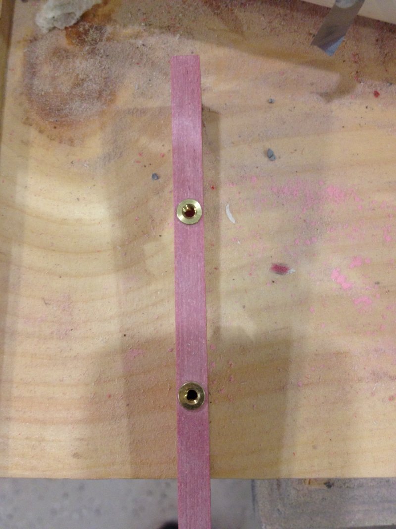

    I dug through here but cant seam to find any source... where did you get the nice inserts for your blast shielding? What size and link would be great...
  16. Lou
    8574K38
    Impact polycarbonate that is comparable to the Lexan brand name. Been using this in my cruiser for a couple of years with no issues. You can even double it up (use a couple of washers between sheets) in a panel if you are really concerned about failure. Biggest benefit is weight.
    I could not find it in my past orders (sometimes the account function in McMaster is not the most reliable), but I believe this to be the correct link. I chose 24 inches as you can overlap joints and 36 inches is just too large to cut and install.

    Not the sheet material, the inserts.... those nice little inserts to hold the shield in place... I can get inserts here at Lowes, but they cost too darn much and the ones you are using look a little different as well.
  18. Lou
    94615A112
    50 inserts for $10, this is for using 4-40 screws
