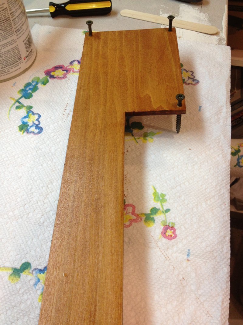

    First coat of stain, two more to go

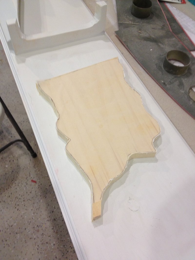

  2. Lou
    2,127

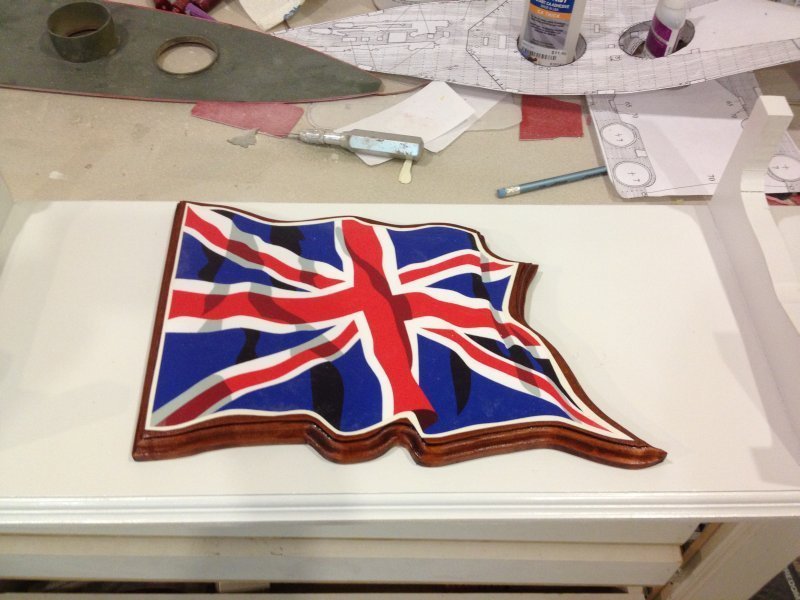

    Rough template for the flag in the middle, will need to further sand then route the edges.

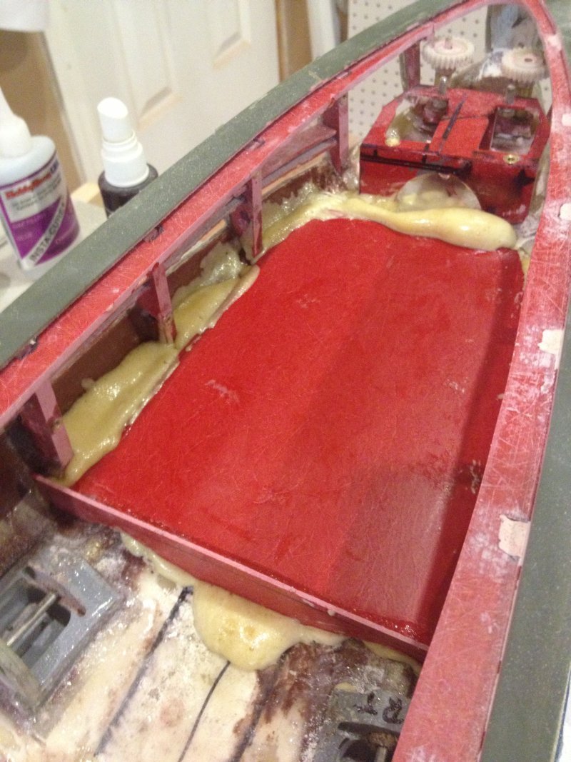

  4. Lou
    2,127

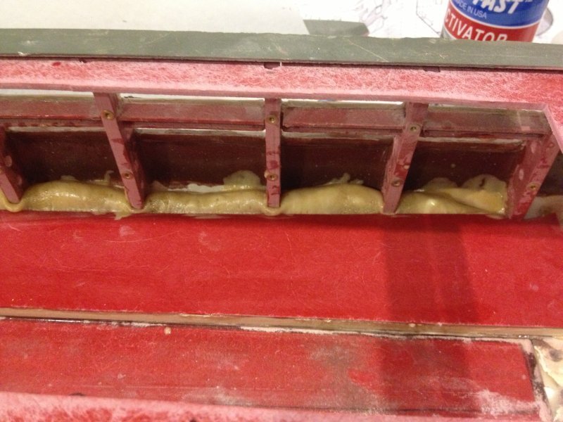

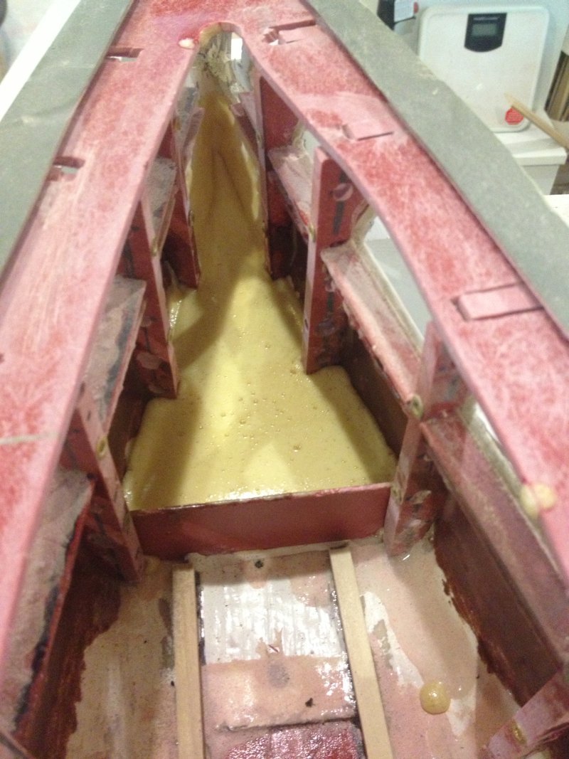

    Built the water channeling for the aft portion on the boat. This helps create the knuckle for the water to redirect back towards the pump (and not rush to the stern). Foam is curing prior to being sanded flush.

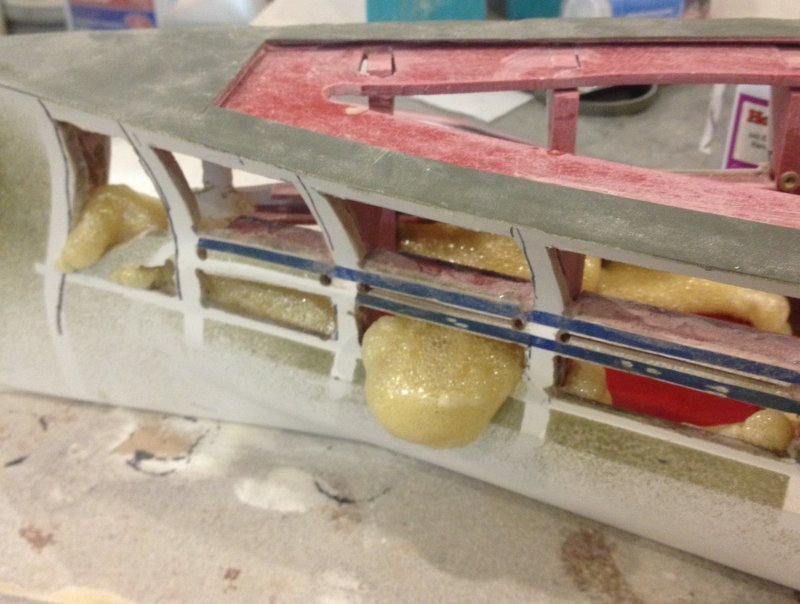

  5. Lou
    2,127

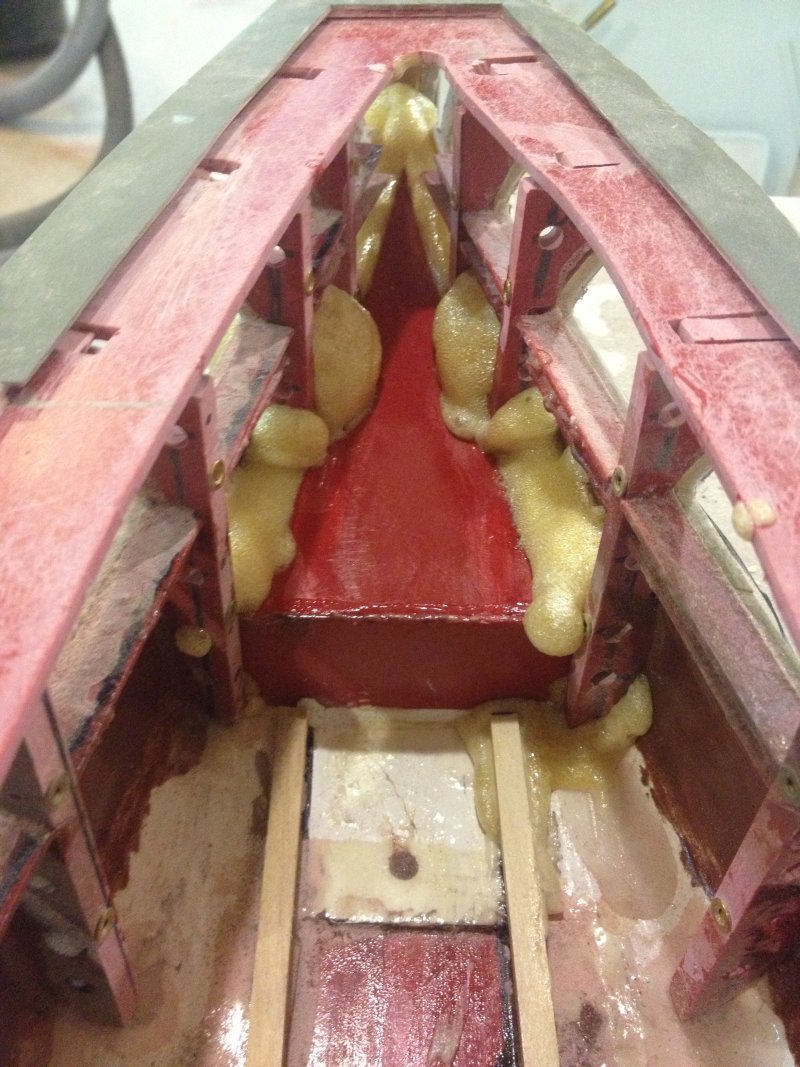

    The bow is also getting foamed.

    Top is on and the second layer foam added.

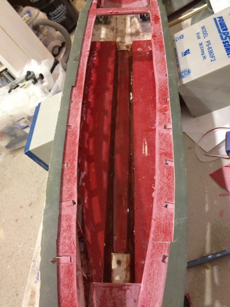

  8. Lou
    2,127

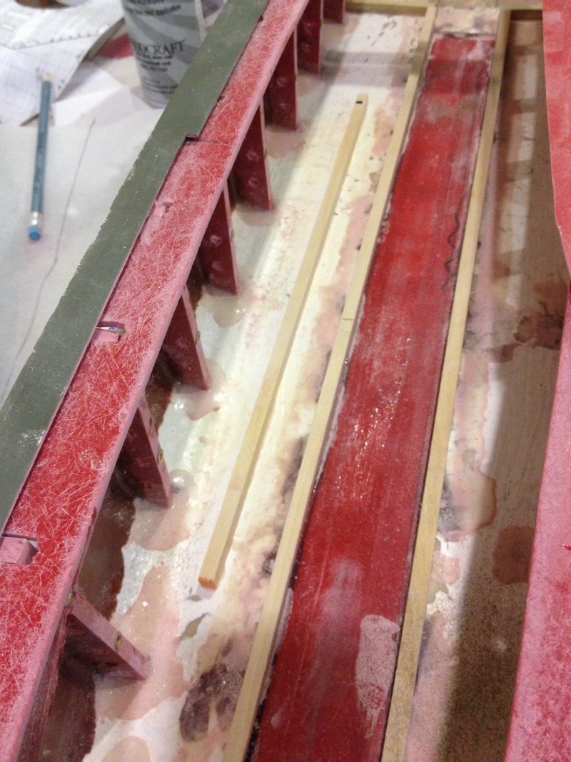

    Starting the water channeling for the center section of the boat. I have glued in another 1/4 stringer for the fiberglass sheet to rest on so that everything is flat. I add the foam and then quickly glue down the sheet to the wooden stringers, then place weights on top to help force the foam to fill the entire cavity. Without the weights, the foam will actually push up the sheet.

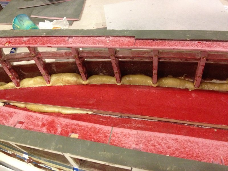

  9. Lou
    2,127
    Foam is coming up the sides, this will also create the base for the angle so that water is directed towards the middle channel.
  10. Lou
    2,127
    The foam will also seal underneath the 1/4 inch strips.
  11. Lou
    2,127
    Epoxy is used with micro balloons to give a nice curved radius to the center water channeling.

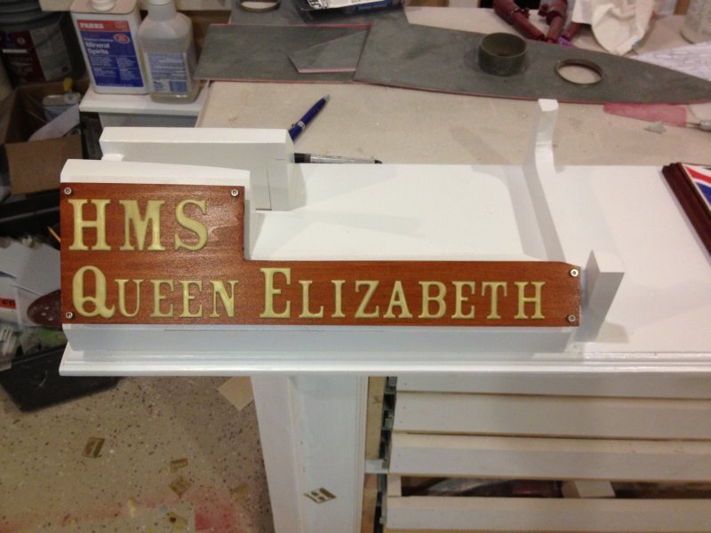

    With guests at the battle site, one of the questions you get is "What ship is this?". Hopefully this will help them. On the transport/docking board, the bow of the ship goes towards the left side.

    The name plate is raised from the board.

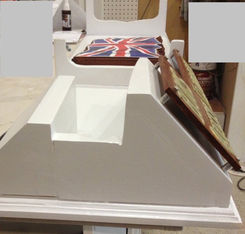

  14. Lou
    2,127

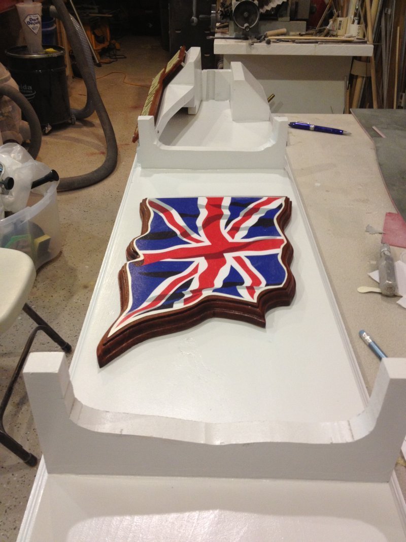

    The flag sits in the middle of the board, this is a vinyl sticker on top of cherry looking board. In this shot, the sticker is still on the backer (white edge around the flag) and once removed will have a nicer transition between wood and sticker.
  15. Lou
    2,127
    Looking towards the bow, you can now see where the ram bow fits in the groove at the top of the board. Foam will go on top of the actual boat holders, so it didn't need to be perfect at this point. I still might modify the holders to have cut-outs and look a little more polished, not sure at this point.
    How heavy is the boat stand?
    God now I want to build boat stands for my fleet. How big would I need one for Montana? heh heh. Really love the flag . Great idea and the plaque. Large and easy to read particularly for the veterans. Awesome work.

  19. Lou
    2,127
    Clark- Not heavy at all, this allows me to transport in the car and then go straight to the bench at pondside.
    Might still add a few more colors to it, not sure at this point.
