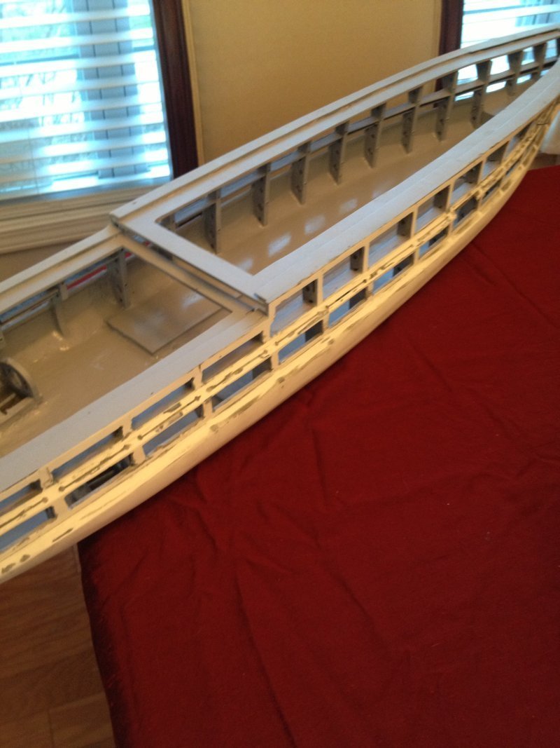

  4. Lou
    Cleaned up the belt line in preparation of final cutting of the two stringers. Interior received another coat of primer.

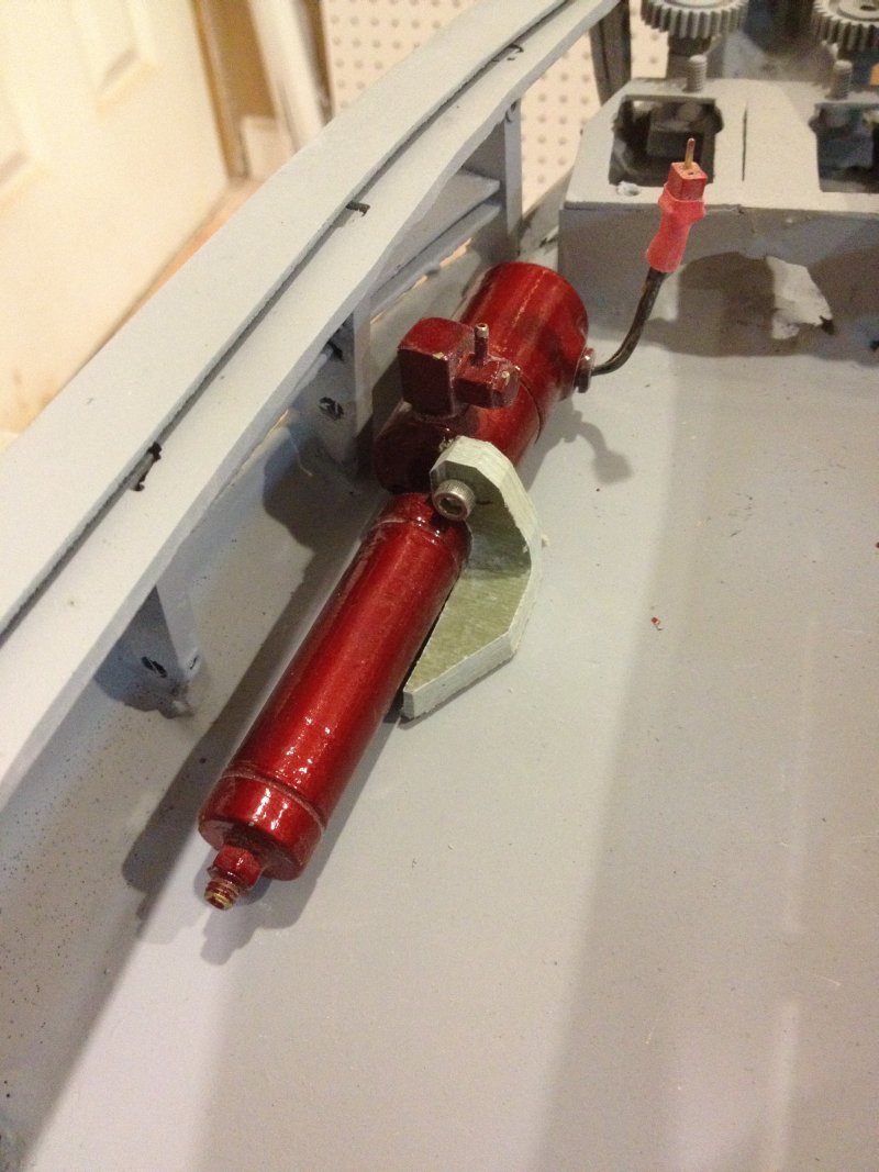

  12. Lou

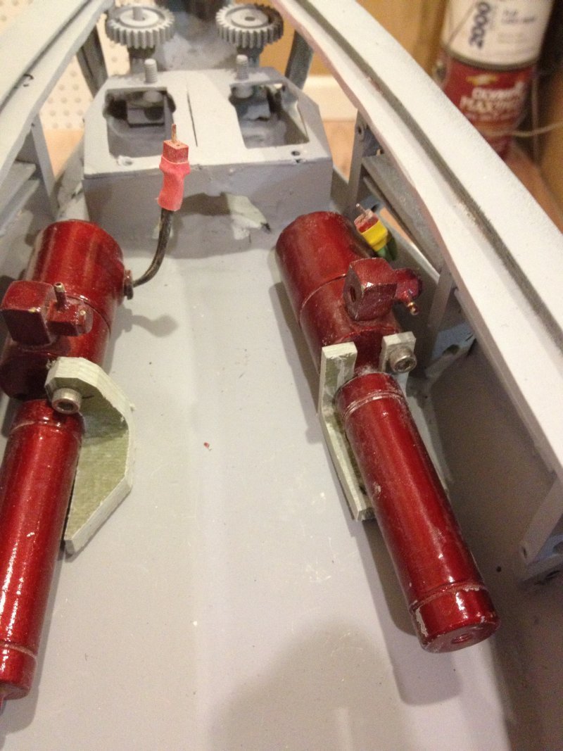

    It is a bracket to hold the solenoid. In the shot below I tried the paint you can get from a car store and had limited success. We just move stuff around a lot and the paint starts to chip, plus having the components under water for a while softens the paint, so I will try powder coating next.

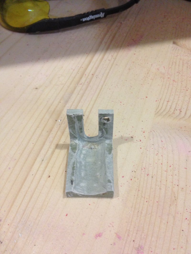

  13. Lou

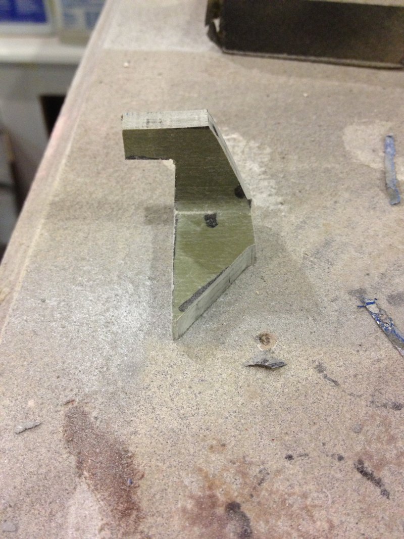

    That style of bracket was fine for three of the setups, the fourth required a different design so that I could get to the screw and still lift out the solenoid. I have cut the fiberglass angle to the correct width and now need to make the channel. Started by using the drill press.
  14. Lou
    Rough cut, but you get the idea. Next step is to smooth out the cuts and mount it to the stern deck.

    Two versions together, more I look at it I think I will make all of them the style on the right.
    Thoughts on the fiberglass angle. I really like it, in the past I have used aluminum angle but that still requires a mechanical fastening to the deck and you are limited in choices (or it starts to get real expensive). I have a belt sander, so I am able to thin the material (you can see the difference between the two near the top, I took off 1/8 on the right one) and it cuts well on the saw. It is not inexpensive, but it doesn't need to be water proofed and it will be a fiberglass to fiberglass connection joined with west system.
    How strong is it? It is the same material that BC uses for their gearbox motor mounts, so plenty strong with a good track record.

    That is an excellent system. I really like how it holds down the solenoid system.

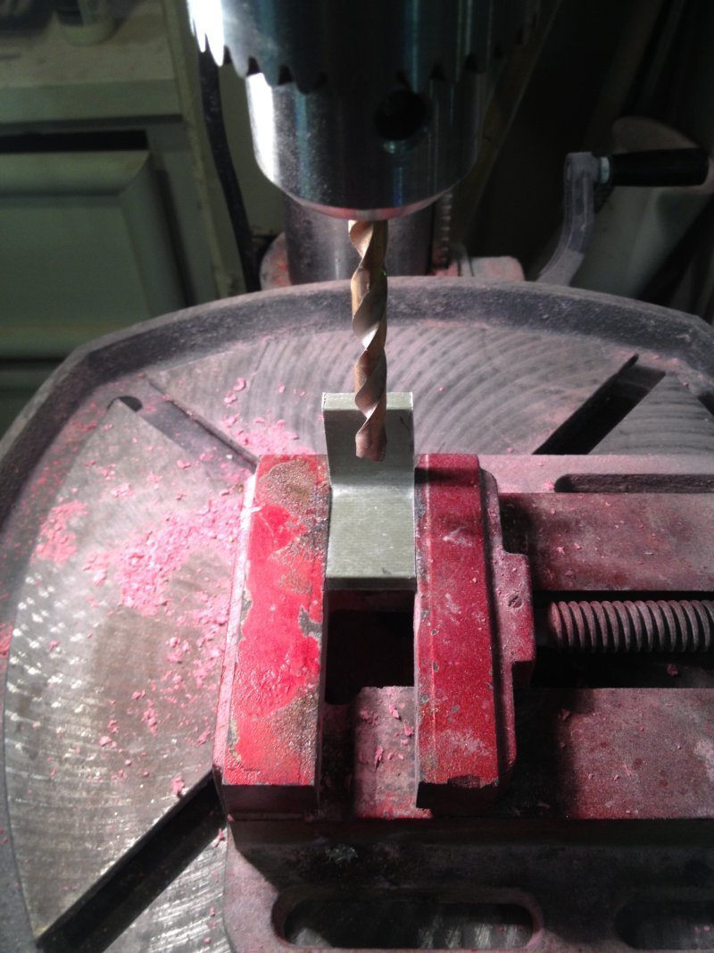

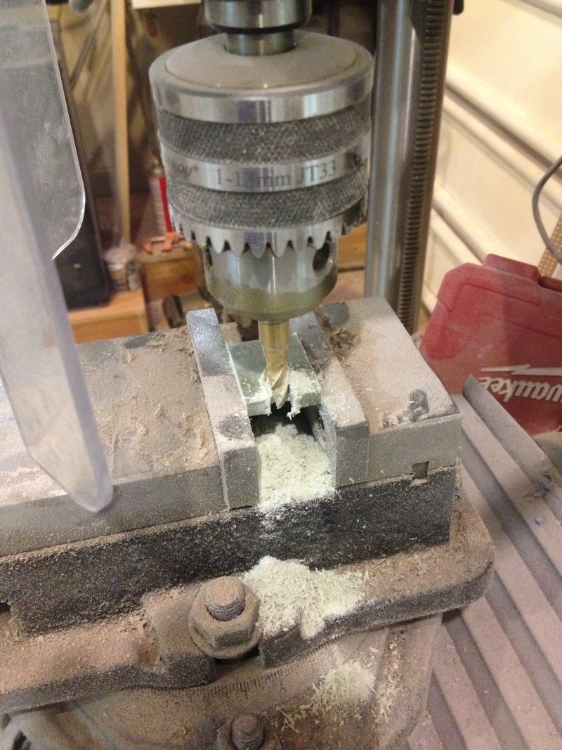

  20. Lou
    Making new solenoid holders, first creating the slot in the fiberglass angle.
