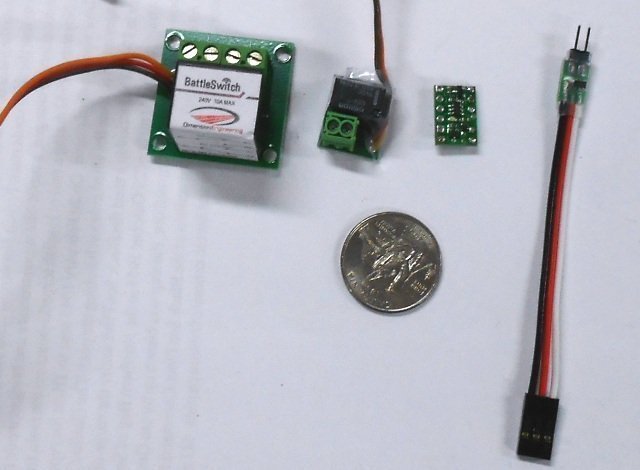

    From left to right:
    Dimension Engineering Battle Switch, their Pico Switch, Pololu 3A board, and Hansen Hobbies NERS 1.2A switch
    And to add a twist to what Tugboat said, the switch rating is for continuous use. The switch can carry more load if only used briefly, like when firing a gun solenoid.
