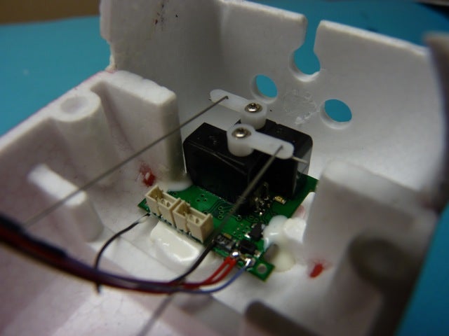

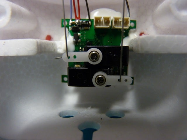

    For those of you looking to build a PT boat, I may have discovered a way to do it. Flyzone Planes makes a series of ultra-micro WWI planes. They include with each one a 2.4ghz "brick" receiver, which includes a couple of built-in servos and a built-in ESC. Unlike many other ultra-micro bricks, the Flyzone receiver board includes proper radial servos, instead of those flimsy linear contraptions. The ESC is for an airplane, so it is non-reversible. However, you can use that motor for a pager motor bilge pump and plug a reversible ESC into one of the two open servo slots.
    Here's a couple pictures:
    I don't have one yet, but I am seriously considering getting one of their planes. If I wreck it, I'll salvage the board and hack the servos for use in my Santa Maria micro-galleon.
