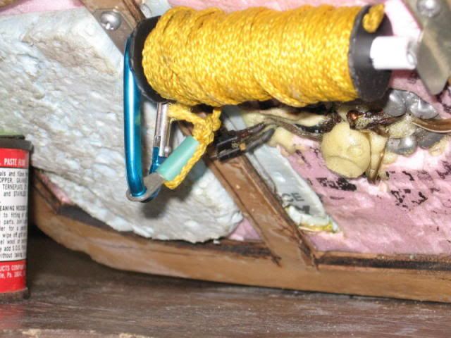

    I use my whole superstructure as a float. It has only failed once when I tangled the line. It clips to the main ship somewhere strong and lowers the ship down.

    the superstructure is recessed into the deck and I have pins on 4 corners, it won't fall off but lifts off easily

    the recessing allows for a silicone gasket (semi waterproofing but whatever helps...)

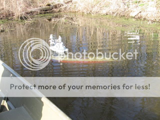

    Did anyones float deploy this weekend at Rob's? I know Bill's on his VU did not even after a couple of sinks, she rolled over both times. Gingers deck came off and floated free of her NC, but did not have the line attached.
  12. SnipeHunter
    I'm pretty sure when Rob A.'s Bismarck sank on Friday the super came off with the line attached to the hull as designed. Just didn't need to use it cause the pond isn't that deep. His system works pretty well.

  14. rarena
    The float deployed as designed and we were able to recover the boat by pulling it to us with the string. It recovered so quick, most were unaware that it happened.
