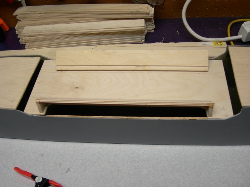

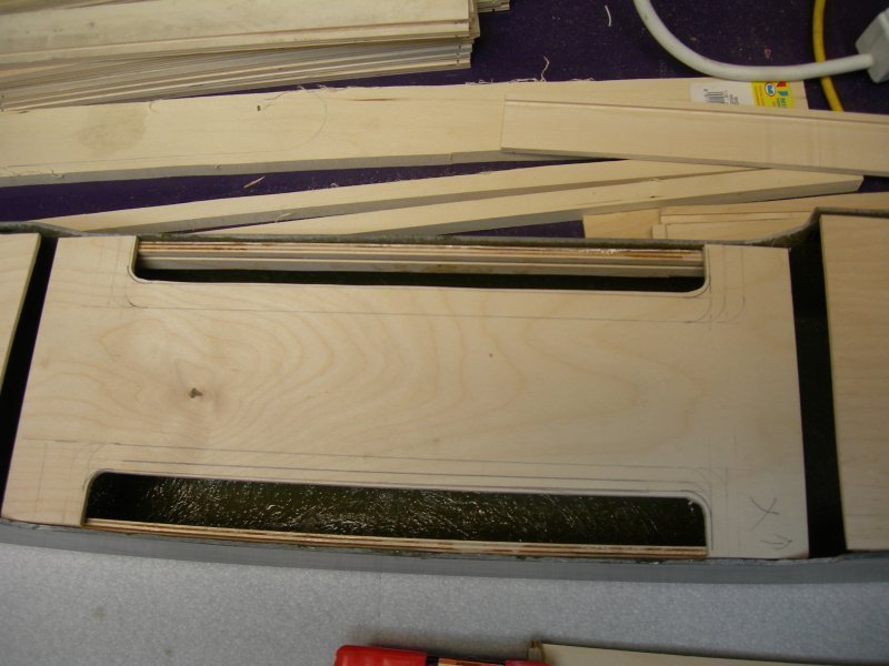

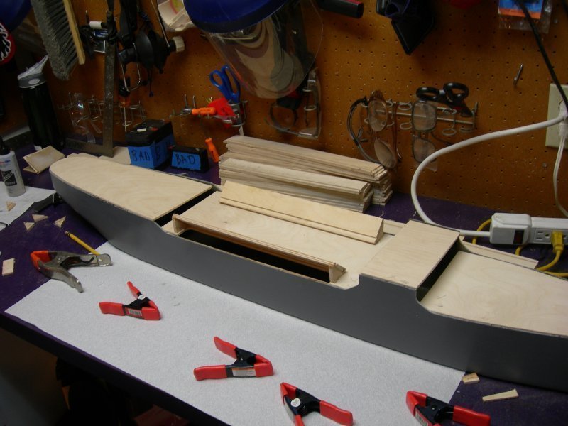

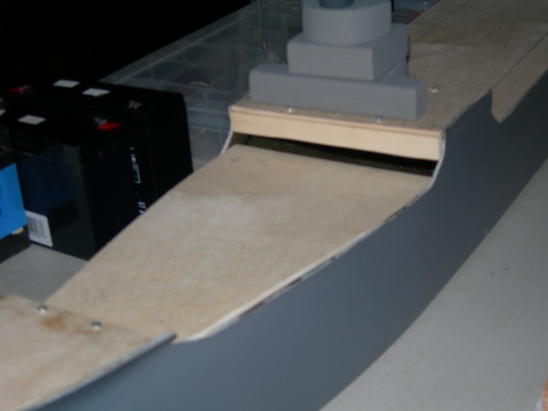

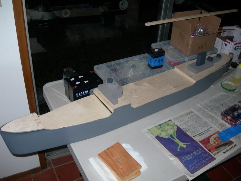

    below are a couple quick picks.....aww amid ship....idea for a opeing for water to be deflected down into the hull, deck not cut out yet to create opening to hull....starting point
    ,[​IMG]
    .[​IMG]

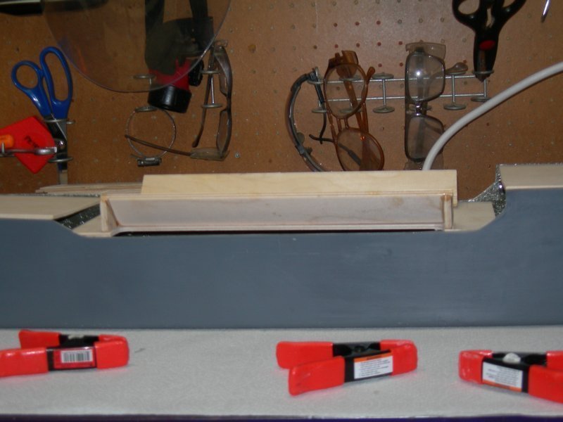

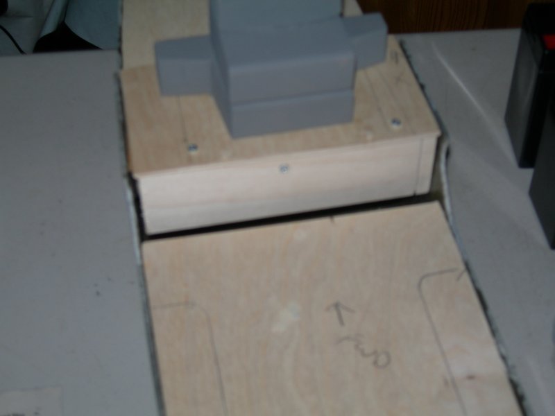

    picks of the build. opening amid ship. 1 inch by 10 inch. both sides to start off with
    .[​IMG]

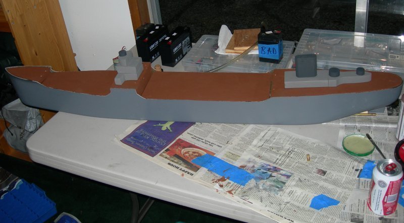

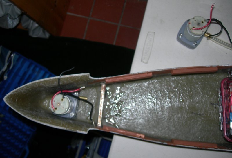

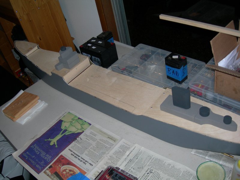

    new pics of ship in work...changes....water cannon to come
    .[​IMG]
    .[​IMG]

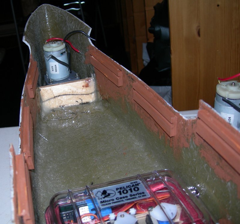

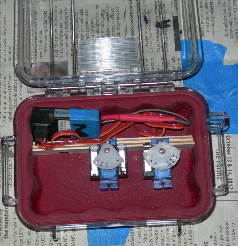

    contin[​IMG]
    continued work...added bulkhead, turning bildge pump in to water cannon. penetartion in hull to fill cavity with water to come
    .[​IMG]
