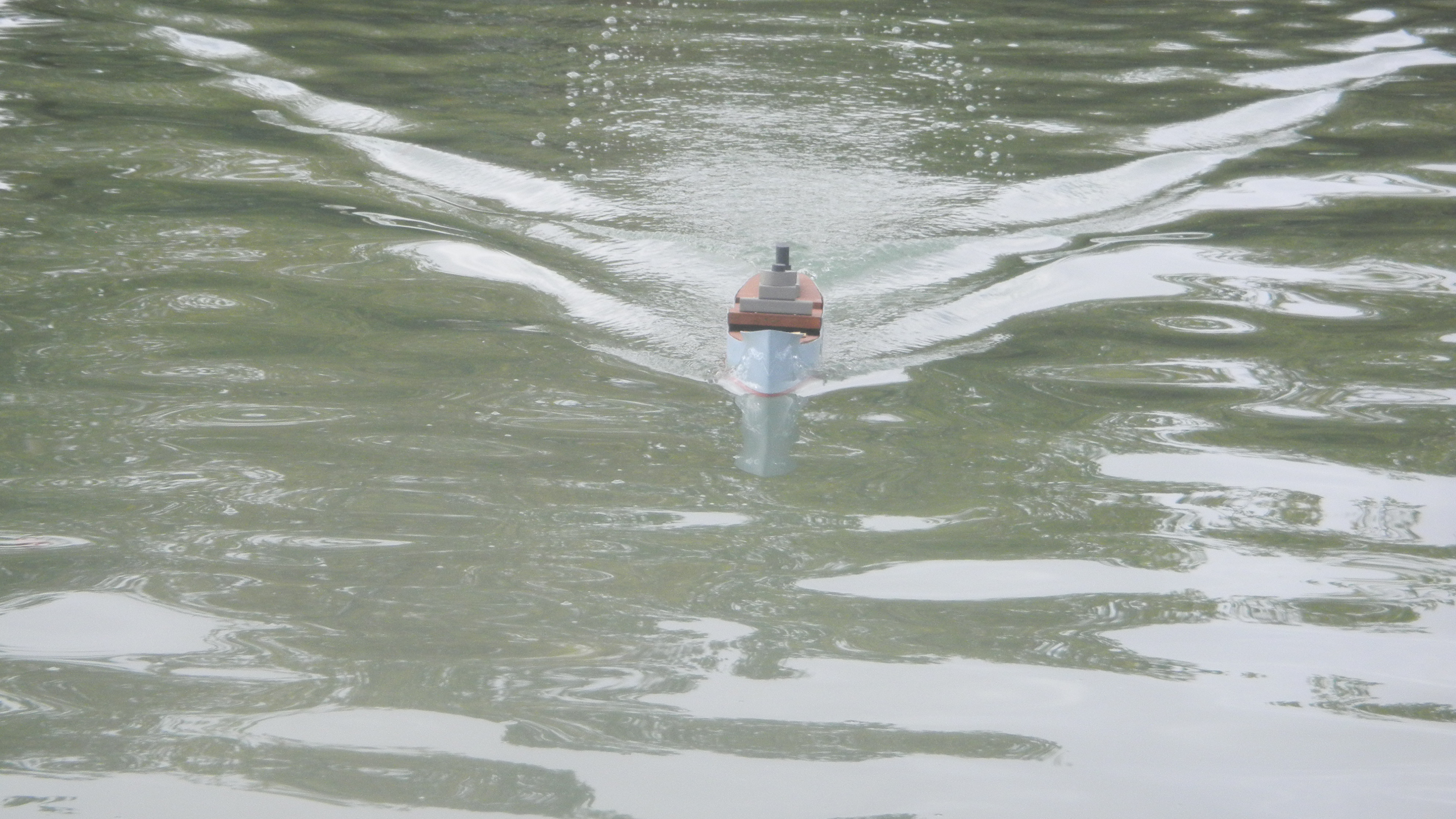

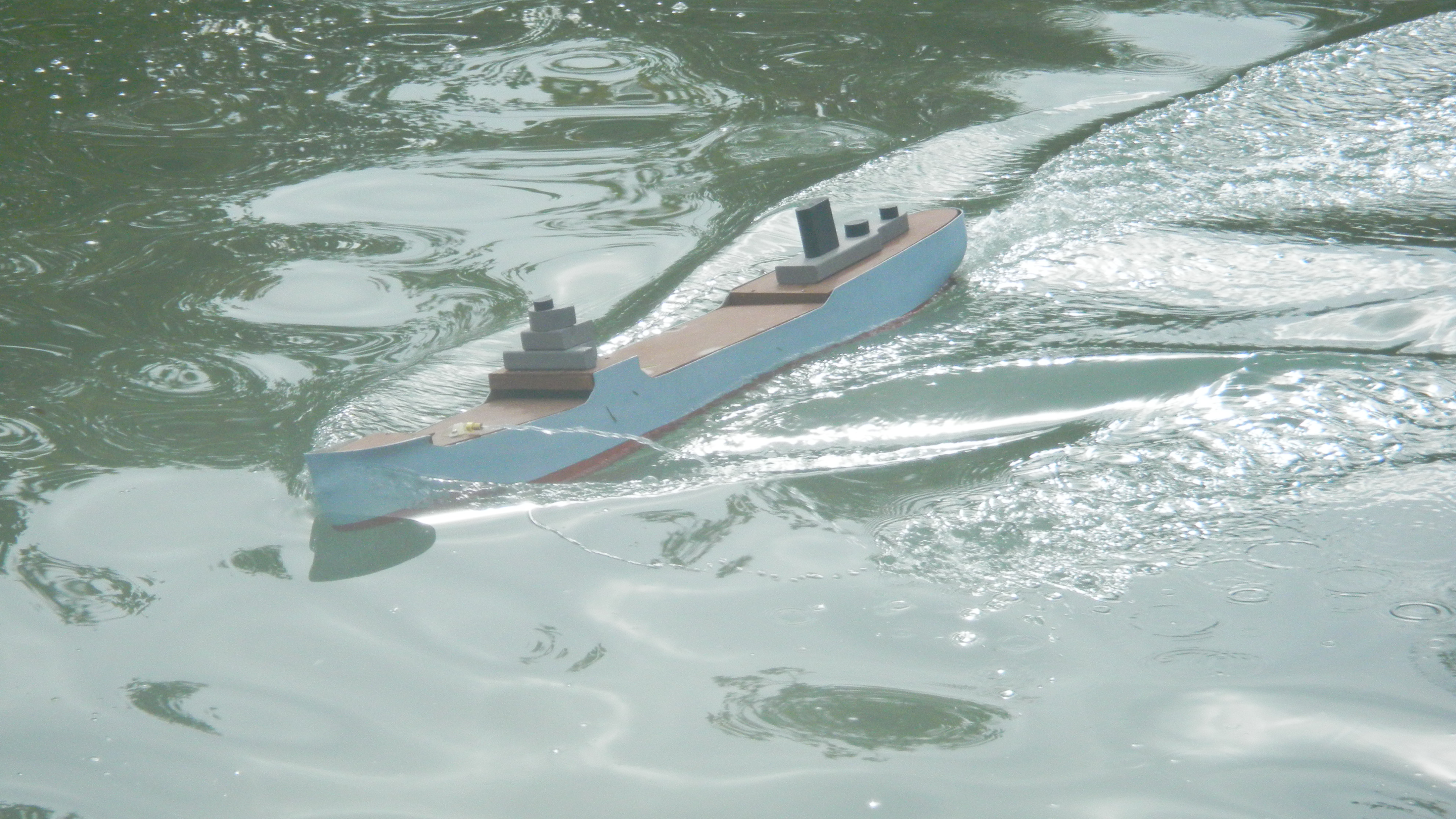

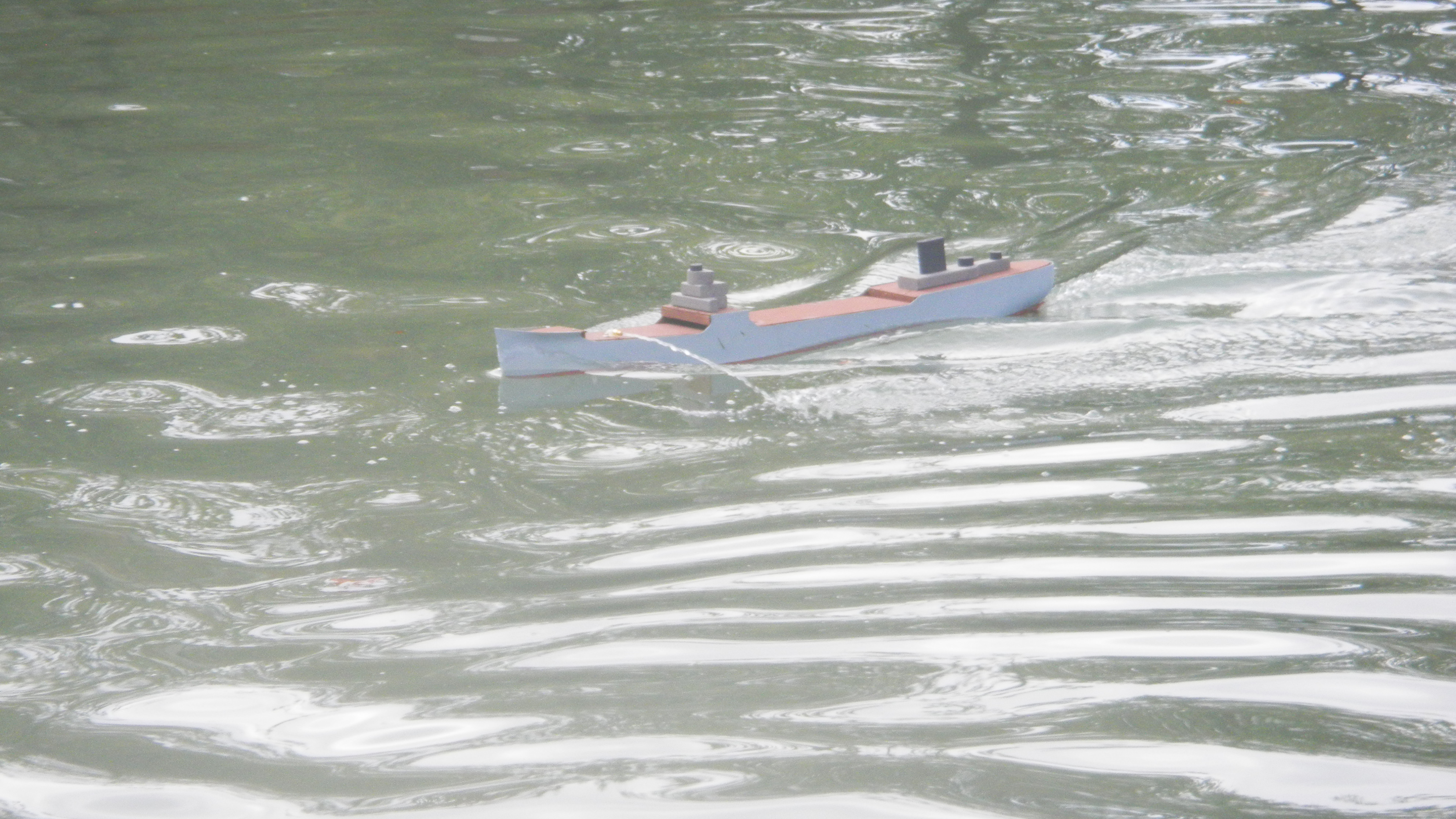

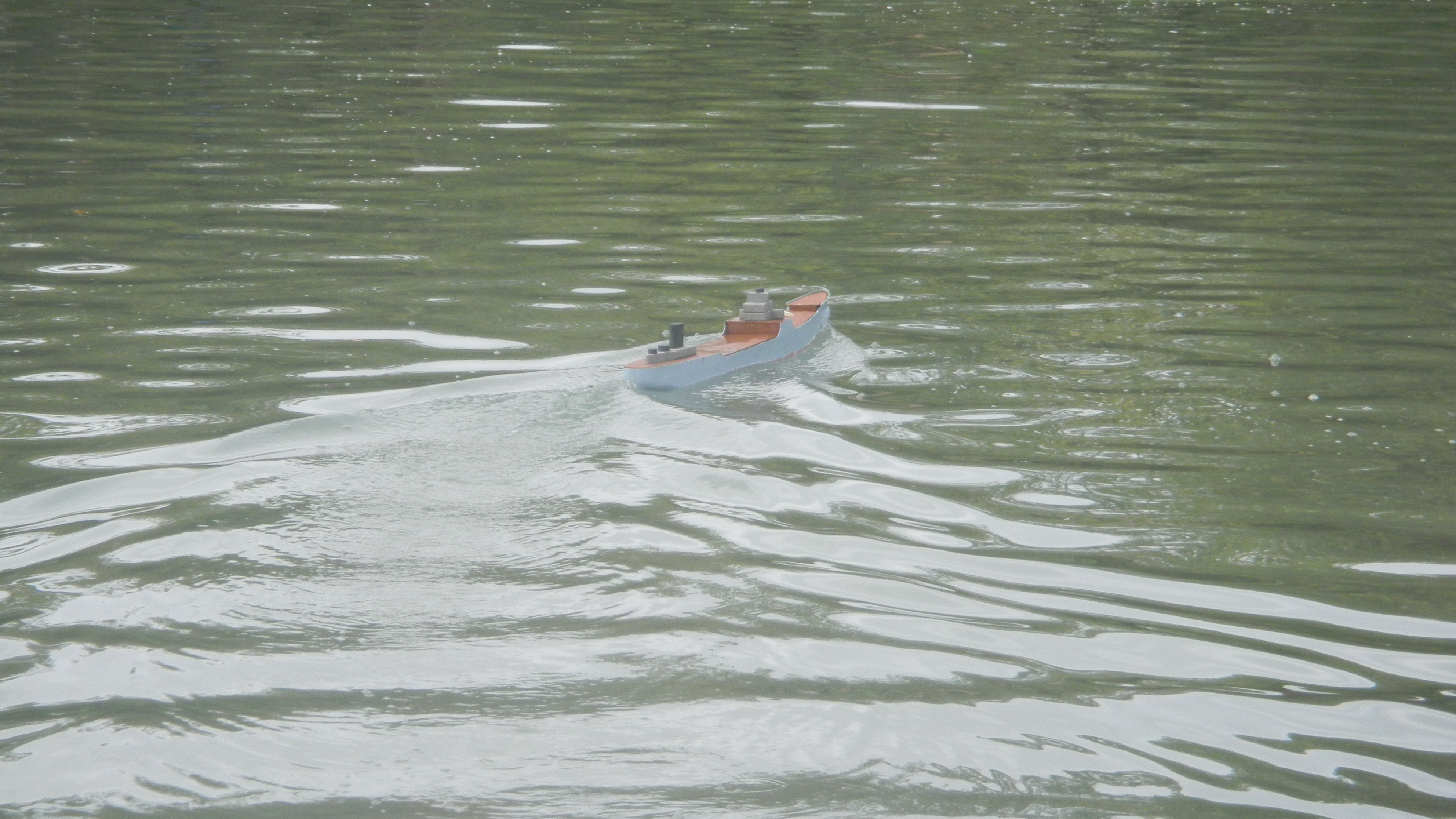

    some pictures:confused:
    .[​IMG]
    ,[​IMG]
    ,[​IMG]
    ,[​IMG]

    The boat kit was purchased from battler’s connection for about $200 I think, few years back. The deck and super structure is wood and stuff I already had. You still have to buy speed controller, wire, etc...Have a transmitter and receiver. The bilge pump used for cannon will not work that is shown in the pictures. Going to purchase pump and stuff from harbor models that is used for water cannons on fire boat. So still probably adds up to much, go get people in for cheap. Probably around $400 for all and you still have to do the work and figure out how to do it.

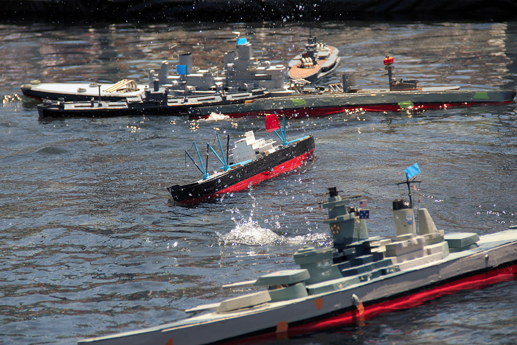

    The red, black and white cargo ship in the center of the photo below is one of our loaner ships in battle at the California Maker Faire this year.
