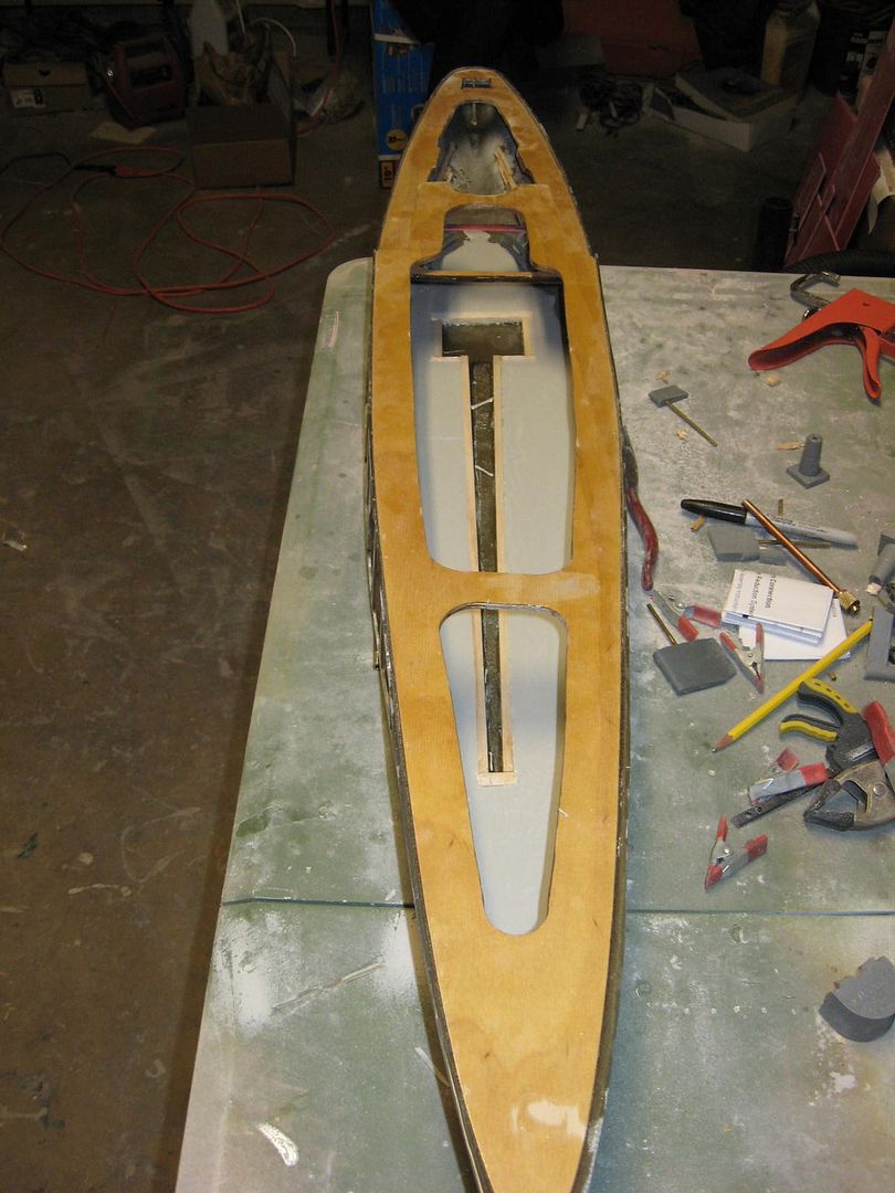

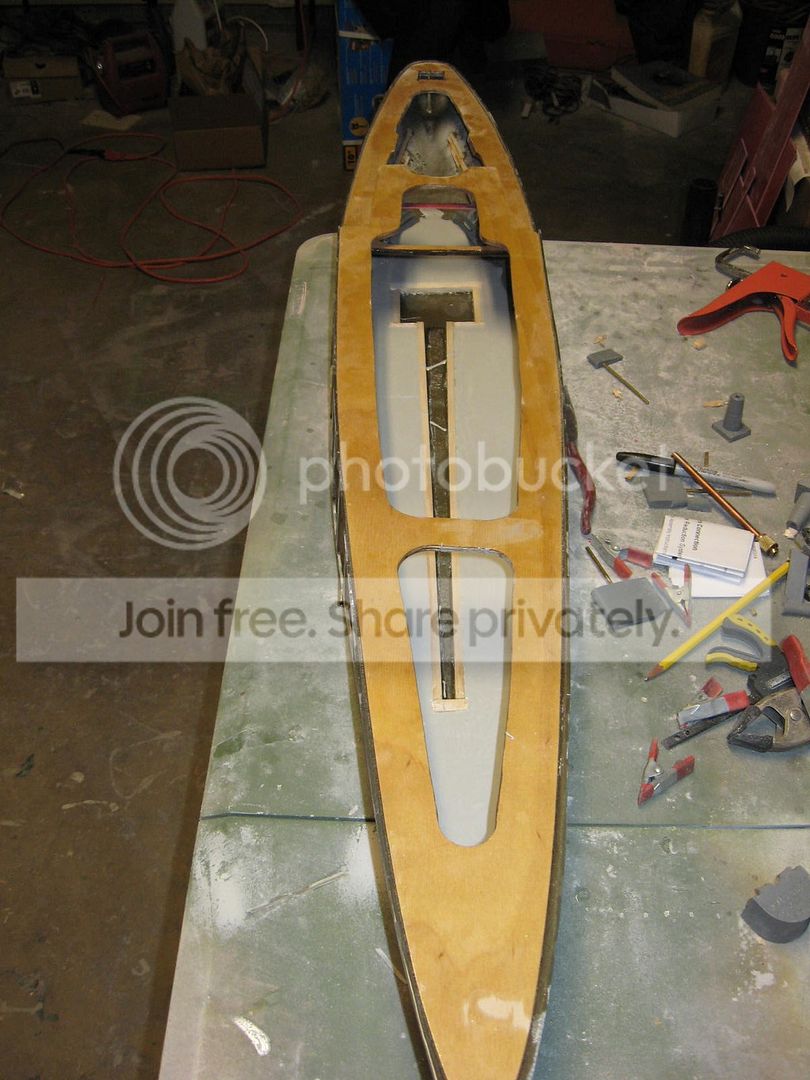

    It begins! Getting the subdeck in.

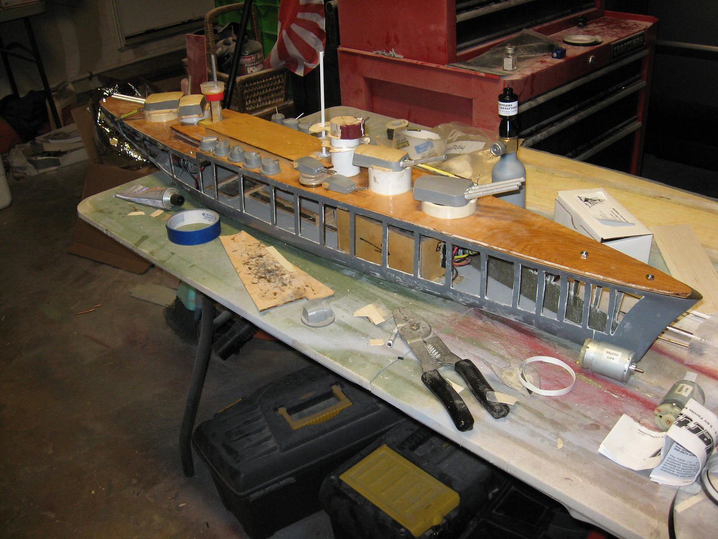

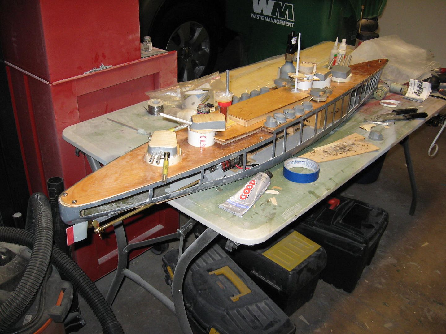

    More work this morning after work. Decks trimmed to fit and guns mounted. Up next is some superstructure (which I'm not looking forward to) and driveline.

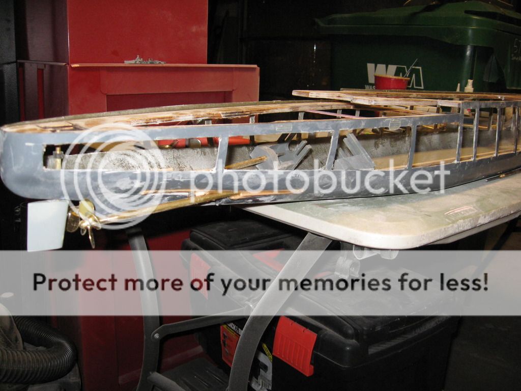

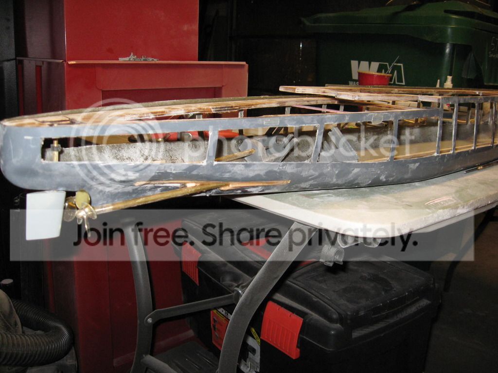

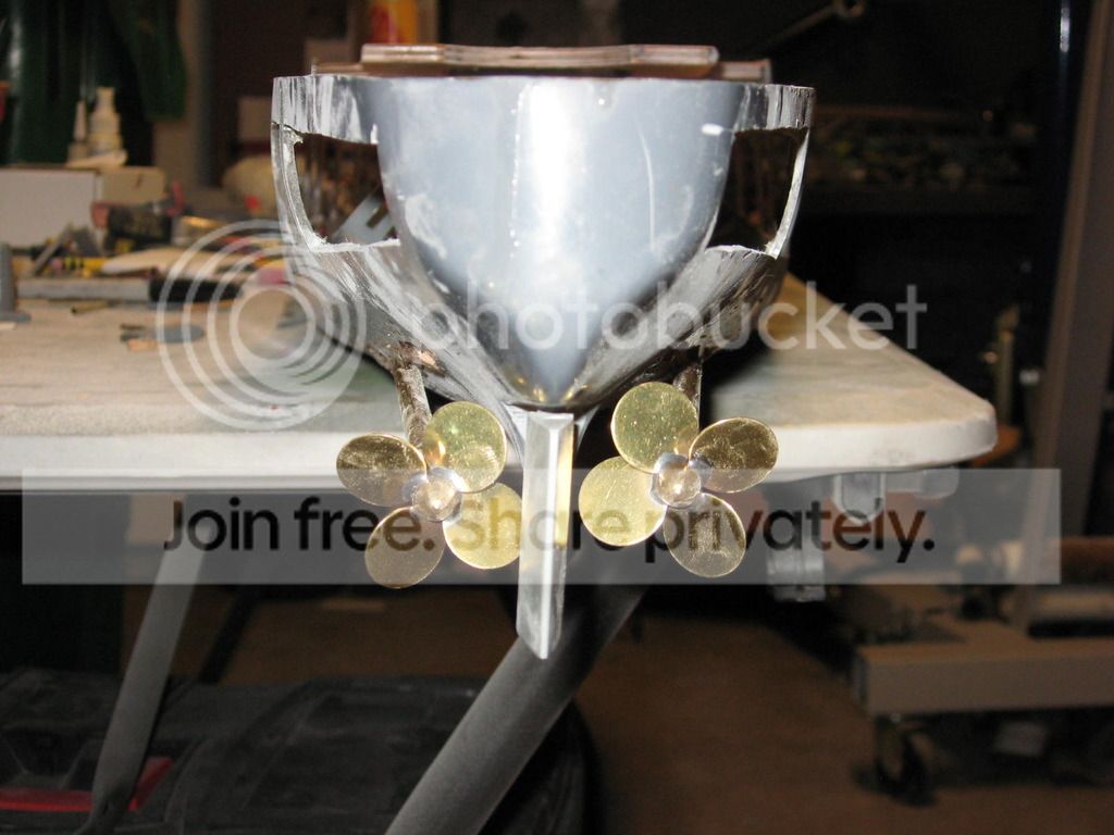

    More progress on the Italian slugger. Got the rudder post, shafts, and gearboxes in. Started the water channel. Yes, yes, I know everyone hates the concrete sealant. I love the stuff (when used in moderation) to get a nice level base going. I'm sure using a lightweight something would be technically better, but I like having a chunk of weight right at the bottom of the ship. I've got the weight to spare so why not. Ordered a set of paper plans from Profile Morskie so I can start in on the super.
  8. thegeek
    It had two rudders in tandem just like the others (Doria, JC, Cavour, and the one that explodes Leonardo), you also get a area bonus of 50% with two.

  10. Renodemona
    I know, building my own rudder set off a spare I had around that I liked. Just needed to get the shafts aligned for now. I'll put the stub rudder in once the sealant dries up.
  11. thegeek
    You have to make both shafts turn, but you don't have to have a real rudder on the small stub shaft. I still turns real slow but with some rudder tricks it could be almost competitive. Make the rudder really thick on the forward part to provide some added brake to forwards, with a really nice fishtale on the backend.
    Doria was my first, and you always love your first, really nice looking boat. The camo on these Italian boats are works of art.
  12. Bob
    If it works like my Goben or Tyler's Derf you should be able to turn slightly "drift" in reverse. Handy when trying to back down on someone or chasing them in reverse.

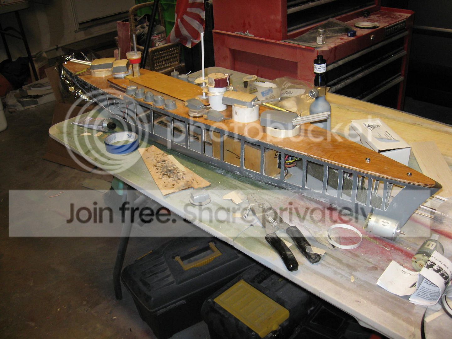

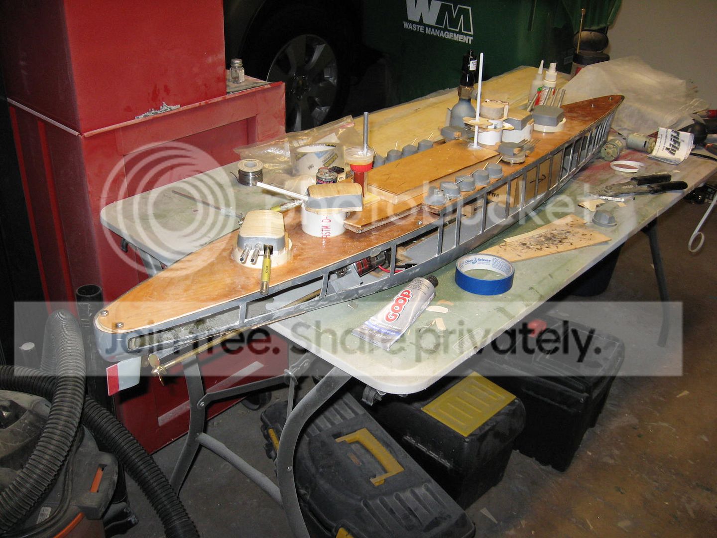

  15. Renodemona
    Superstructure time! Oh how I like and dislike it at the same time...
    Thanks to the Italians' love of circles and random ovals for superstructure I've used a pretty large variety of stuff in the build so far. Rubber hose, aluminum tube, plastic tube, balsa wood, pvc in several sizes, soda caps, gatoraide caps, and Duct Tape. Should look a lot nicer once paint goes on.

  16. Renodemona
    Forward tower completed minus detailing like railings, windows, small mast parts, rangefinder end plates, etc.
    In the tower I used numerous sizes of Balsa, PVC pipe in several sizes, soda caps, WD40 cap, rubber grommet from the Jeep's old spring bushings, Duct tape, and some plastic tube. Good times!
