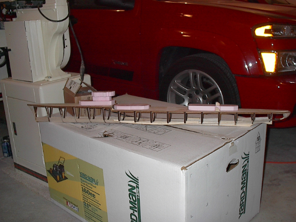

    This is a shot of the sanded balsa bottom, via insperation from Mike's Bearn:
    The few ribs that don't have any between them yet were left empty for easier access while the running gear is installed, then they will get balsa blocks between them also.

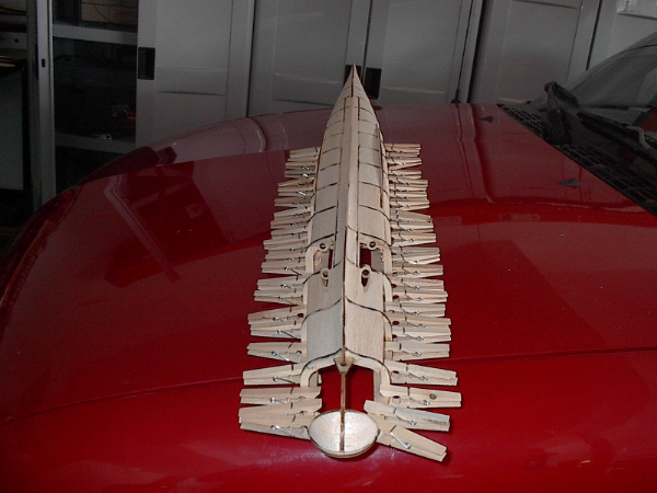

    The multitude of clothes pins are holding on the outer portion of the deck. I strayed from the plans and cut a narrow margin from around the decks, then glued them to the ship. The plan was to help the decks fit, and locate better. It seems to be to my liking so far.

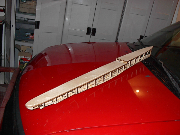

    Here is a shot with the decks installed. I'm planning on using imbedded magnets to hold the decks on.

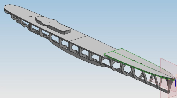

    Back to business for a moment. I'm going to split the aft deck to make it more managable both for printing and building; does anybody have any suggested locations (in terms of rib number) where they think would be a good place to locate the joint(s)?
    Here's an updated screencap of what I have in mind so far:

    I'm guessing this post has been hanging hear so long because it is dependent on the drive system and armaments. For a big gun first ship I assume it would have the 6 torpedo tube between the 2 cabins. so that section of deck would be separate. The accumulator would point aft so the pump could go under the forward lower cabin to keep it as close to the center of the ship as possible. CO2 tank in front of the Pump. The motor batteries and speed controller would go under the aft cabin. It would be nice to have the rear cabin and side decks come off as one piece. If possible all the rest of the superstructure up to the turrets, including the step would make up the next access cover would come off to to get at the gas bottle, valves, and pump.
    Kotori87 mentioned leaving a rim of deck for positive centering. What would you think about using the cut out center of the subdeck and gluing it on the bottom of the deck material instead?
    I probably have this all wrong. At least it's a starting place for discussion.
    Terry

    Not just the drive system and armaments. It's also dependent on the size of wood that a laser cutter can handle. The places I know of, including www.customlasercutting.com and TechShop, can handle materials up to 18"x24". Anything bigger has to be done in multiple parts.
    Do we have a rough guesstimate of the total cutting inches involved?

    It may just be my limited familiarity with that function of the software but it seems that I manage to crash the program[B)] every time I attempt to persuade it to tell me how many inches of cutting that a laser or waterjet would need to cut. In short, I can only say "quite a bit."
    I'm hoping to have a chance to work on the design some more this weekend; my employer is going through a growth spurt so the workload has been increasing (despite hiring nearly constantly ever since I started the new job).
    Main goals at this point from my end are as follows:
    1. Re-proportion parts so that as many as possible will fit on 8.5x11 or 8.5x14 sheets and re-publish in that format
    2. Incorporate refinements based upon feedback from everybody who's already been building one
    3. integrate mounting locations for electric motors/gearboxes once a brief list of suitable combinations of components has been determined that are readily available off-the-shelf.

  20. Cannonman
