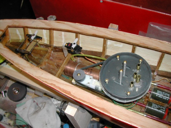

  9. crzyhawk
    I had a rotate in my Courageous that was very reliable. I had it set up for 2 position left or right fire since I didnt want to deal with adjusting or aiming it. I just flipped a switch and it went from about 45 degrees right to 45 degrees left.
    It was a pretty simple design (which I can't take credit for; it was installed when I bought the ship. I think it's Bob Pottle's design originally) The gun was attached to a round plastic mount which sat inside the barbette. There was center rod that acted as a pivot and sat in a "cup" if you will at the bottom that allowed the center rod to move freely back in forth and keep the mount within the barbette which provided the support. A piece of linkage was connected from the center rod to a servo attached to the hull. The servo is what controlled the position of the gun. The gun used was a coil magazine gun.
    This set up was extrememly reliable. I never had it bind or jam in any way. the mount still exists, although for the time being I have removed the rotate servo and have fixed the gun in place since I originally intended to change her to 2 sidemounts for IRCWCC service. With the advent of the treaty system however, I will eventually set up the rear turret as a rotate as well and enable both guns to switch quadrants as necessary. Its my intention to set her up with a left/right system again, but if one sidemount is facing left, the other will automatically face right and so forth, to eliminate any possibility of having both guns in the same quadrant at the same time.

  10. Jay Jennings
    Crzyhawk, could you possibly post some pics of that set up please. I am interrested in a rotate and haven't found too much online.

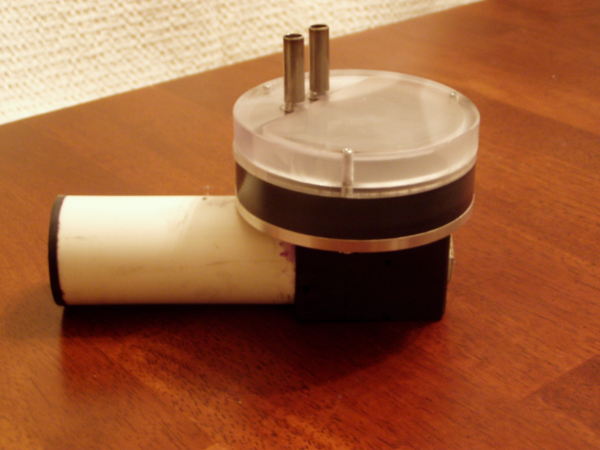

    Just an idea, but why don't you use an "Indiana Cannon" like they use in Big Gun. These rotate and would work perfectly. I'm planning on installing one once I get my Heavy Cruser up and running.
    BDE sells the one below
    http://www.bderc.com/products/page4.html
    Here is another photo of an Indiana Cannon
  13. GregMcFadden
    the problem with the big gun cannons is that they can not fire as fast as the fast guns will in fast gun. If you are not trying to fire faster than the big gun firing rate limits, they work great.
