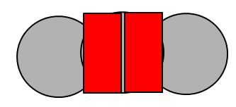

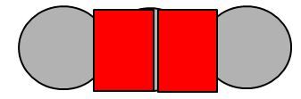

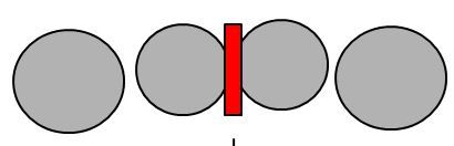

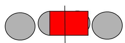

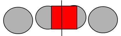

    Let’s see what the rudder options would look like for a class 5 ship.
    A class 5 ship is allowed 3” of rudder. Multi rudder ships are allowed a 1.5 rudder bonus or 4.5” of rudder. In our hobby, our boat turn due to prop wash over the rudder, so the more prop wash you can direct the better your boat will turn.
    Single Rudder = 3” rudder
    Dual in line = 4.5” rudder
    Dual = 2 X 2.25 “ rudders
    Drag Disks are allowed in our hobby, and are placed on non running props. For the sake of argument I will assume drag disks in place of “super reverse”.
    Since I do not have access to cool drafting software, you have to make do with my cartoon drawings. Any of you engineer types who would like to jump in and SHOW why I am wrong. Please do.

    First let’s look at single rudder ships
    Why do we hate American ships?
    First thing to note is that you are limited to 1.5” props. There is no chance of covering 1.75” props with that silly little rudder.
    We then look at “in line rudder”
    It looks much better on a 1.5” prop but will still have difficulty covering 1.75”
    Now for dual rudders The vectoring does a fair job covering the 1.75 props.
    Most interesting is the single prop. With dual rudders
    Dual 1.75” props cover a width of 3.625”. A single prop is only 1.75” this is easily covered by dual props. It even easily allow a 2” prop with better coverage that dual props gets with 1.75” props.
