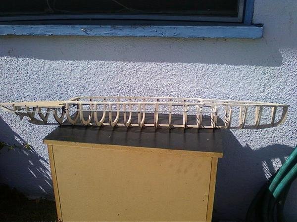

    RE: "The Cheapest Point of Entry"
    here [​IMG]

    RE: "The Cheapest Point of Entry" the stern subdeck and stringers are temp.

    RE: "The Cheapest Point of Entry" Looks like she is hogging a bit.
  10. Tugboat
    RE: "The Cheapest Point of Entry" Hey, who doesn't occasionally go out and chase the big ones? ;)
    We will be addressing the hogging... the forward keels actually need to come UP to the forward subdeck. This will happen while we glue the playwood scraps to the sides of the vertical part of the forward keel. Not sure why it came out that way, but mine did as well. I'm looking at the keel on the plans (which I need to post for the next lesson on casements), which we used to draw our forward keels. We shall see. But it's not a big deal. Most errors in wood can be corrected pretty easily. The ones that can't are ugly!

    The wood, design, subdeck curvature, etc can cause that. If you used a 1/4" subdeck, then you can lay it upside down (if a flat deck), weight it flat, and add 1/8" strips of wood to the underside of the subdeck between each rib. That will help stiffen the sub deck. Another trick is to weight it down then install some of the hull bottom. That stiffen the entire frame and resists the frame bowing.
    That is why I like building ships upside down. To keep weight on the hull while I stiffen it up with subdeck doublers and /or hull bottom material.

    yes ill fix that tomorrow at work

    RE: "The Cheapest Point of Entry" From the plans, the deck at the bow has a slight upward slant. As mine sits, the deck is fine, but the top of the foward keel does not quite reach. I am supposing that this is because it could be glued to the main keel at a slight down angle. It would only take a few degrees to make the change. Easy fix is: when we glue the wood on for the solid area, span the distance between the forward keel and the subdeck. Or, fracture the epoxy holding the forward keel to the main keel, and glue the top of the forward keel to the subdeck, which will set the angle. Then, reglue the two keels together.
    If you haven't glued the stern subdeck yet, don't worry about fixing the hog on that end.
