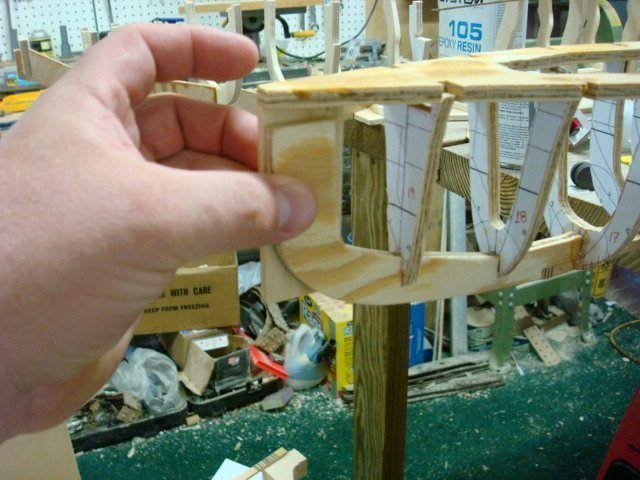

    First, get some small scraps of wood and a pencil or sharpie or something. Hardcore Axis captains can prick their fingers and use blood. Hold one of the scraps with a flat edge up against the bottom of the subdeck like below. Note that gap we mentioned before, that is going to be fixed while we do this.

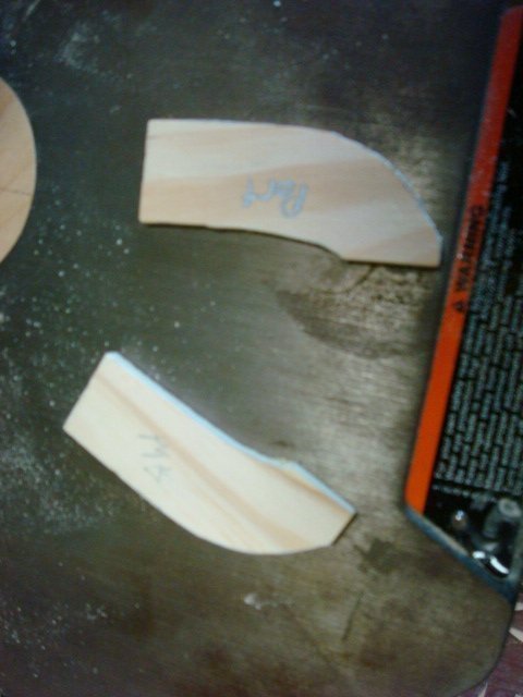

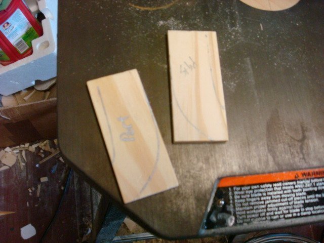

    Now, trace around the front, back, and bottom edges of the keel there. I labelled mine port and stbd, just to be silly. They should be the same shape, unless you sanded something funny on the keel. Und ve are NOT to be being mit der funny, are ve, mein schnitzelchens?!?
    Now, using your saw, cut those out (probably didn't need the pic to illustrate, but what the hey? :)

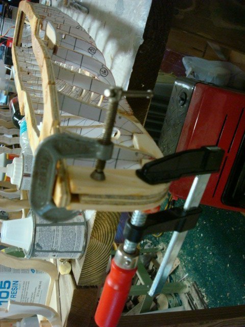

    Zo! Before you mix your waterproof epoxy, make sure that you have 3 small clamps ready to go! 2 for the bow, because it wants a clamp top and bottom, and 1 for the stern (it's smaller). Don't forget to put epoxyon top of the scrap pieces!
