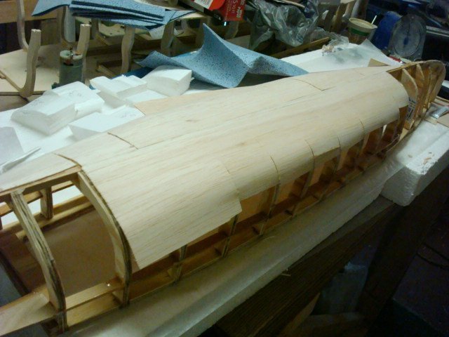

    @ everyone - I have been out in the shop getting naughty with thin balsa and CA glue. The port side solid area is 'planked' at the moment with the balsa sheet, and will shortly be receiving a few layers of fiberglass after I plank the stbd solid area, too! Balsa is not as good as 1/64" ply, but it'll do fine with fiberglass and epoxy. Looks SWEET! Pics to follow :)

    A preview of the upcoming lesson on planking the bottom of your boat...
    I started with styrofoam, cut with a hot-wire cutter, but then I realized that not everyone has one of those, and it'd be something else to buy. So I'm doing the old 'cover it in balsa and 'glass it' method.

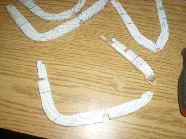

    RE: "The Cheapest Point of Entry"
    hey to work on my ship today here are a few pics
    me at work​
    heres rib 12 the snapped well being cut. a little crazy glue and good to go
    note i havent fully finishing cutting the ribs in pic
    RE: "The Cheapest Point of Entry" Don't worry about the snapped rib, Lance... after it's all assembled, that area will be heavily reinforced anyway! Makes me happy to see progress :)
