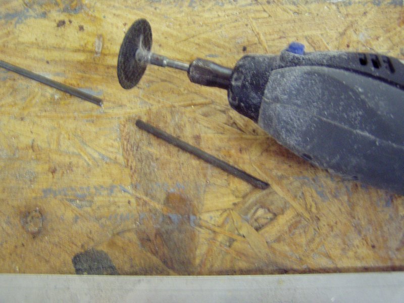

    The first part we will be making is the rudder shaft. Take a piece of 1/8" steel or brass round rod, and using your dremel (or hacksaw)(or teeth), cut a 3" long section of it.

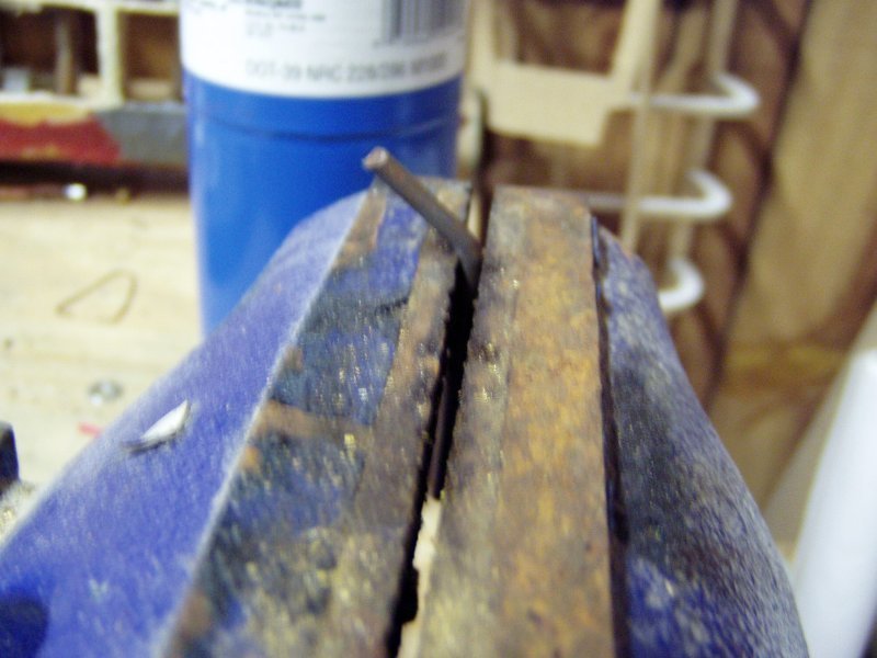

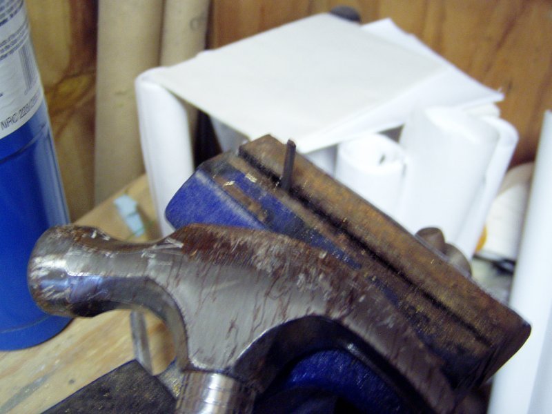

    Next, put it in your vice, with about 1/2" to 3/4" sticking up from the jaws... and get your hammer.
    Hit the exposed shaft repeatedly with the hammer so that it bends to about a 45 degree angle.

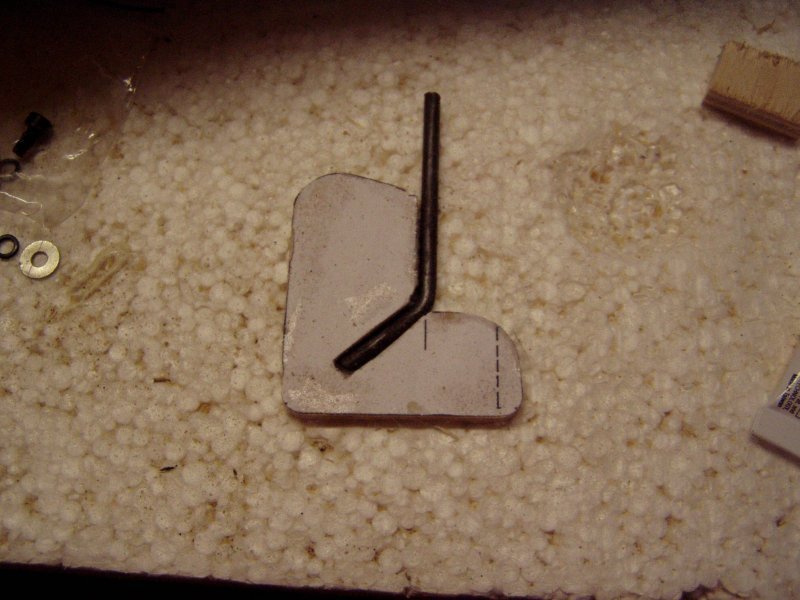

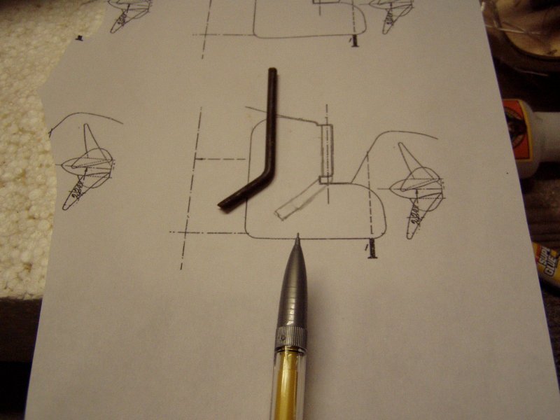

    Lay the shaft over one of the rudder drawings and trace the part where the rod bends into the rudder, as seen below.

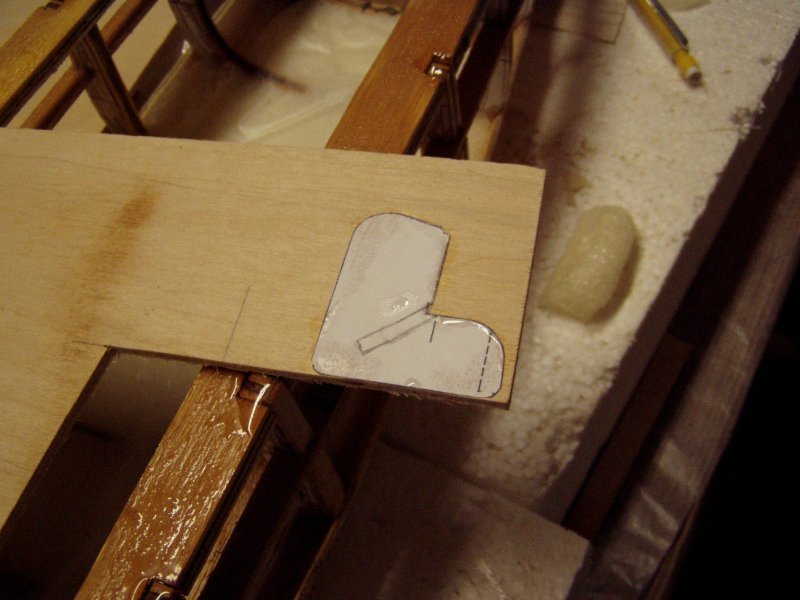

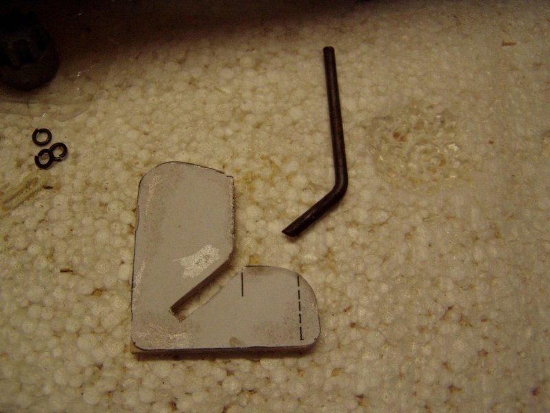

    Glue the drawing to some 1/8" scrap, and cut the rudder out with your saw!
    Should look all pretty like so!

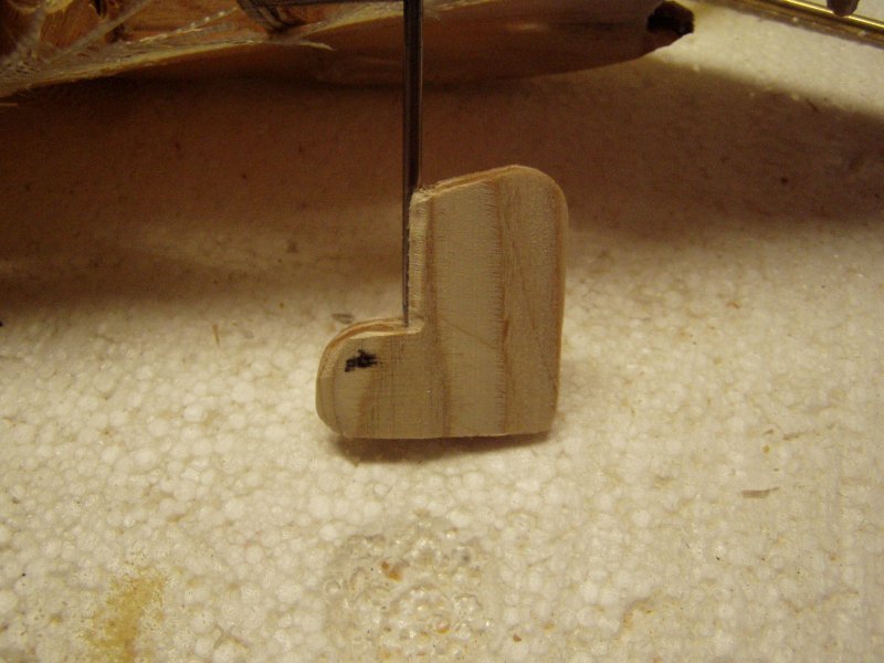

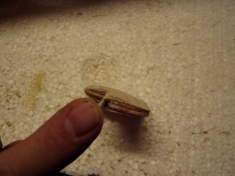

    Cut out two more rudder-shaped pieces of wood, and glue the whole mess together so it looks.... like a rudder! (as seen below). I have done a little sanding on it in this pic. We will be rounding the front and the back into an airfoil shape. Also note that the area right around the shaft has been sanded; this will allow more rudder travel (when combined with some sanding on the back of the rudder skeg (the part of the keel that sticks down in back)
    A top view. GAH! Where'd all the dirt under my fingernail come from!?!?

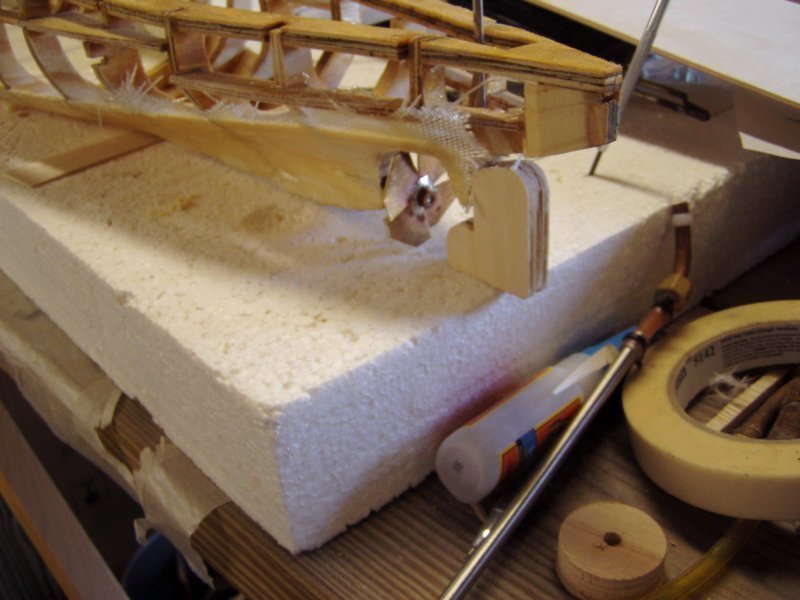

    This slightly fuzzy pic below shows the primitive unshaped rudder being test-fit on the hull. The small piece sticking down in front of the rudder is the rudder skeg. You can also see a preview of the prop we'll be making very shortly. You DO have your blowtorch, 1/8" wheel collars, and .040" brass sheet, right? right?
