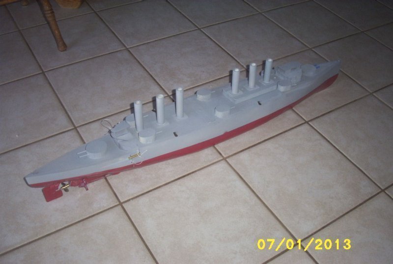

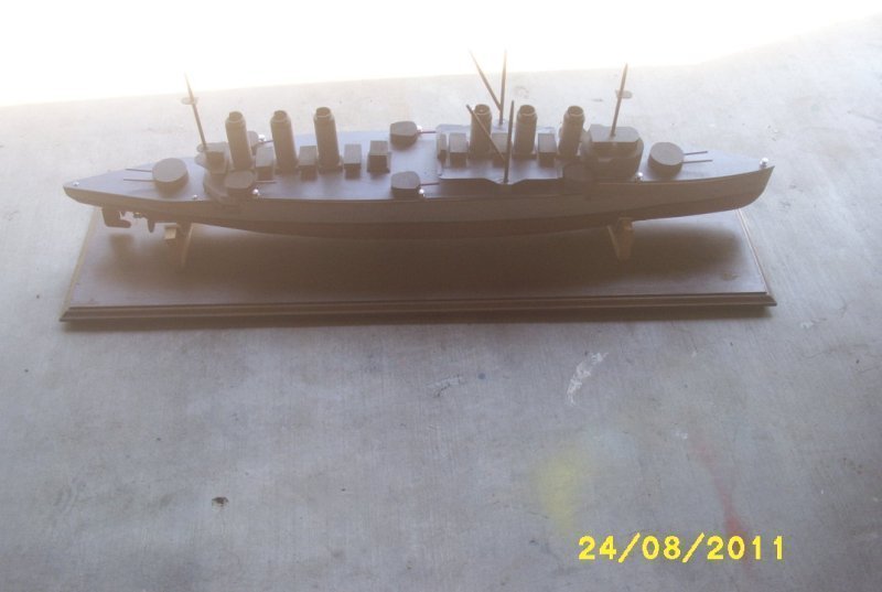

  18. ship crazy
    ship crazy Active Member
    Dec 1, 2009
    309
    Completed EQ's
  19. NickMyers
    Ooo, more pics pls, lets see inside?
