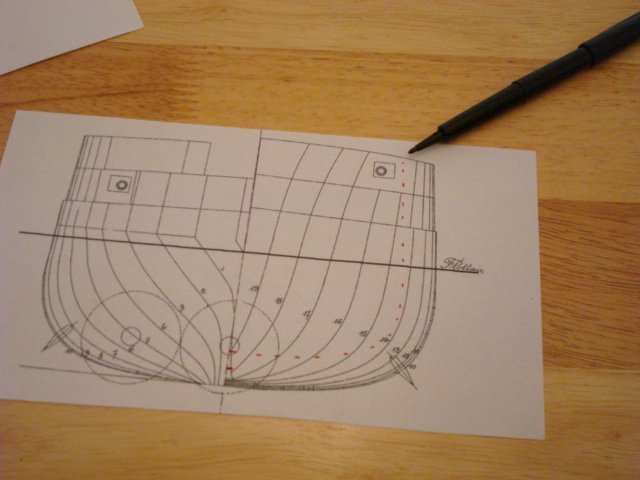

    the fins on the bottom side of the hull, how would u add those in the the construction? notch the frame? if so which ribs? and how far in
  14. NickMyers
    bilge keels. probably leave them off honestly
  15. Lou
    If you want to see what if anything they do, wait and build the hull without them. Then get some right angle plastic from the hobby shop and glue it to the hull. You can experiment by gluing on flat plastic in different widths to see if it does anything.
  16. Kotori87
    bilge keels slow down the rate of roll, if your ship is unstable. They do *not* reduce your maximum list, only the rate at which your ship swings back and forth like a pendulum. They are usually not included on larger, flat-bottomed ships like battleships because those don't rock much, but round-bottomed ships like cruisers and destroyers can benefit if you are unable to reduce top-weight any more. Also, scale size bilge keels are too small to do much on a 1:144 scale warship, but double scale provides a very noticeable improvement. The one example I saw, a guy cut his ship's natural rolling frequency in half by gluing balsa wood bilge keels on, turning his torpedo-cruiser into a usable warship.
    In summary, your ship almost certainly doesn't need bilge keels., but you can always add them later if you really want.
