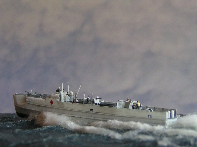

    For those who are unfamiliar with the clean lines of the Schnellboot (literally, Fast boat):
