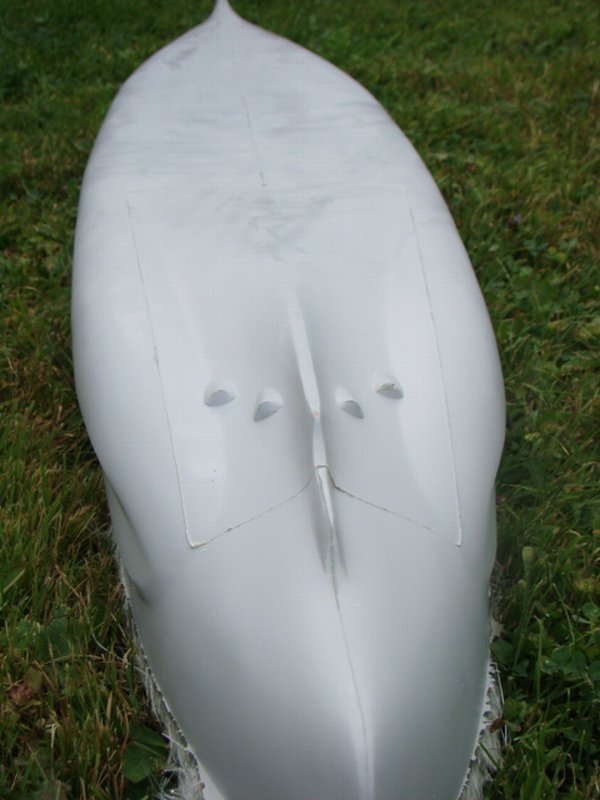

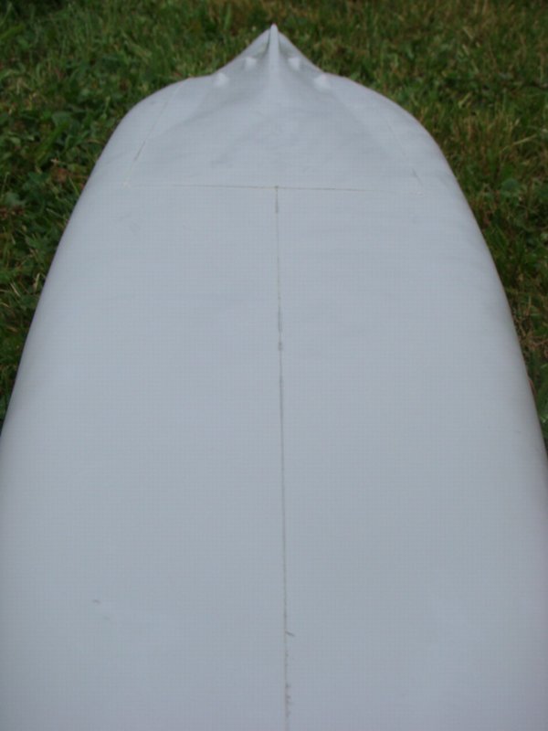

    A few weeks ago Ralph Coles decided to make the QE/Valiant mold a 3-piece vs 2. He was concerned that the extra detail under the stern would cause mold release problems, with a 2-piece mold getting caught on the 4 prop outlets and grooves on the underside of the bulges where they meet the hull.
    One of the two main 'halves' of the mold was laid up yesterday and the other large piece and the 3rd piece for the underside of the stern will be laid up this weekend. A few days of fine sanding the mold surface will follow and hull production should start next weekend.

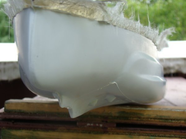

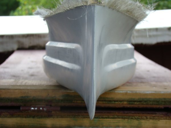

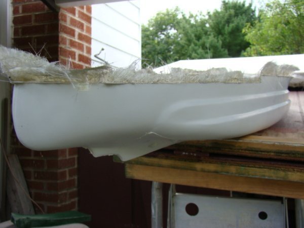

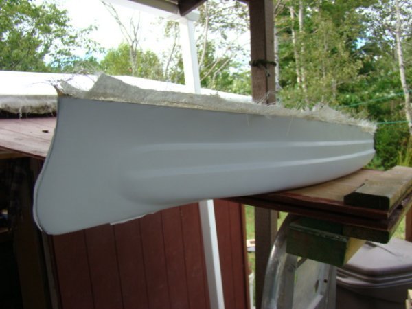

    Here are the pics from Ralph!
    Nice looking hull !! ( for an Allied ship)

  15. Bob Pottle
    Magnificent! Ralph's made 4 QE/Valiant hulls as of yesterday and is making a few more this week. I'm geting mine this weekend.
  16. froggyfrenchman
    That is one sweet looking hull.
