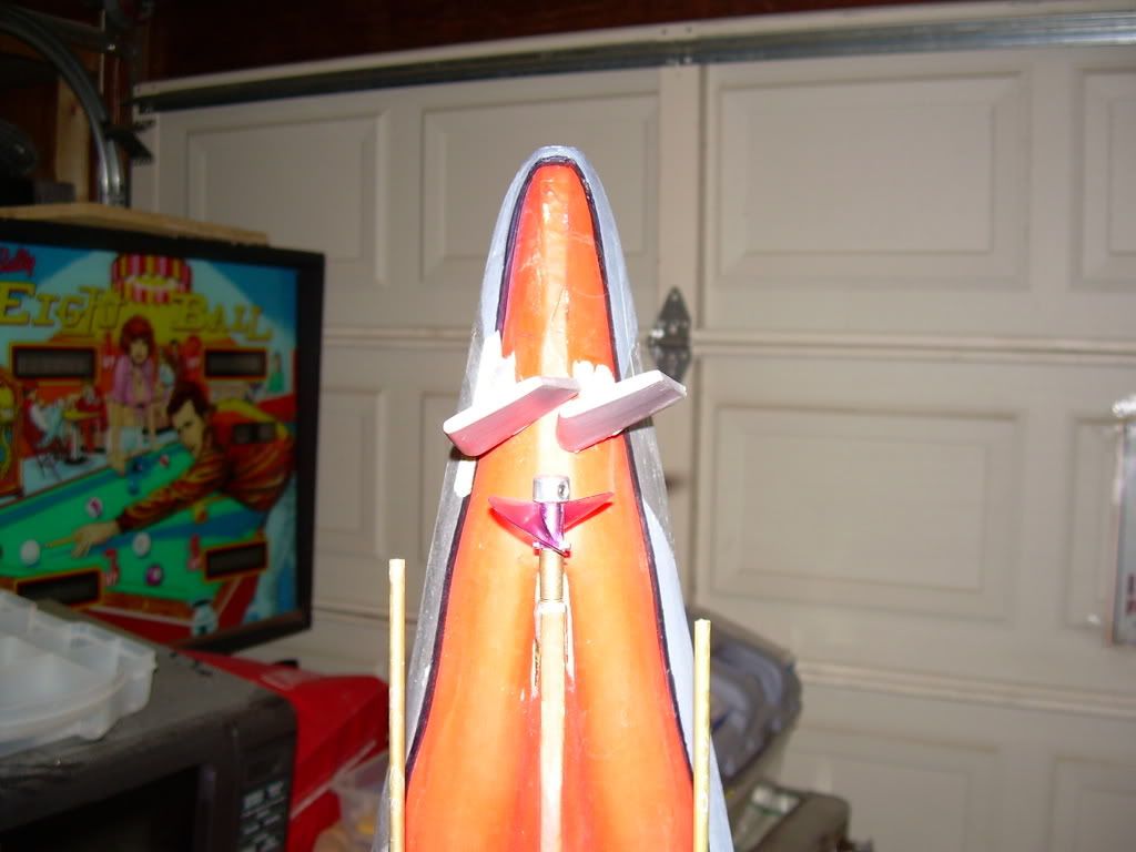

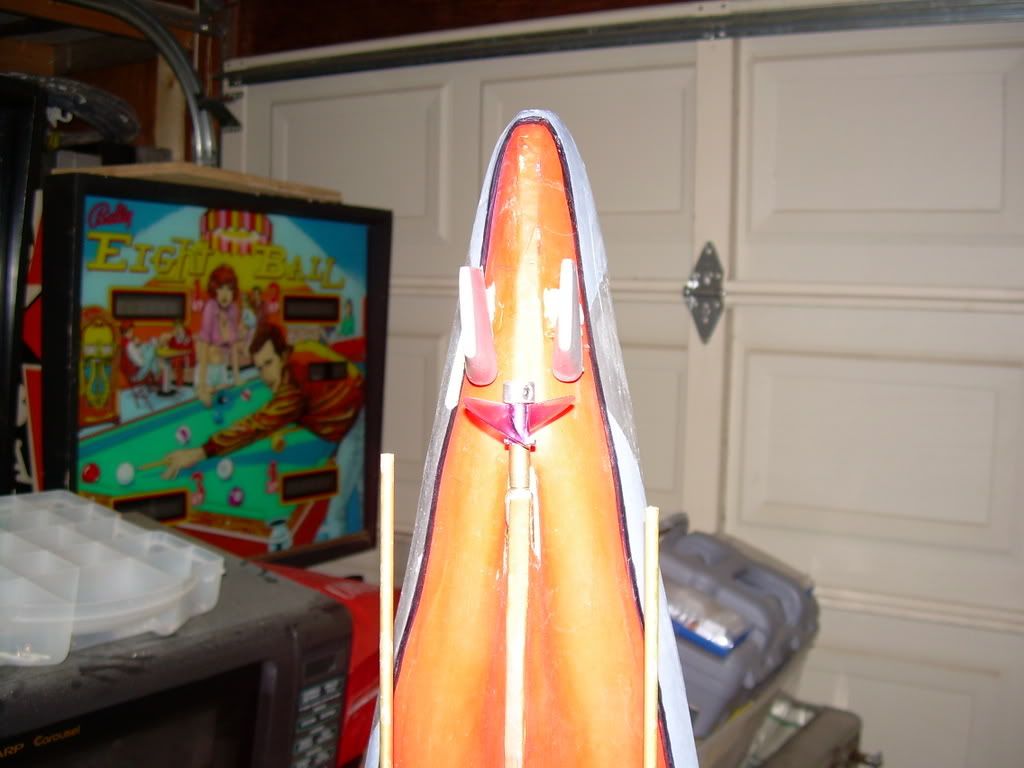

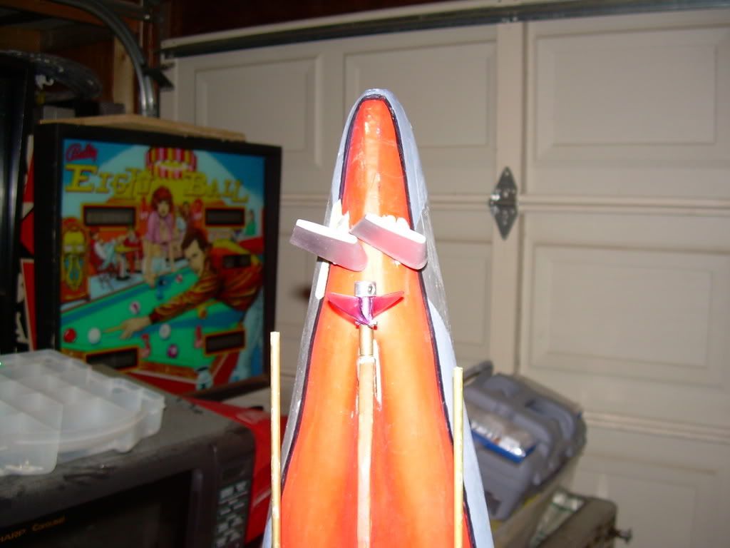

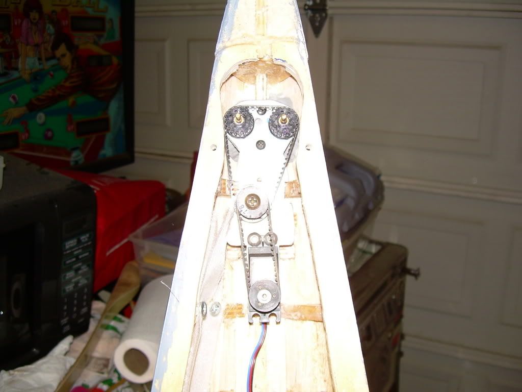

    I got the stern together. I used pullys and toothed belts like I seen some of you use and what I ended up with will turn circle's clock wise and then change direction and go counter clock wise inside my daughter's 15' pool without touching the side's. when going full ahead turning full R or L almost stop's the ship's forward motion. When against the side of the pool if I turn into the side and give full ahead the stern of the ship will move side ways away from the side of the pool with almost no forward motion. I've read monuverability is critical and I'm pleased with what I see. still the ship isnt at full load and I suspect I will lose at laest a little maybe a lote with more draft?

  5. specialist
    specialist Active Member
    Apr 23, 2007
    280
    May want to add an additional attachment point for the forward mounting screws on the servo.
    The torque of the belt may tend to pull the single attachment lose over time.

    Something else you might consider, I can't really see the inner workings, but why not move that rudder servo aft and replace that single "transmission" pulley? Or put it in backwards & get a slightly longer belt?

    On close inspection of the rudder drive assembly, it seems to me that the single "transmission" pulley is actually a tensioning device, and needed for that purpose. The only thing I may have done differently would have been to mount the servo upside-down, just for the sake of keeping the electronics out of the water a little longer. That, and perhaps a little sanding down of the rudders, that thick leading edge just dosen't look right. Still, a fine job.

    Sorry I meant I'll carry 1 20 oz. bottle in the boat and one ready to replace it. The rudder settup is really tight. I am going to add another mounting point. I can't turn the servoe upside down because it would be above the deck. The pinball machine's belong to my wife I'll ask.
