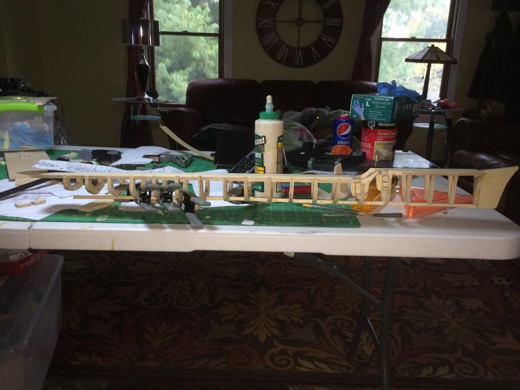

    since i can't wear a dust mask for now i decided to finish the non sanding parts of my shimakaze and have finished 80% of the basic hull - skin
    i might be able to put a single spurt gun in the bow with maybe a 15 round magazine in it just don't have all that much room up there.
    then i need to find a motor and twin drive system that will actually fit in the hull and move the ship fast enough to make time.
    but first i need to put some skin on it and see if it will even float.
    that one needs trimmed at the 3rd to last rib and the last one needs to be attached but that will happen once the rest dries.

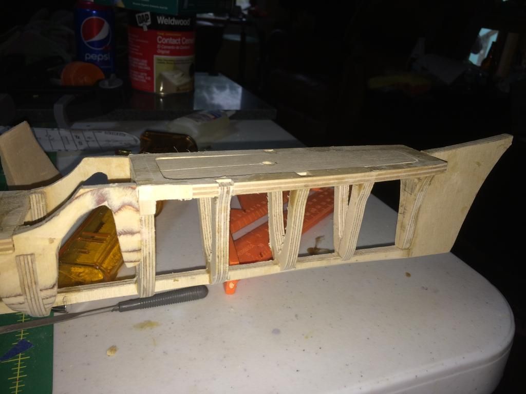

    well damn the bow thickness at the weather deck is 2.5 inches and just under it is 2.25 inches this extends for maybe another .25 inches for a total of maybe half an inch that is over the 2 inch max in the rules of ircwcc. so i would either need a waiver or to trim things strangely.
    What I'd do is to finish the bow hard area back to the rib, 'glass it and then go back with a dremel and cut out the 1/4" that needs to be removed from below the deck/caprail and the bottom hard area. Not hard at all.

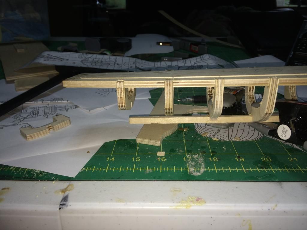

    bottom of the hull is attached and drying but will need to be trimmed up in places to meet the 85% rule and i may have to remove a couple ribs or at least sand them down some. cutting a water channel will also be interesting and may involve reinforcing areas right at the edge or the solid areas in the bottom.

    Cut out the bow of the ship to comply with 2 inch rules and glassed what was left. going to have to drill some holes in rib 1 for drainage for when that area gets shot-up as well as not to impede flow of water that will sink it.

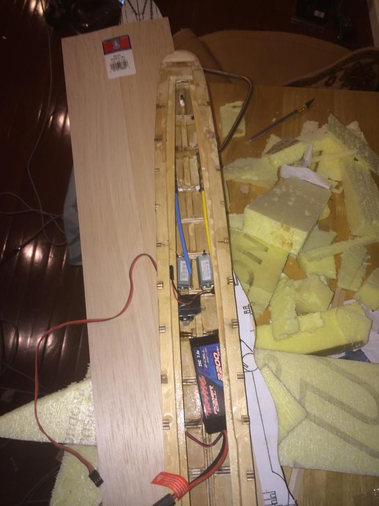

    cut the holes for stuffing tubes and removed every other rib from 5-19 as i was under 85% pen area should give me enough now was sitting at 79% before bow complies with 2 inch rule and has a section removed from the first rib for free flow.
    not managed to make much of a water channel and may have to bring height up with foam rather than grinding down the ribs. doing so would require inset to keep lower sections penetrable but not provide as large a resevoir for water as it will not take much to sink the ship.

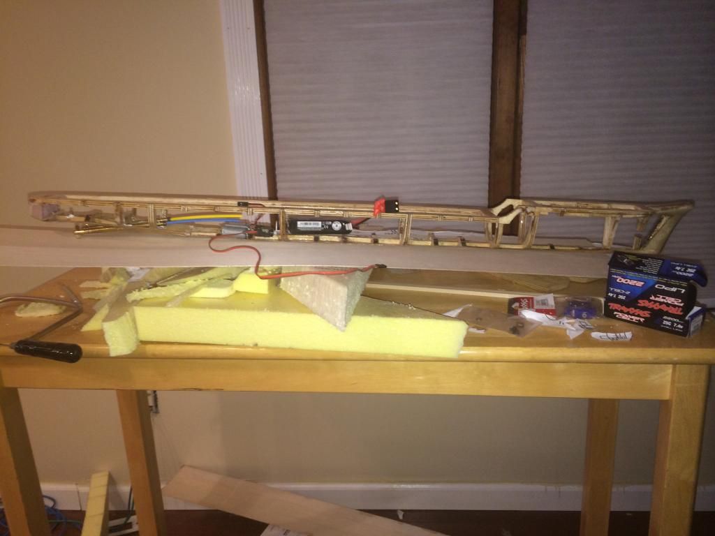

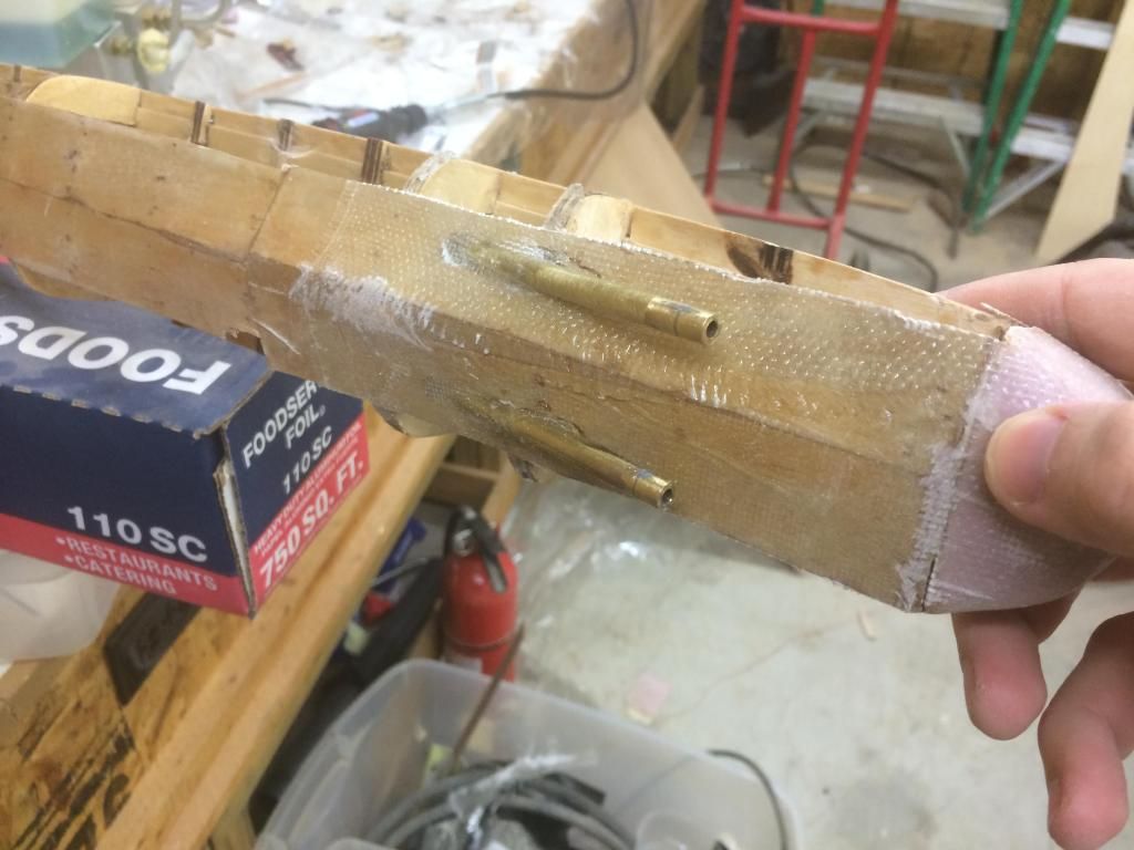

    while i wait for thanksgiving to be over so i can order parts i cut out 11 of 18 ribs and laid the stuffing tubes in and rudder. started to plan where everything will actually go and figured rudder servo mounting finally.
    and that is indeed 1/8" shinkwrap might put another sleeve over it if i find it shatters during runing
    space is at such a premium as well as weight. i wish that the 16oz cartridge adapter that strike used to have was still available but similar things that are somewhat wider are available. i may have to try them.

  17. Renodemona
    Palmer's Pursuit sells a setup called 'Rock the Boat.' It is much smaller than the Strike unit, but more expensive. I love mine.
  18. Kotori87
    Rock the Boat is a good regulator for destroyers. I don't think you should use a flexible shaft as long as you're showing. It could very easily start vibrating and lose a lot of energy. If you really need the flex over that distance, do a two-part coupling. Have a short length of flexible hose (I use R/C airplane fuel tubing) to a brass rod, run the brass rod almost to the motor, and have a second flexible hose to join the rod to the motor.
    Tugboat likes this.
  19. Tugboat
    Yeah, when I used a flexible tube, it was like an inch long, counting the 3/8" of it on each shaft. Short as possible is good. Long ones tend to get their knickers in a twist if ya know what I mean...

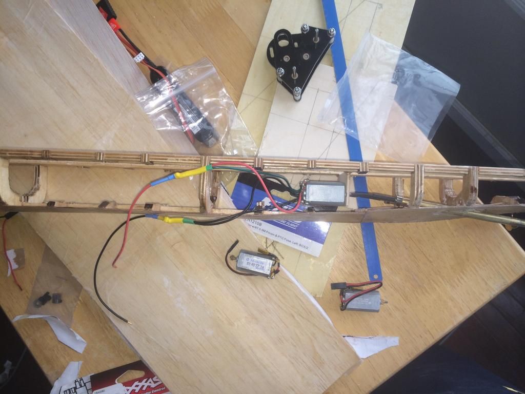

    soldered the motors together to spin inwards. and made a mounting bracket for them. not terribly happy with the way they mount but not unhappy now. going to have to cut a grove in the middle of the motor bracket for the rudder arm. or i might try moving the servo behind it again.
    need to order a esc for the brushed motors and the rock the boat regulator (thanks for that recommendation)
