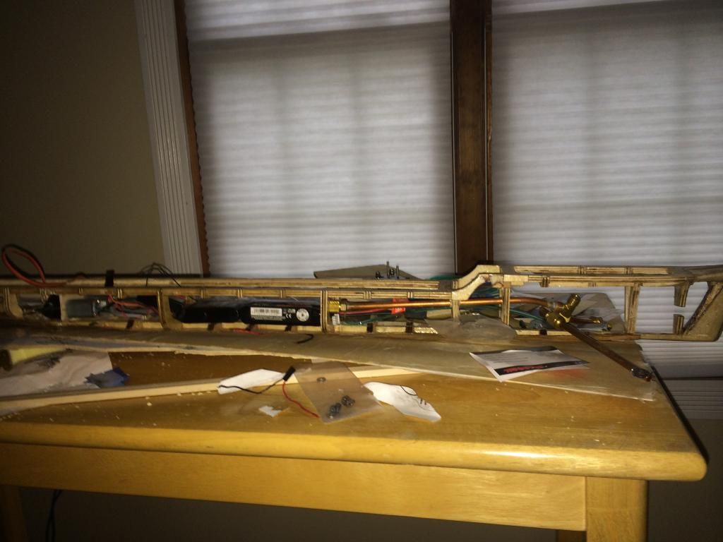

    parts from BC arrived today and i ordered a single cannon kit so that way i can figure out how it's actually put together before doing so myself.
    dang tight fit and the way i built the boat i can only get the gun in the forward turret not the aft.
    regulator is either going to have to go directly under the gun itself or behind the props in front of the rudder. i really need to get an esc that can do power out as well to power my receiver. i plan to use my 72mhz radio i have for control just need to figure out if that will work or not... and i need to get some 2 liters of soda for internal armor or i will have a really bad day. i really need to wrap the hull in plastic sheeting and see how much weight can go in it but i'm just about to where i can sheet it as well. then i need to start the superstructure... which will be to heavy.
    and i have zero clue if i could put a pump in it if that is even allowed.

    A pump is allowed. Shimakaze is a 1.5 unit destroyer. So half-unit pump and 1 unit gun. You can cut the uptube on the BC gun to fit the height of your deck aft, if that'll make it fit. That's why they come with that part unassembled. Of course, Shima might be too low in back deck to even fit a cut down gun. A pic of the gun next to the stern turret area would help :) A brushless car ESC would have a BEC, and many brushed car ESCs do, too. What size battery are you looking at running?
    Weight-wise, look at her scale weight and max weight. Try to build to scale weight, and think 'light, light, light'.

    yea the stern is just to short. the firing piece itself is dead level with the top of the deck. the battery is a traxxas 2200 or the one with the bar code on it in the picture. the other is the receiver battery that i have but need to replace as it sat uncharged for about 4 years.

    put blue tape on it and it floats beautifully about 1/4 of inch in the water and dead level with no internals and top deck off so i could see if the prop shafts leaked (they did) guessing i have about 3 pounds to work with based on pressure required to sink to depth.
    regulator arrived so i stuffed everything in the hull - bb and a co2 cartridge and it is certainly tight. but i am sitting about 1/2" high in the water and if i counterbalance the reg with the battery it sits level.
    not attaching anything permanently until i get another pair of eyes on it sunday.
