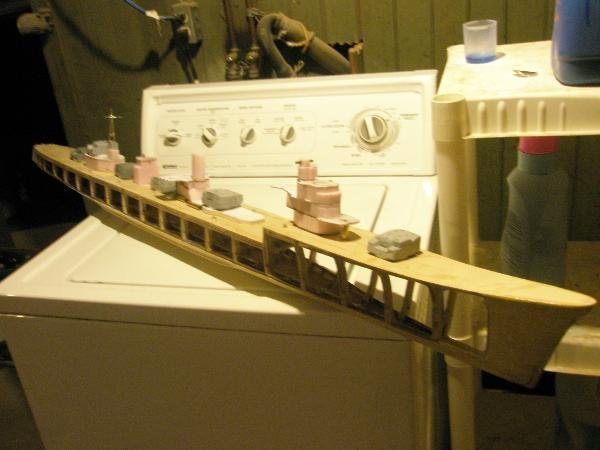

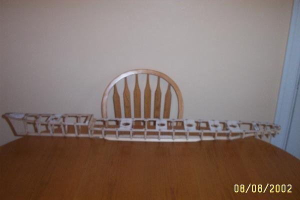

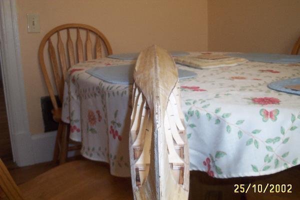

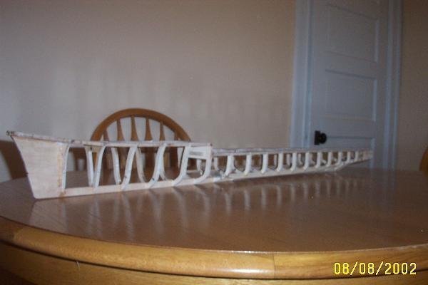

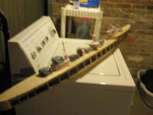

    Uploading som pics of the nearly compleated framework, still need to cut out the rest of the sub deck fit the bilge keels, but for the most part the cutting is done. Some thoughts on how I'll set it up. Propulsion-1 motor with a gear box turning 2 counter rotating shafts to cut down on weight along with a Mtronics esc. 1 rudder and the smallest low-profile servo I can get away with. Power source, whatever will fit after everything else is in and will give me the greatest powere to weight ratio. The 5" gun turrets will be armed but will be fiexed (no rotation or depression at this time), and will be a standard home brew piston type gun. Will most likely use clippard valves to fire them to save on wieght. The torp problem... how to make them all fit?? well I'll be doing more research but for now the lightest thing I can come up with is to arm the center TT bank with a single barrle Arizona type cannon with rotation and load it up for 15 shots. The other 2 TT banks would be decrative only. with all that being said, what size CO2 botle will be needed to fire all the guns without running out of gas before all the ammo is spent? and what are the dimentions of those 3.5oz bottles?
  9. Mark
    Mark Active Member
    457
    Swansea, MA
    pics are in the filemanager under my name in subfolder Shimakaze. BTW, Carl hows you boat comming along, any tid bits of info on the weight issues? I'll be sending Art (down in NZ) an e-mail tonight to see if he finished his and how he was able to set it up.
  10. Mark
    Mark Active Member
    457
    Swansea, MA
    added some more photos of the compleated frame, I built in the bilge keels to give extra support to the frame for the batteries and wepon system

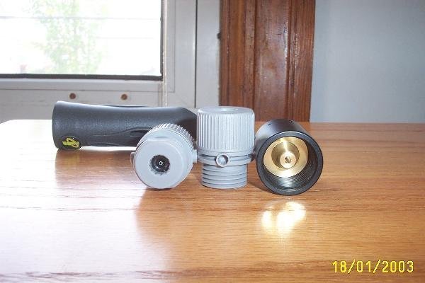

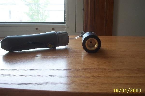

    To keep the weight down I'm only arming one set of guns and one or two of the torp launchers. I'm drawing up plans for a home-brew TT launcher made out of machined PVC, but haven't fully worked it out yet. The torpedoes will be plastic, too.
    Also, I was planning on using Li-poly batteries to keep the weight down, as well as a Palmer Pursuit regulator. However, I may give up on my 3.5oz CO2 bottle and go with a 25g cartridge instead, again to save weight.

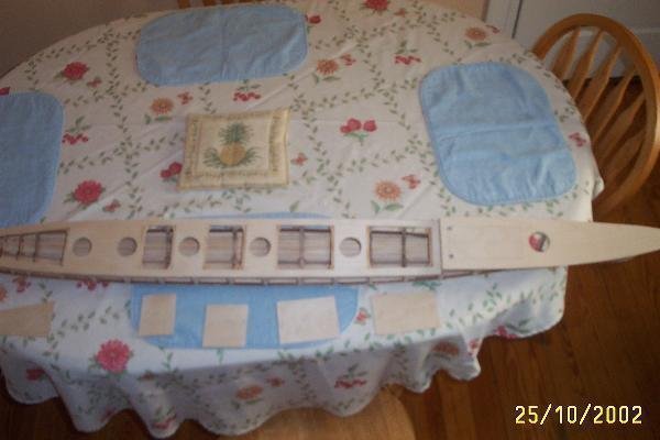

  15. Mark
    Mark Active Member
    457
    Swansea, MA
    frames, keel, and sub-deck
    bow shot
    side veiws
    stern shot
    Oooooooo.... aaaaahhhhh.....
    Very very nice job on that, Mark!

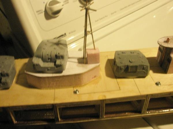

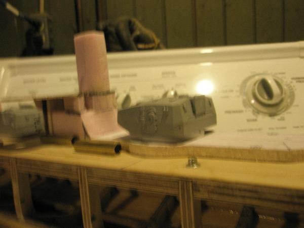

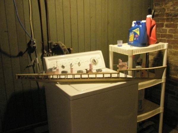

    some more up-to-date photos
  18. Mark
    Mark Active Member
    457
    Swansea, MA

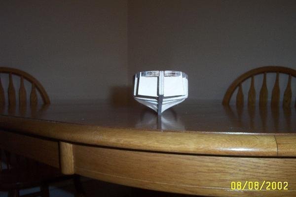

    hull is now sealed with WS epoxy all over and is glassed with2oz cloth on the bottom. Carl we should put our heads together to come up with a way of fully arming these babies, I'm ordering a light wieght composit reg soon and have some mold being made up for the gun turrets and TT launchers (let me know if you're interested and we'll work something out)
  19. Mark
    Mark Active Member
    457
    Swansea, MA
    some more progress made, will be ordering all running gear, speedcontrol, motors, light wieght reg tomorrow
    [​IMG][​IMG][​IMG][​IMG]
    (sorry about the size, used a different camera) the SS is about 90% done and the ship wieghs in at about 2#s
