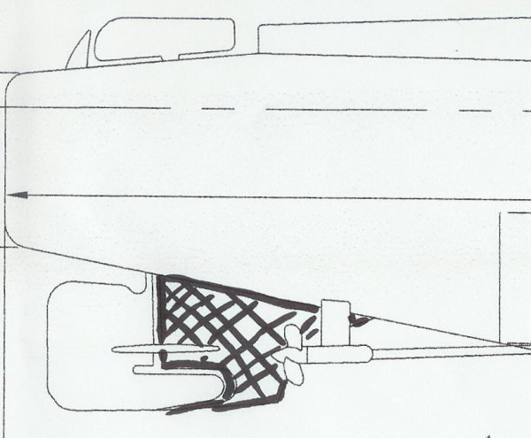

  3. Jay Jennings
    Hi Mark,
    The plans we used in Nova Scotia to build the hulls for I-400 show them with one rudder.
    Just thought you would like to know.
    (I can't post on the Treaty site)
  4. rcengr
    From the line drawings I have, I cannot tell for certain if there is a second rudder. Many of the Japanese subs (see I182 below for instance) had rudders on the top of the fuselage that would only be in the water when the sub submerged. My drawings of the I-400 show what looks to be this top rudder, but again I cannot be sure. If anyone knows for certain, please let me know. Mark
  5. Jay Jennings
    OK, if the top counts as a second rudder, (never thought about that), then I-400 has two. I will try to scan the arse end and post it.
  6. Jay Jennings
    Here is the arse of the plans we used, I darkened the skeg in a bit.
    The drawing shows the STBD prop on the outside of the skeg which leads to a single rudder on the bottom. A top view of the boat doesn't show any rudder which means it is dirrectly under the hull.
    One rudder above and one below, the boat should turn pretty good.
    We wil let you know ;)
    Do you know why you are not able to post on the treaty site?
    Is it a problem with yahoo?
