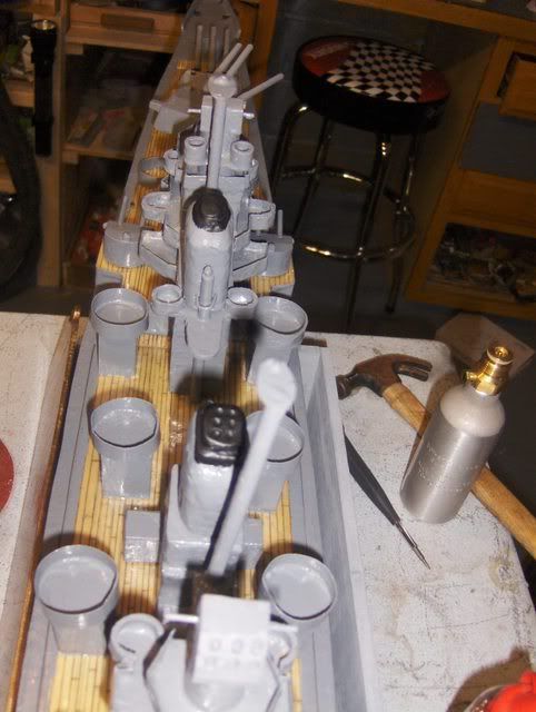

    Okay now that I have watched all my hard work slowly and gracefully sink below the sea in 5 ft of water [:0] and wondering where the #$@% is my float and than rushing to paddle out to it before the bubbles stop I have to say it is kind of majestic looking down thru the water at your ship and watching a fish swim by and check out your handy work [;)].so with that said I have decided I need to do some research and develop what will work best for my ship I have some ideas but as always I like to hear yours first for better or for worst lets have them.
    Thanks again guys

  5. Powder Monkey
    Well the pond didn’t cooperate with the joke sorry but any who I built in my floats the two smoke stakes are break away and below them are all open to store rope my trouble is the string and its storage I’m going to change too the cloth typ fishing line and a bob on a post below deck straight shot up and it will be neatly wound onto the bob maybe that will work I might try to incorporate on of those with earth magnets to help on those roll sinks I like redundancy that why I have two but if some one has a better idea I could always change [^]
    Thanks guys
