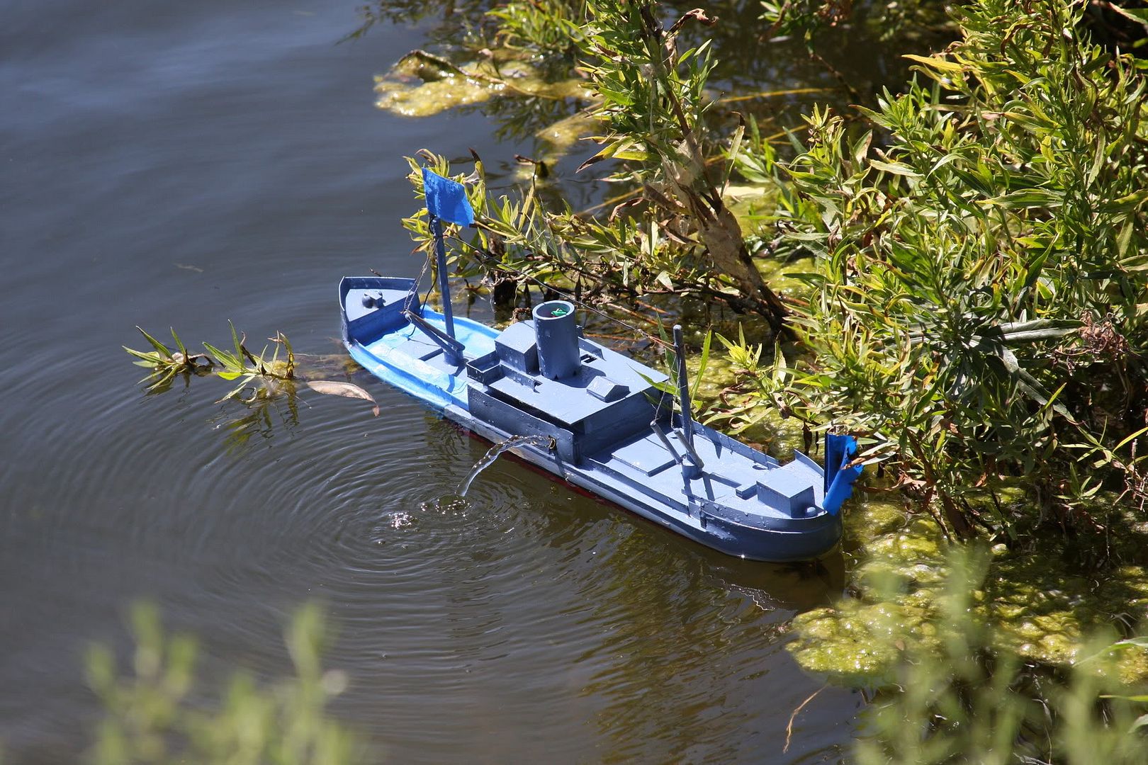

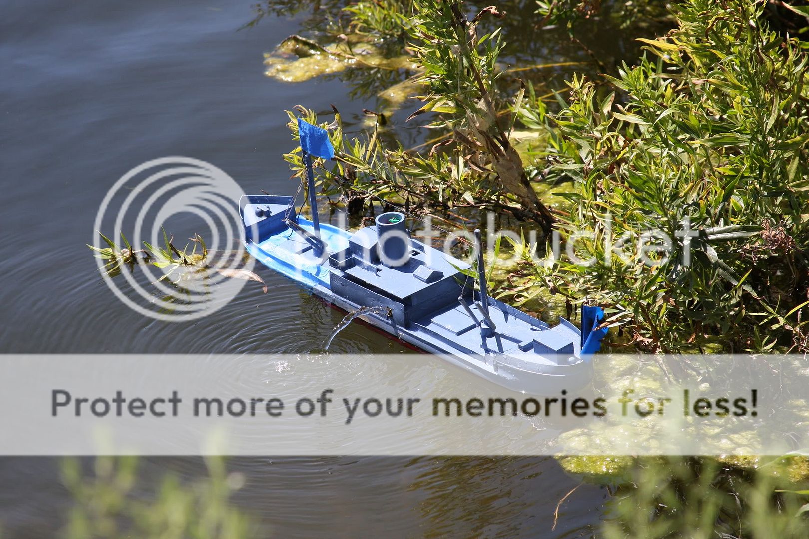

    All right, I'll lead this thread off then. Here is my most recent float design, used with much success in the 2008 season in my four transports. All four ships got sunk on numerous occasions, and the float deployed with a very high degree of reliability. There were only two failures, and I know exactly why they failed and how to prevent it in the future.
    The float is a modified "hidden compartment" style float, with several changes to improve reliability of deploying. The system consists of a fishing bobber concealed inside a modified PVC coupler, which serves double duty as the ship's smoke stack. The modification applied to the PVC coupler is a number of vent holes cut in the bottom, to allow water to flood in through the bottom of the smokestack and lift the bobber up and out of the ship as it goes down. If all goes well, the bobber stays on the surface the entire time. The vent holes modification was introduced after I observed that, when a ship sinks, water can flood in through the tops of smokestacks, trapping your recovery float until after the ship hits the bottom of the pond. By that point, it's too late and any number of obstructions may prevent the float from reaching the surface. By cutting vent holes in the bottom of the smokestack, I allow water to lift the float up and out of the smokestack, rather than trapping it inside. Unless the ship is rolled 180 degrees by a ram (actually happened once, first known failure), the float will deploy immediately with a high degree of reliability. The following series of photos show the float in action, and also demonstrates the second time this float system has ever failed to deploy:

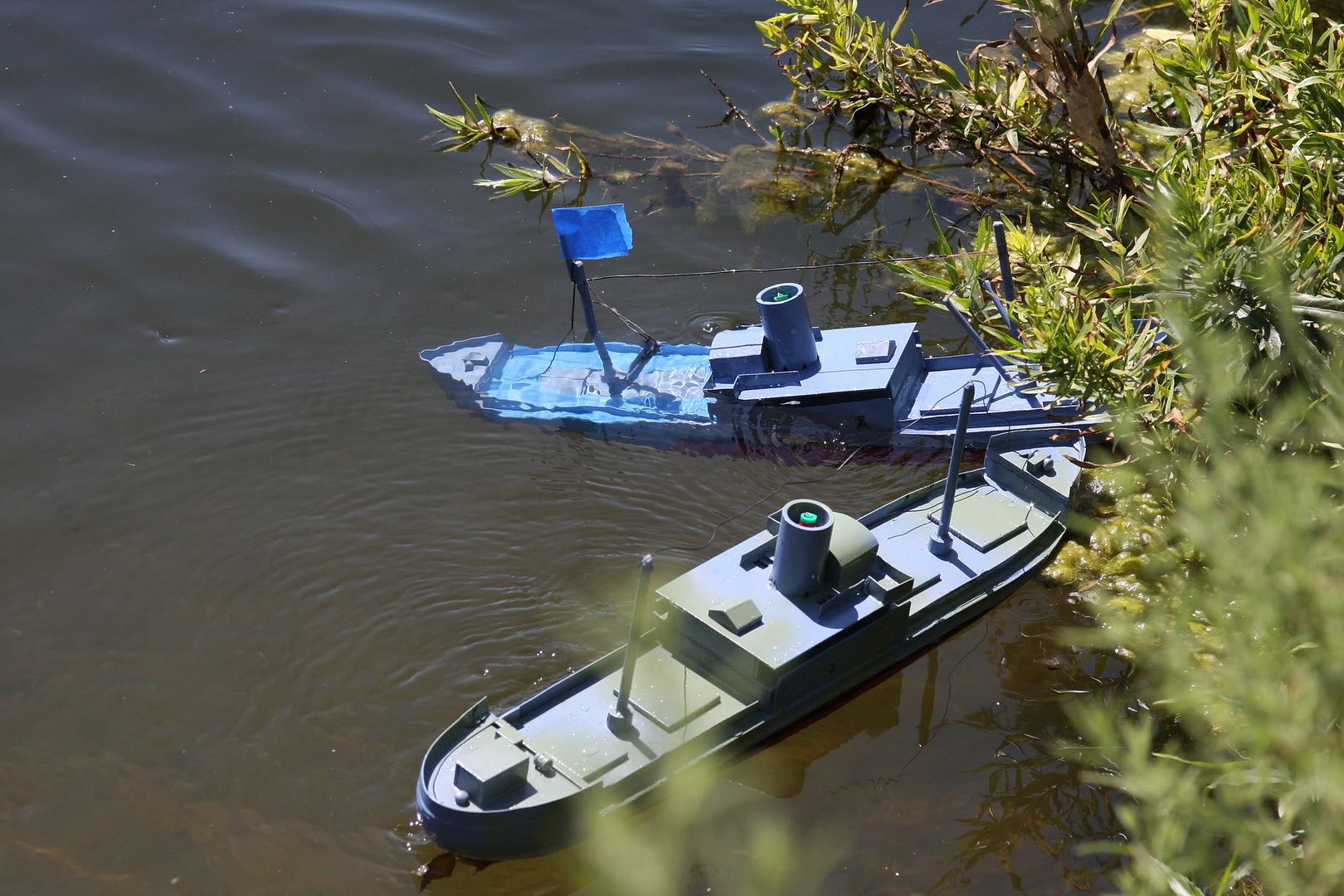

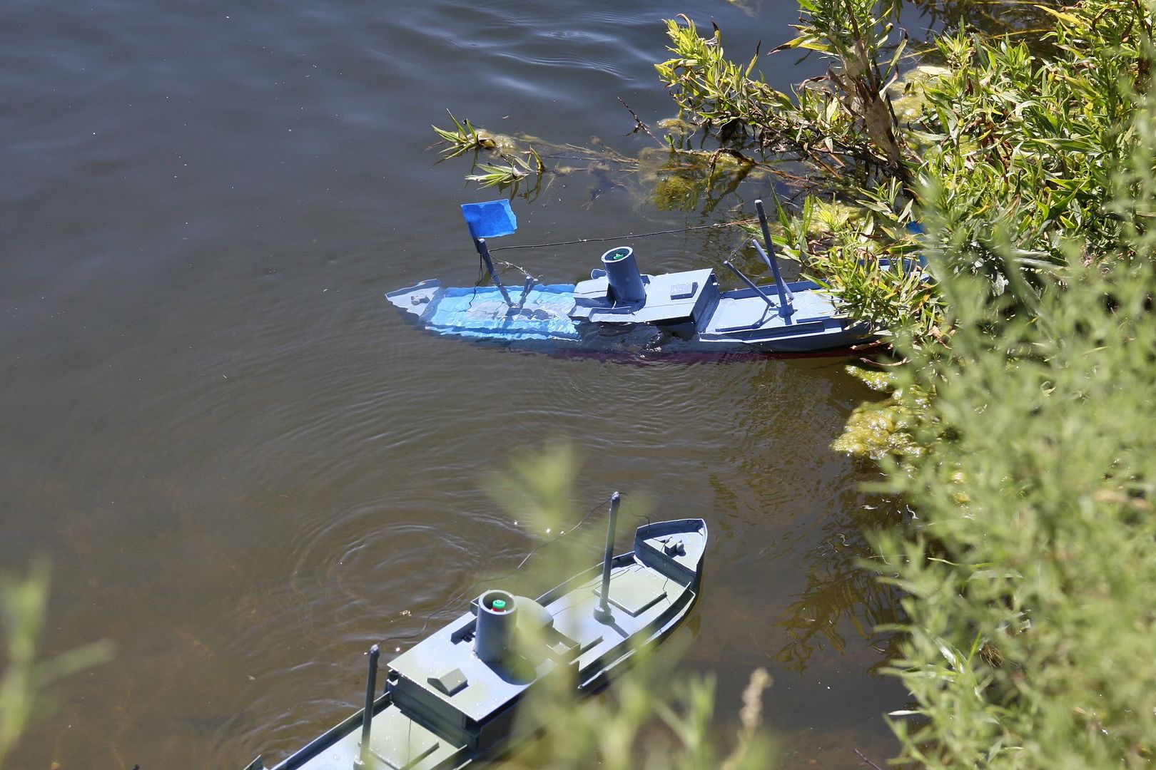

    SS Henry Kaiser, mossed, torpedoed, and pumping, waits for assistance near the Allied Convoy Buoy
    SS Ou Maru fatally rams the Henry Kaiser, finishing it off

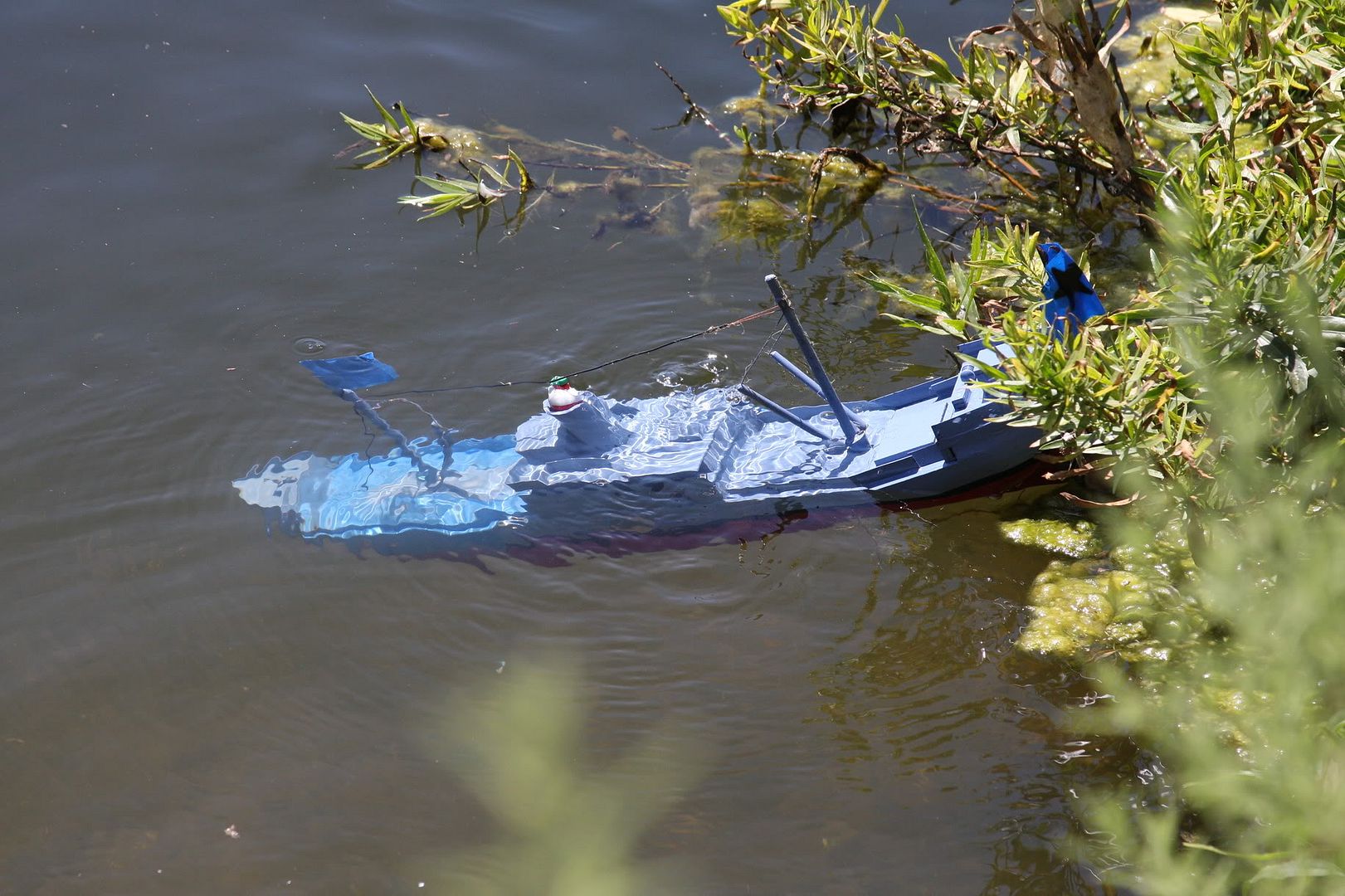

    The last moment before the float system's vent holes kick into action

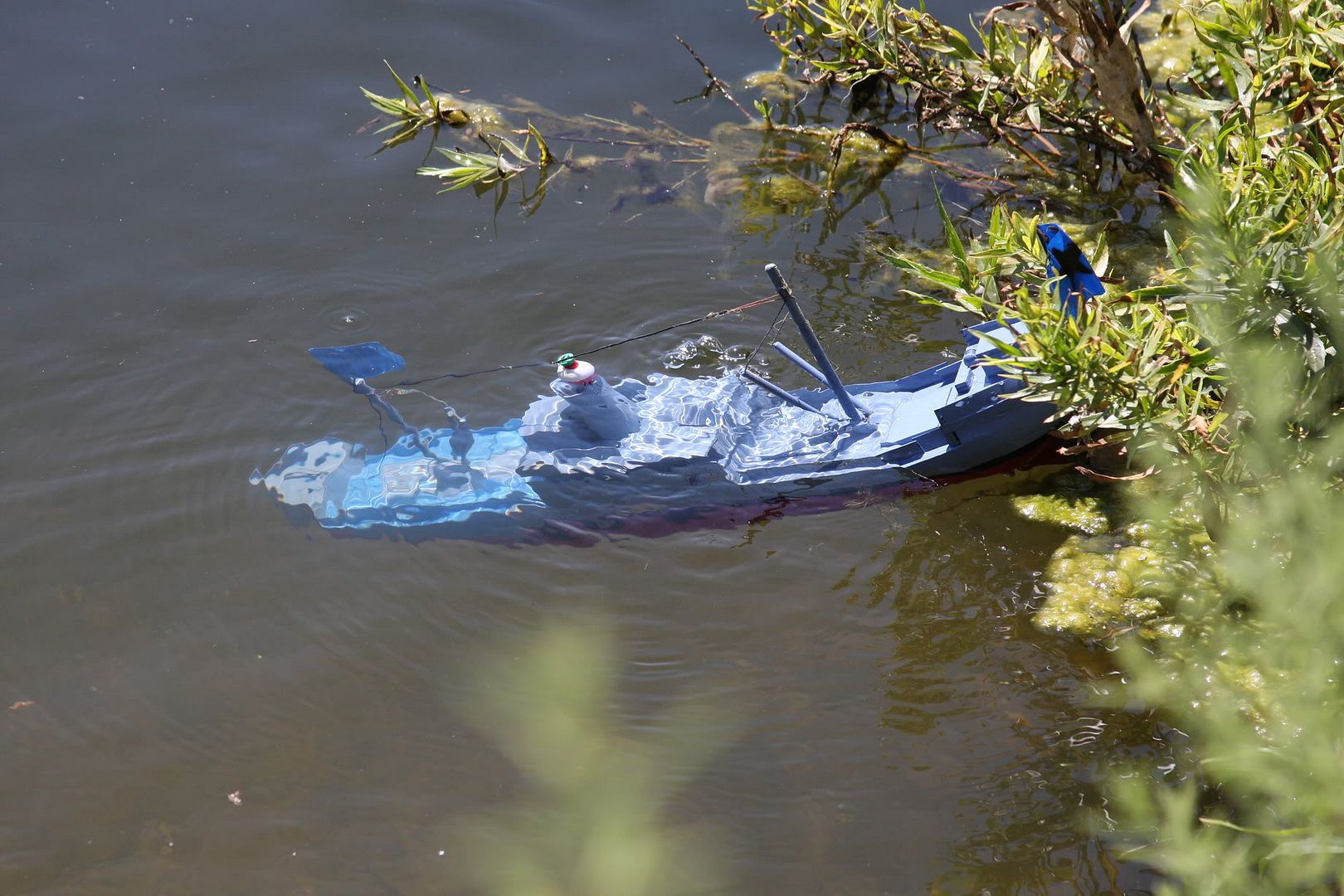

    The vent holes did their job perfectly, as water lifts the float up and out of the smokestack
    Alas, the radio antenna strung between the two masts catches the float before it can finish deploying, trapping it in the mast

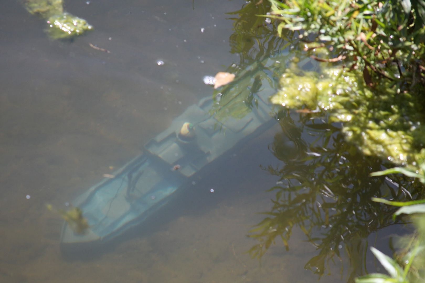

    Henry Kaiser, float still trapped, rests on the bottom
    As you saw in the photos, the float failed to deploy because it got trapped by the antenna wire. Since then, the antenna wire has been loosened and repositioned, and the float has never failed since.

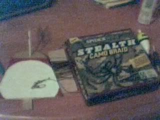

    This is the bottom of the superstructure. My float clips to the inside of the boat and lowers the boat to the pond bottom. It doesn't get tangled and has worked flawlessly on all three of the ships I have them installed on. I also can retrieve them with this.

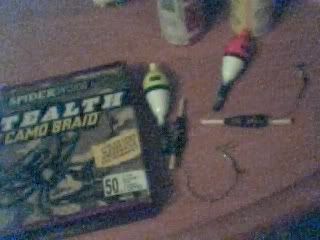

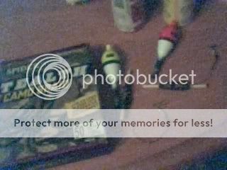

    Bismark normally (read now) will always be going out with 2 floats on board and there will be a 3rd back up later also.
    1. A Piece of deck that is a hatch for the rudder servo floats off
    so it has had a 50lb test fishing line attached to it and it is attached
    around the prop shaft in the bottom of the hull. Snap swivel on end
    of line to make putting in and out easier for maitenance.
    2. A standard Float with a dowel with wound fishing line on it, these can be attached
    inside the hull if you have float off super structure or placed in a funnel or just layed on
    the ships surface or disguized as a range-finder or something similar. 50lbs test
    fishing line and snap swivel on end of line, and float tied and glued to the line.
    3. That superstructure that floats off, tie a line to it also and it is used as a back up for
    any of the other floats on your ship, it does not hurt to have more than one, I had just removed
    my float system before my Bismark sank, what would have been a 15 minute recovery if there
    was a float on her turned out to be almost a week of worry etc about a ship stuck in the mud
    under 14 feet of murky water in a stinky, cold, pond.
    Use a float - Save a Boat:D
