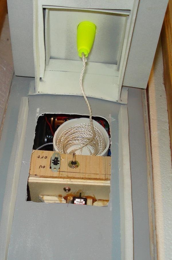

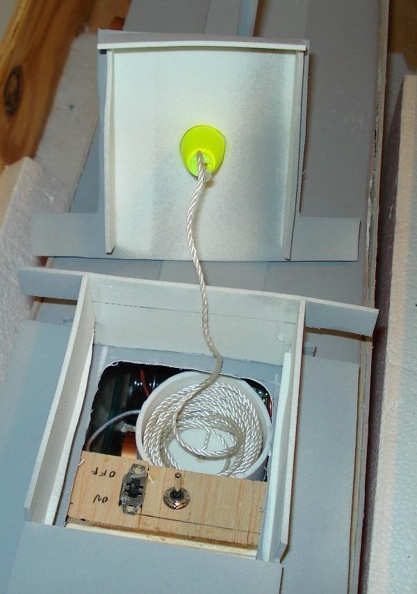

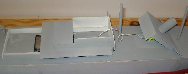

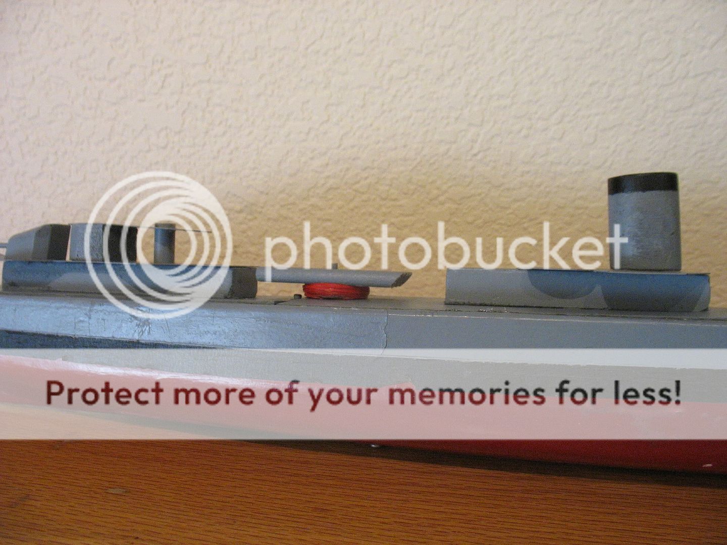

    [​IMG]Finally got a round to taking some photos of my float system:
  7. Knight4hire
    Knight4hire Active Member
    Mar 3, 2008
    963
  8. Knight4hire
    Mar 3, 2008
    963

  11. Knight4hire
    Mar 3, 2008
    963
    There is just over ten feet of line in that cup.
    As I fed it in, it naturally coiled.
    When it is time to deploy, the line will come out tangle free every time.

  13. CURT
    No problem. It gave me a close look.

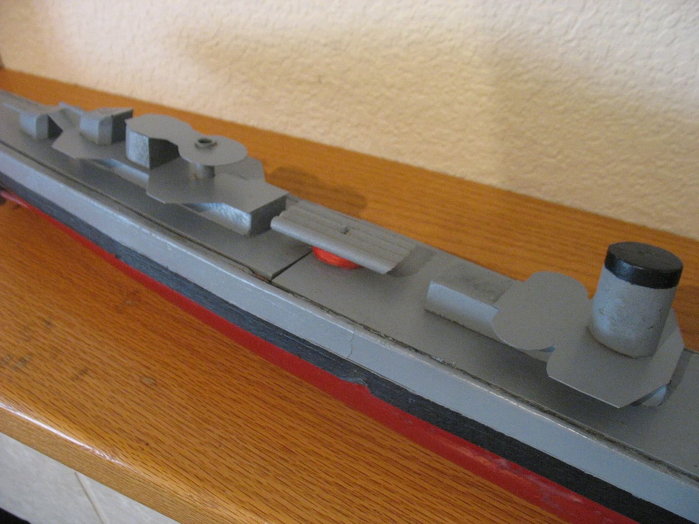

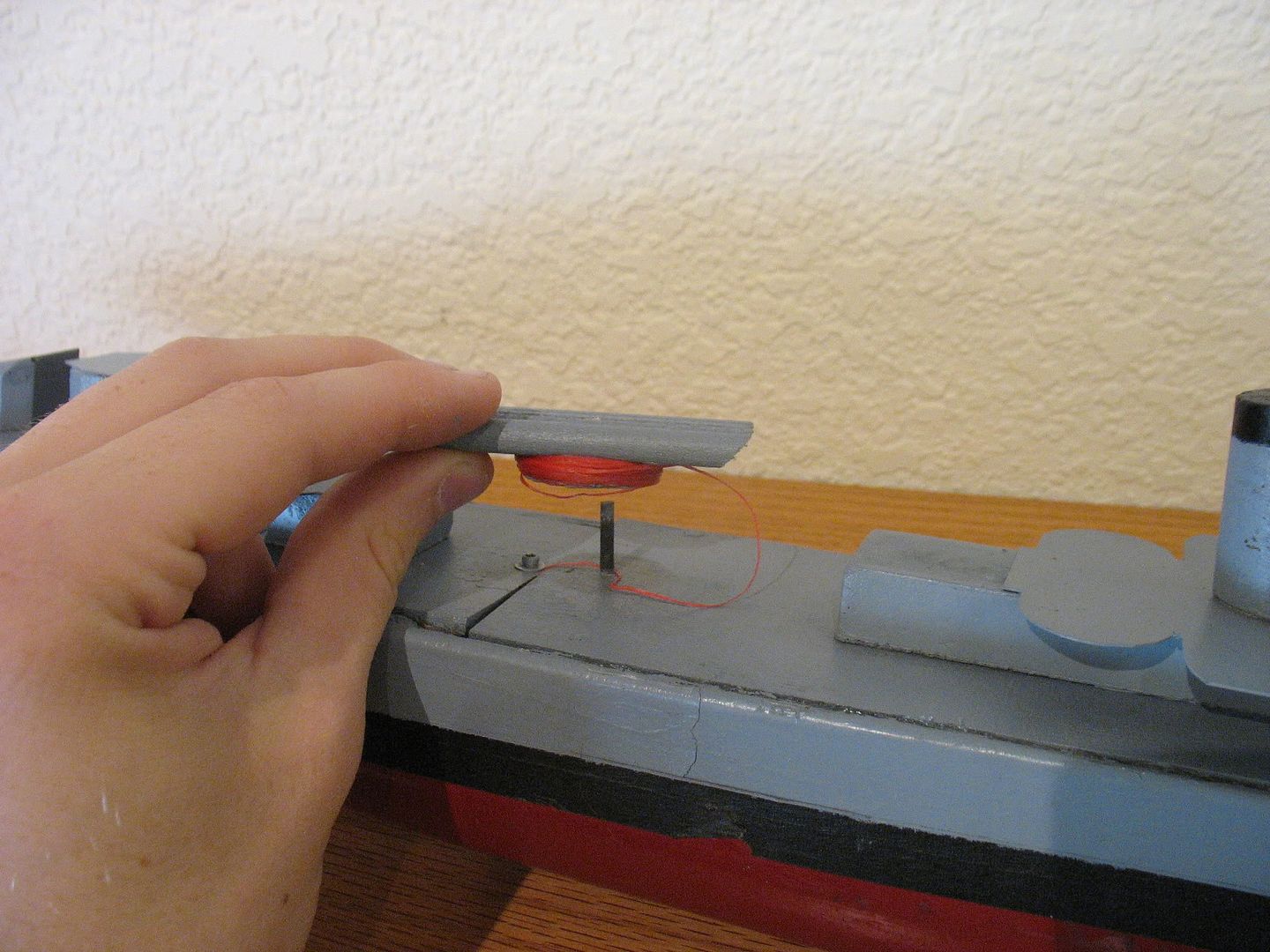

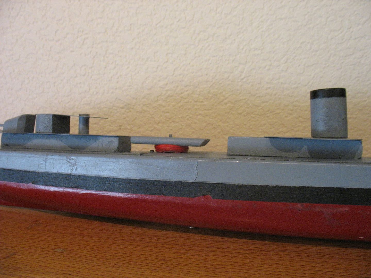

    I've got a new float to show off. It's the aft torpedo mount on destroyer Z-25, "Der Zee-Monster". I built it using 1" wood dowel and 1/4" wood dowel for the float itself, then mounted it to the deck with a short length of .110 carbon fiber through a 3/32" hole drilled in the float. It proved very reliable in the last battle, deploying within seconds both times I sank. It also stayed on deck until I sank, despite the storm of ball bearings around it. The nicest part about this float, though, is how easy it is to re-wind the float string afterwards. Since the string is simply coiled around the base of the torpedo mount, I simply spin the torpedo mount and the string winds itself up. Once wound, I still have just enough slack that I can pose the torpedo launcher at any angle I want.

    Smart move on the torpedo mount, I like the ease of just spinning it to coil the line. When I first got my Kumano years ago it had the forward turret (balsa) as the float with line attached. We weren't sure how well that worked (in case it tipped over) so we nixed that and drilled a hole in the smoke stack and shoved a bobber down it. So far, the Kumano has never sunk (then again I never got around to battling it)... but I do know it's a pain in the rear to stick that line back down it. I wish I had kept the turret as the float!

  20. Kotori87
    It was originally attached to the deck. I have since drilled a small hole through the deck (underneath the torpedo mount) and tied it into a structural brace. I will probably change out the line, the dental floss I am currently using is both weak and occasionally sticks. I actually had it fail once recently because the wax-coated dental floss stuck to itself.
