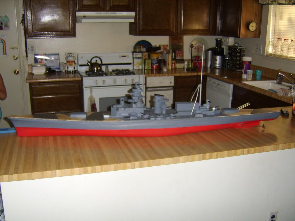

    I have sratch built a sharnhorst class hull and it mesures 65 3/8" x 8 3/8" Is this close enough? I didn't account for the skin on top of the ribs. I just glued the patterns I bought on the plywood and cut them out. It's my fist ship so I'm lerning as I go.

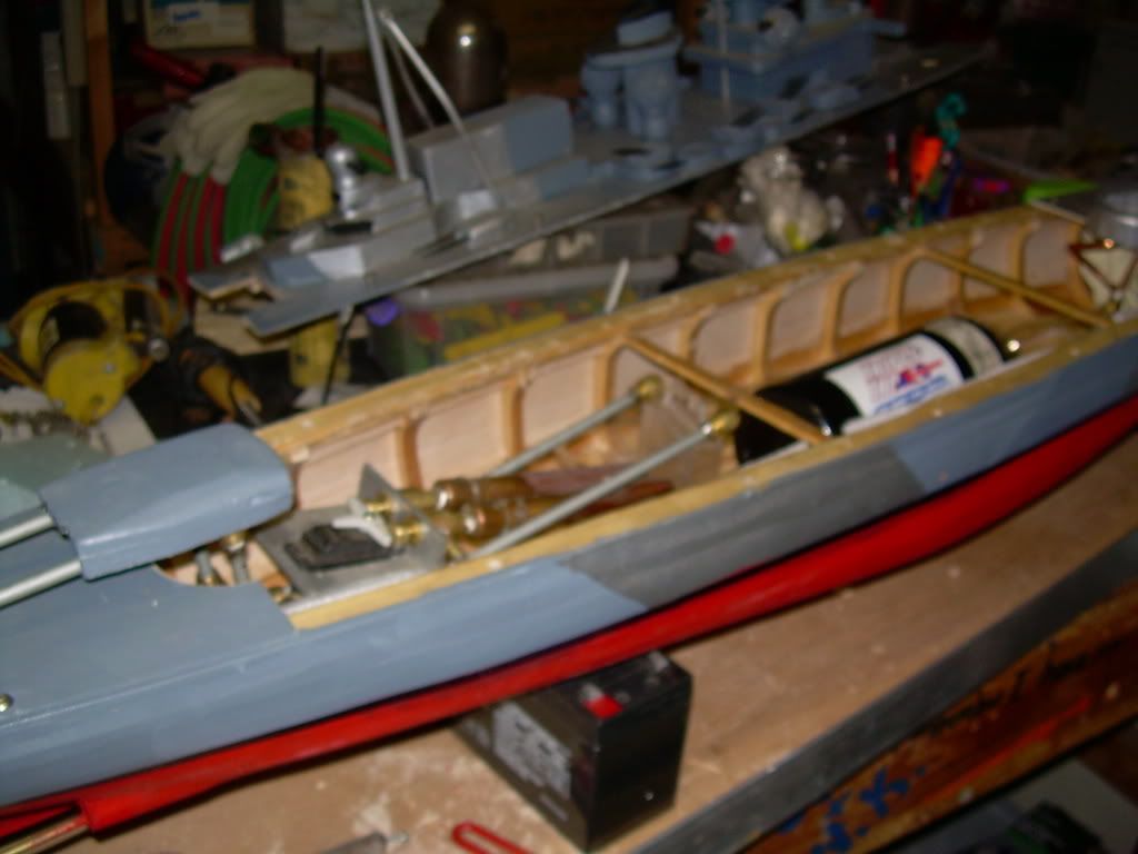

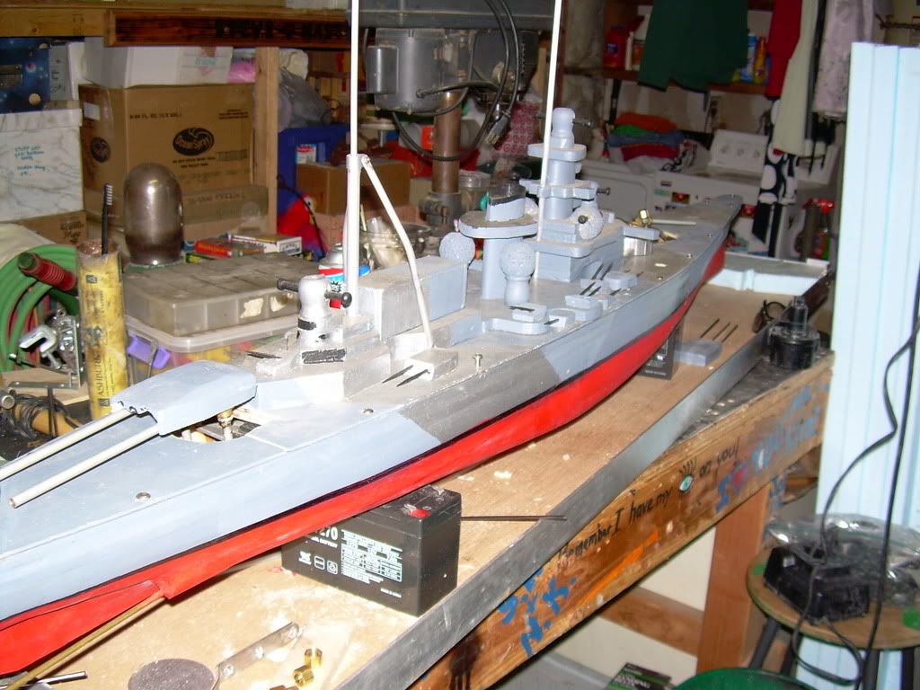

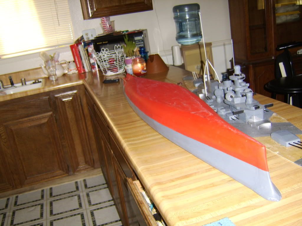

    Are you sujesting that I might not be perfect right from the start?LOL. Ya I plan to get lot's of advice and just spend the first year working it out. here's my album link.[​IMG]
  8. SRK Marine
    SRK Marine New Member
    Apr 12, 2007
    26
    Very nice work, Steve!! What size battery are you using, and where's it going? I saw the size of the CO2 bottle and wondered :) I'm running a 9 oz bottle, and that's really more than I need.

    Yea it's 20 oz.CO2! I'm going to use seperate packs for radio,drive motors. nimh 3000 ma cells soilerd together with battery bar's for custom fit in the hull. I have so many high quality pack's from my other hobby's I can run 2 together for drive motor's to get amp/hr capacity What do you think about waterproofing them?
